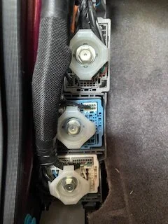

1. General condition of connectors some minor blue deposit which was removed by contact cleaner

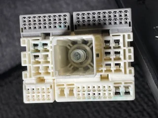

2. Passenger side A Panel connectors - all look pretty much as new.

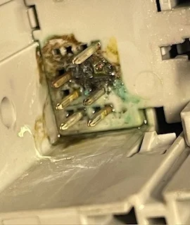

However the top connector was faulty as shown in 3.
3. Close up of affected pins on top harness socket - this is the bottom LHS of socket. Note one pin is missing (!)
These corroded pins may explain why the entry system is not working?
