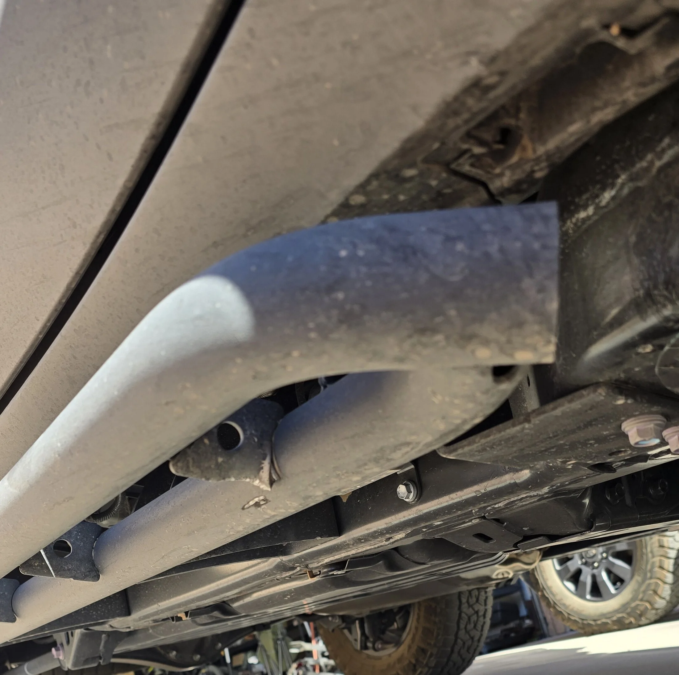

Rock rails took a hit. I noticed the brackets are only welded on the back side. This will become a rust point.

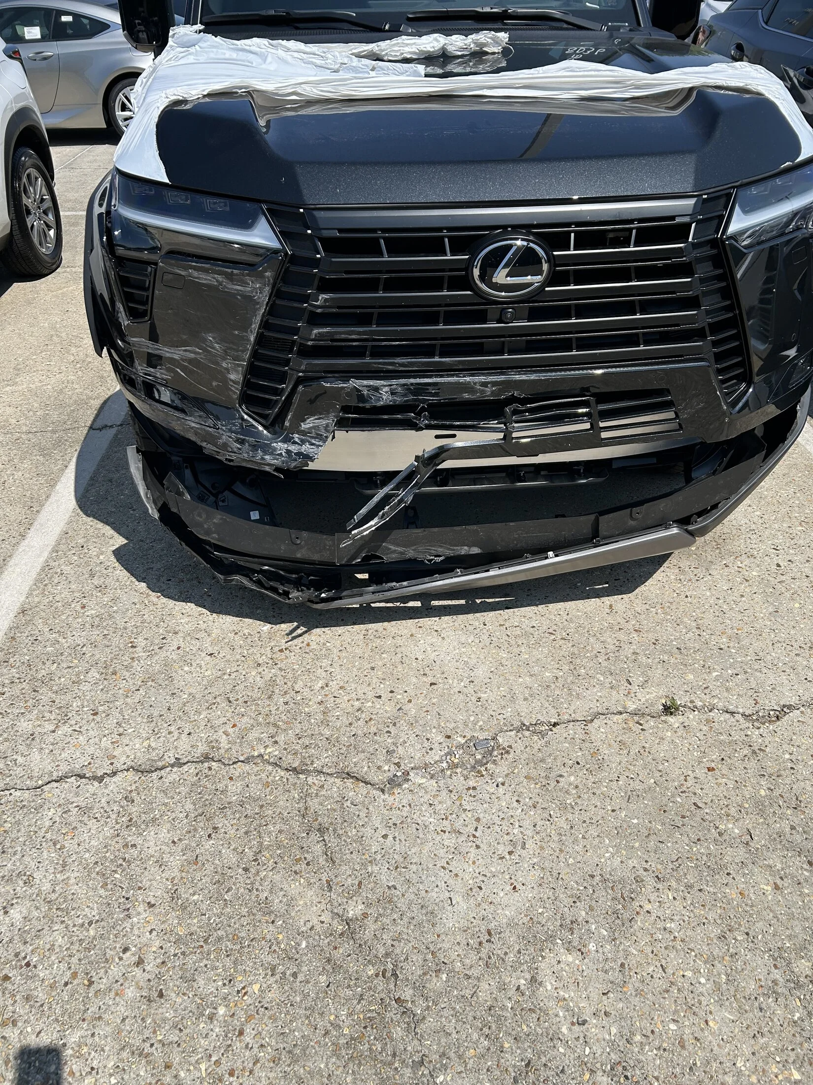

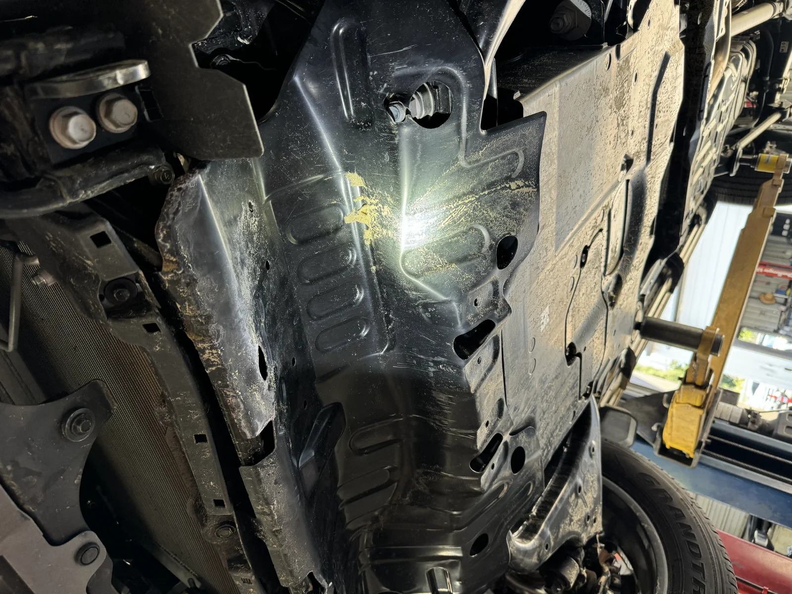

@jayp2 Both LC250's had damaged radiators with fluid leaking out. The radiator support is C-channel. I'm sure somebody will come up with an aftermarket solution with skids that tie into something more substantial.
