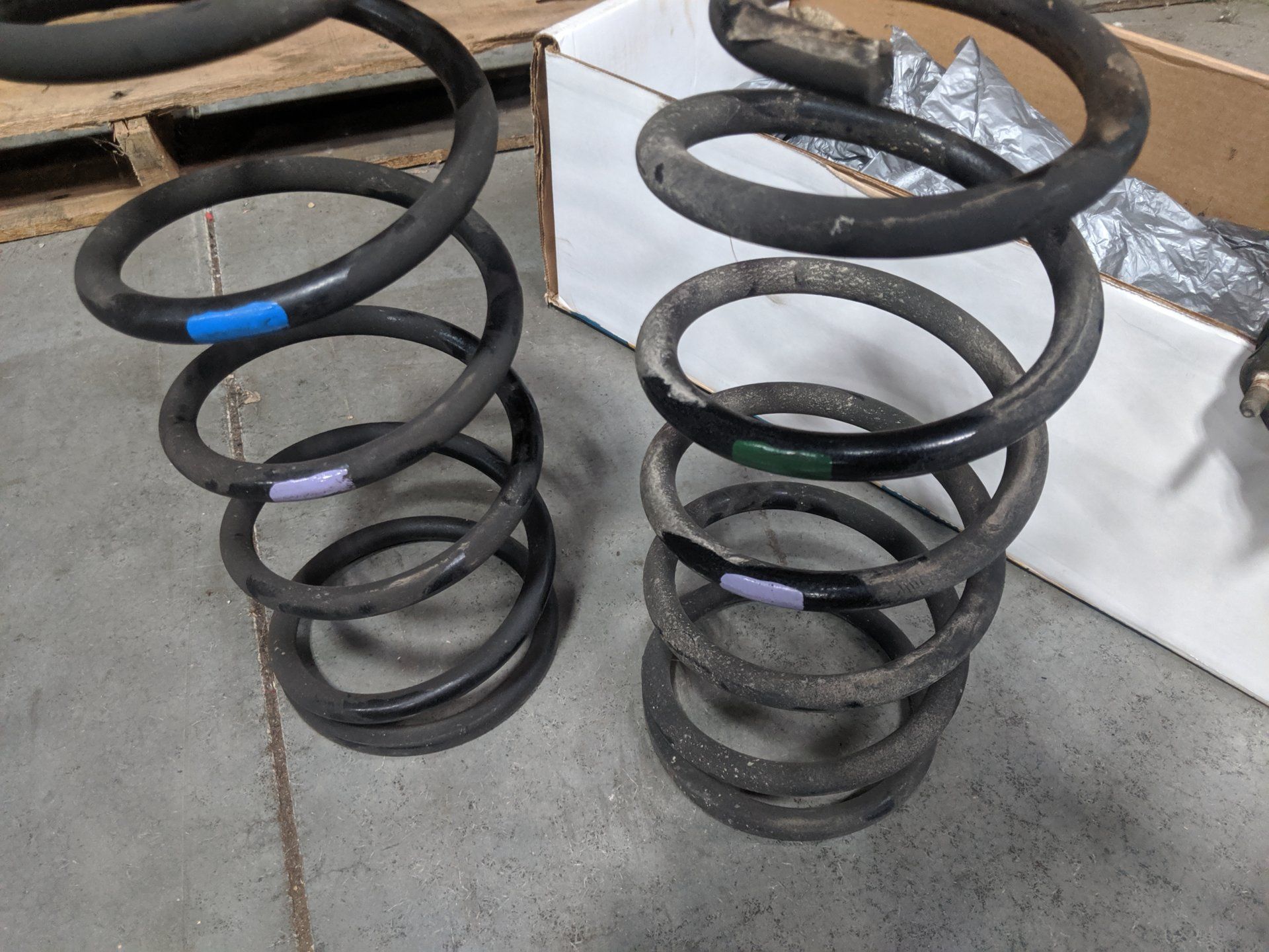

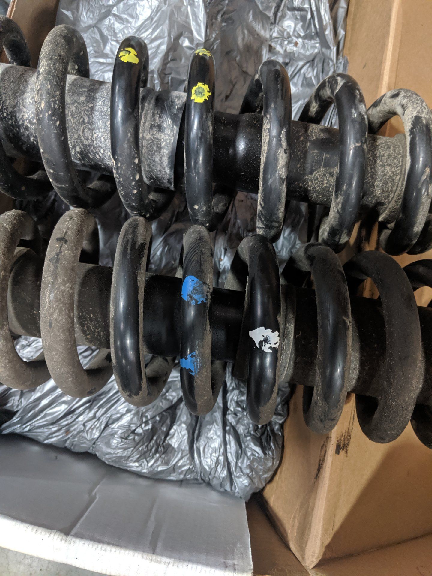

Confirmed: Rolled around under a 2019 at the dealer on Saturday: Blue and White is Driver Side Front. Green and Purple is Drivers side rear. Blue and Purple is passengers side rear. Yellow Yellow is Passengers side front. These codes match the same thing on a 2013 USA Spec and a 2019 USA Spec LC 200
Hey guys.
If anyone still has there stock suspension on there truck, can you check which springs go on the left and right on the 200 series?
Im putting my stock stuff back on and did not take note of which colors were on which side of the truck
Appreciate the help, keeps me from going over to a toyota dealer and rolling around on the ground as the sales guys wander up wondering what im up to.

View attachment 2104948View attachment 2104949
Might want to specify year.. springs can change from year to year as more features are added, third row deleted, etc.
Confirmed: Rolled around under a 2019 at the dealer on Saturday: Blue and White is Driver Side Front. Green and Purple is Drivers side rear. Blue and Purple is passengers side rear. Yellow Yellow is Passengers side front. These codes match the same thing on a 2013 USA Spec and a 2019 USA Spec LC 200 .
