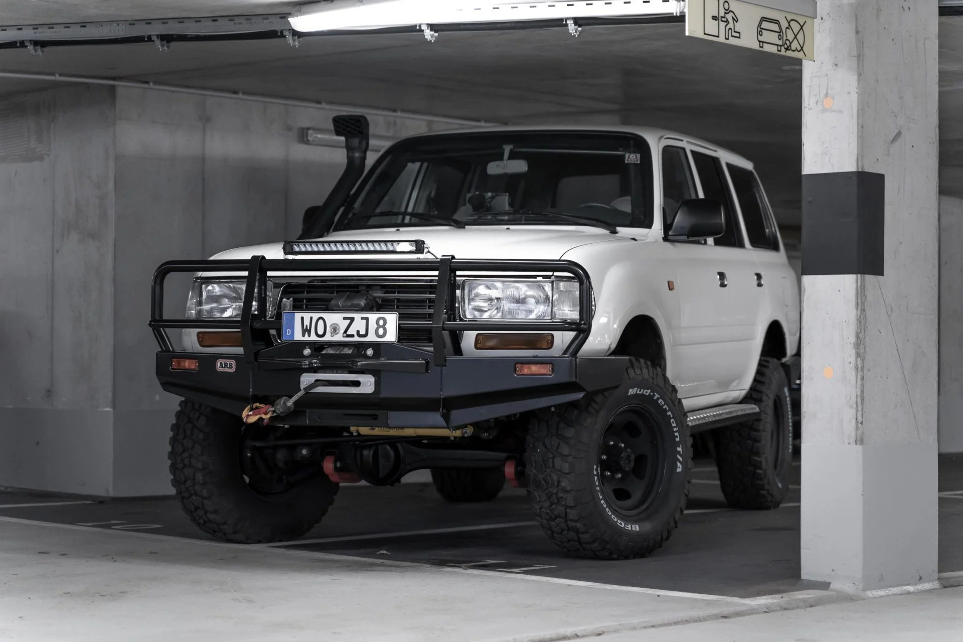

She's a 1997 frame with matching HZJ Diesel Engine and the 5 speed manual transmission. On top we have a VX body (old body was not in good condition), which is absolutely rust free. Since she's made out of multiple trucks, there is a bit of stuff going on here. Everything on the old girl was redone, every bushing, every bearing, paint - just about everything. On youtube you find a quick review. If somebody is intrested in an in depth review, just let me know. I do my best to write everything down and eventually make a video out of it.

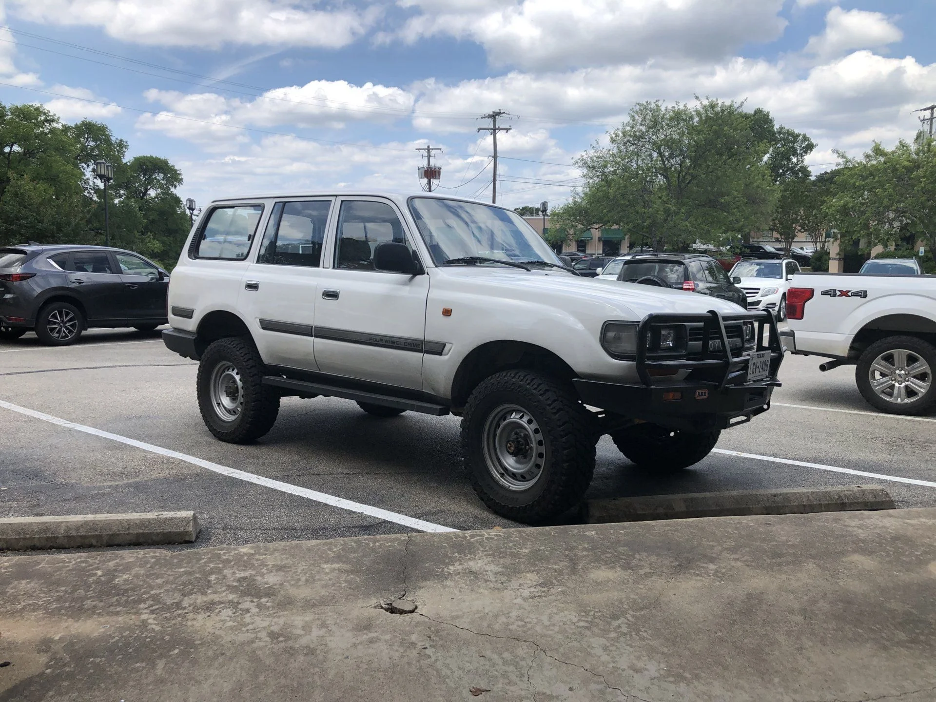

Up front:
I installed the ARB Delux Bullbar, which looks classic but functional to me. This bar was ordered completely new and I left the flat black powdercoating on it. Looks very good to me. What you don't see in the picture; I installed 2 roadsafe recovery points. Inside sits a WARN TABOR 12k winch, with synthetic rope. On top sit's an OSRAM quality LED lightbar. I love this thing, it puts out a hell of light in such a small and efficient package. Left from the license plate you can slightly see the air quick coupler connection for the ARB compressor under the bonnet. The switch is installed in the interior. That way everything is nice and where I need it.

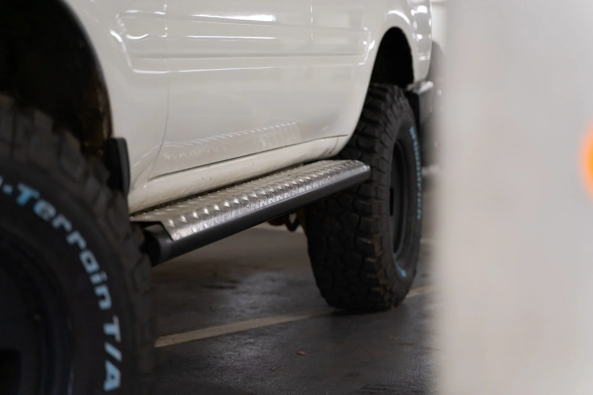

Side:

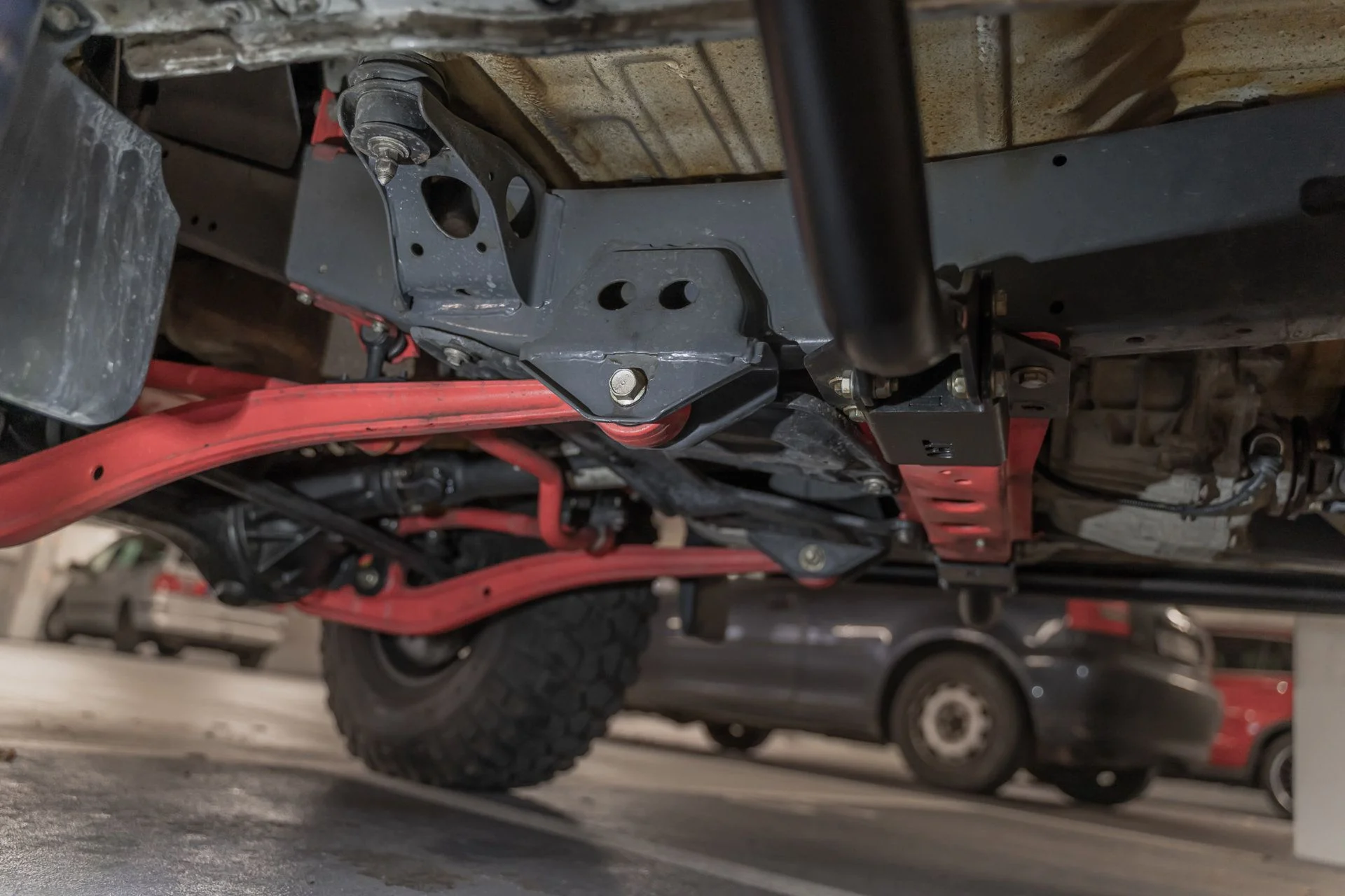

I ordered custom rocksliders with 3 inch tubing and a kickplate on top. They don't look too extreme in my opinion, offer the right ammount of protection and still fit the look of the 80.

In the back I left the standard plastic rear corner cap's. I like the look and the low weight. Since I plan to travel to Kamtschatka and back (approx 40.000km) with this truck, I need something more sturdy. The ASFIR rear bumper is already ordered and will arrive in 5-6 weeks. I will keep you up to date. I struggled a bit with the order of a steel bumper. As a small reminder: It's an HZJ... 131hp no turbo. It's slow... extremely.

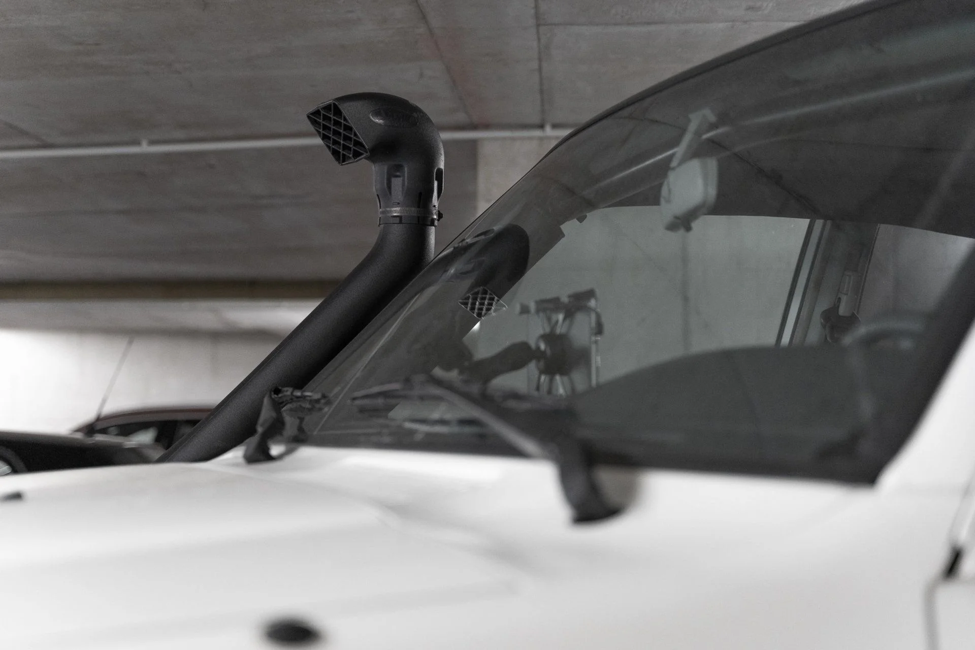

Snorkel:
We installed the Safari Snorkel on this truck during the process of rebuild. In my opinion it's the perfect construction and looks just classic to me.
Wheels and tires:
Powdercoated HDJ80 wheels, which are wider than the standard HZJ wheels (6x16). Because this truck is an HZJ, there are no fenderflares, so you have to be careful what wheel/tire combo you want to fit. For me the 285/75R16 BFG Mud KM2 did the trick. In germany it's not allowed to have tread stick out of the wheel well. In case you are wondering: Yes manual hubs, this truck came with standard part time 4wd. It was not converted. If you run constant 4wd, I highly recommend converting. One of the best mod's I did to my 100 series.
Up front:
Snorkel:
Wheels and tires:
