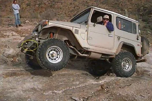

If these are the early design that push the front spring eye forward they are considered by most to be, well, junk. I remember seeing the business advertised in Toyota Trails some time ago for sale for many months.
Can you explain a bit more about this product. They don't look very different, at all, from MAF set up.
They will work if you swap sides and run them backwards. Flip your springs, short side to the front,
Install them similar to the 4+ kit. If you run a short shackle you need to trim the back of the shackle hanger to clear the spring eye when it travels up in compression ( again , see the 4+ design ). If you don't have them , you'll probably need a 4 degree caster shim when you're done, it will set about 6 dgrees positive caster without them
early LCAH style (rock finder)
