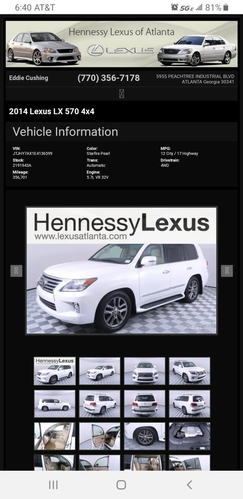

Good phone. I guess I should be a little skeptical when I see AT&T because AT&T calls something 5G when it's not. They did the same thing years before with 4G and calling their systems 4G when it wasn't actually an LTE system.
