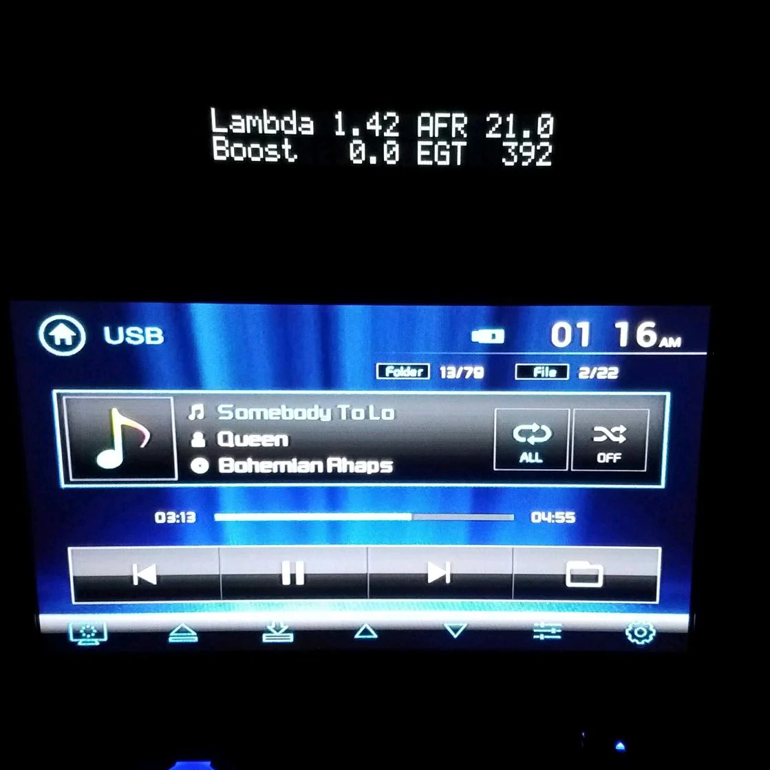

Hi.. I've installed a 2nd ecu system.. by zietronix.. I'm still beta testing it.. but it has both narrow & wideband outputs.. new inputs are: egt , boost, & o2 sensors, piggyback signals: rpm, oil/water temp, + a couple extras..
Hooks up via a rs232 to a laptop, software is free.. real time tracking via graphs..

the screen on the top is the remote mound LCD readout panel

the screen on the top is the remote mound LCD readout panelView attachment 1975936

Hi Ebike. The system you've bought is quite nice for monitoring/logging engine parameters. It seems to be intended to operate in conjunction with 3rd party stand alone engine management system, or piggy back fuel controller.
So I'm a bit confused as to your intentions with it as it has no control or output capability. Are you planning on using it with another system capable of modifying your fuel/timing curves?
There is only one system I've come across so far that is capable of modifying the step pulse (duration) sent to the spill control valve. I believe it was from a German company. I'll see if I can find it again....
