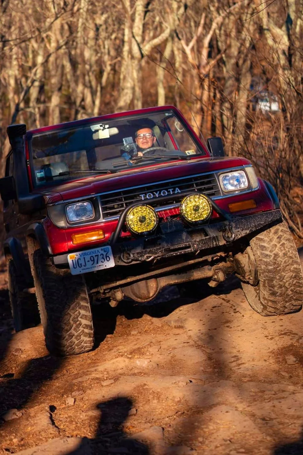

Finally had time to mess with injector pump and try a different settings, I had left it way to retarded last time I replaced the IP , drove well around town as daily driver but on steep hills on the mountains it felt like I was getting starvation and some white smoke, and with cold weather starts was almost like would start only 3 cylinders for 1st second then would be fine almost like the glow plugs were going bad .
After advancing the IP little by little and test it out I think I found the perfect setting, on highway will easily stay 70- 75 mph just fathering the gas pedal , no more temperature climbing going up big hills its basically a hole different truck now.

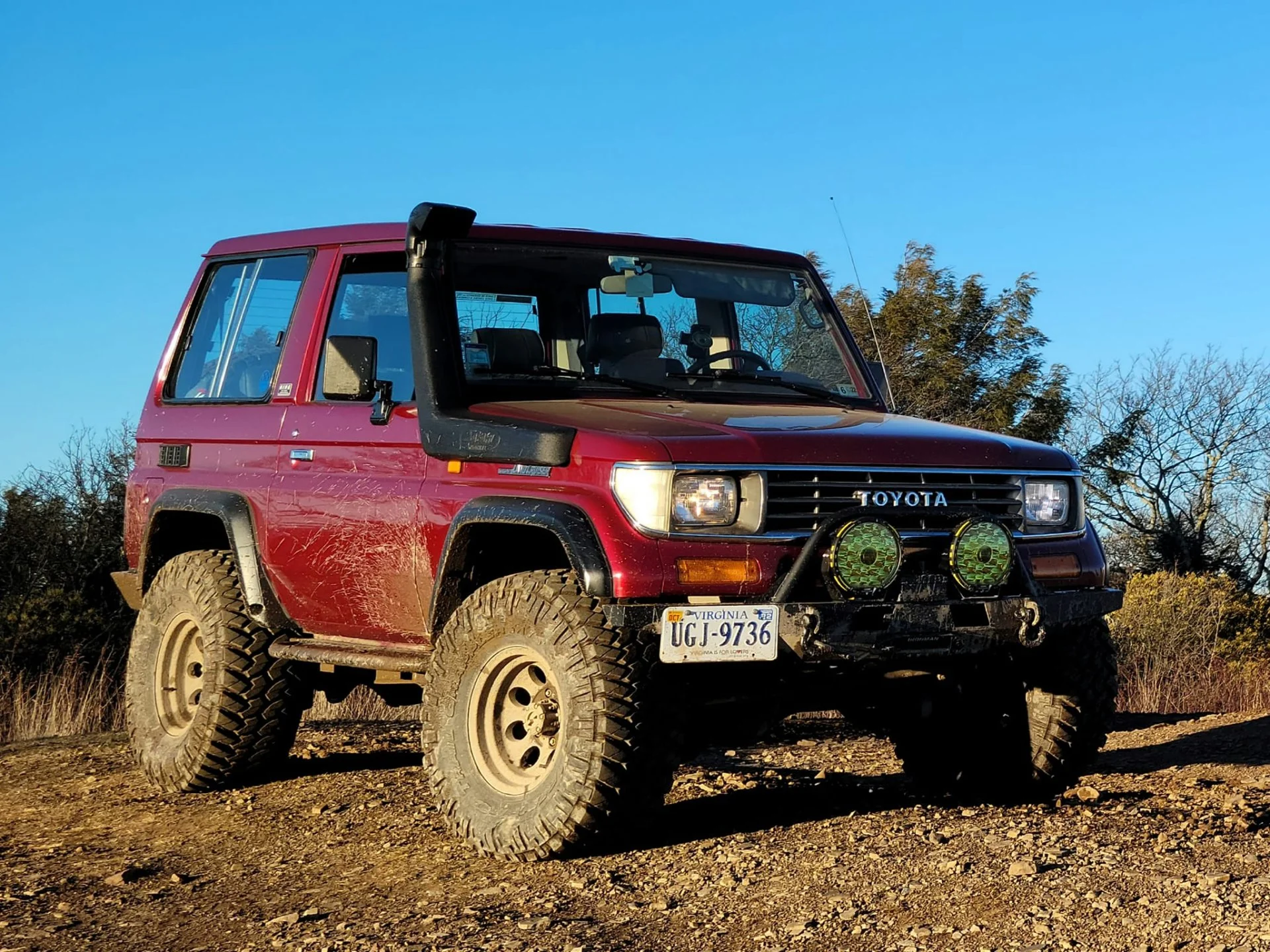

Some pictures at Flagpole in Va

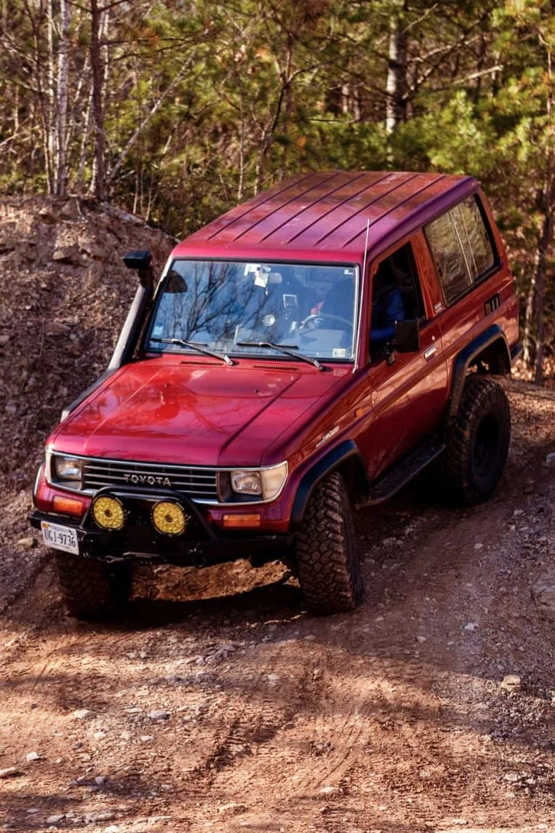

Nice to see the offroad pics. So few people in north america seem to actually take their light duty 70 series off road. With the right suspension setup, they're actually very capable rigs.
