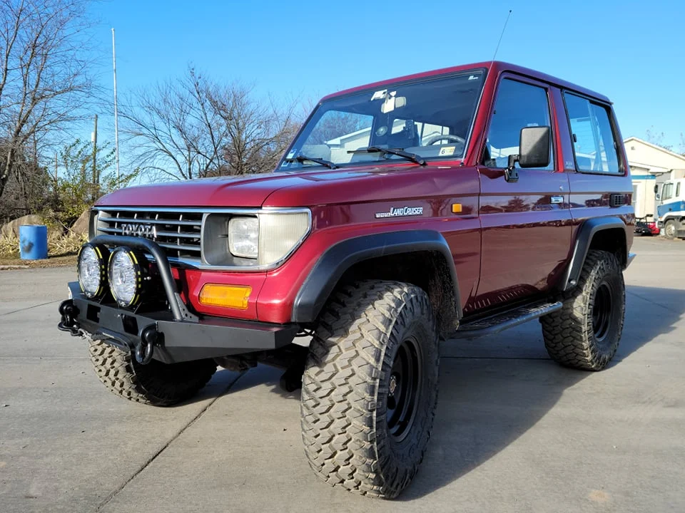

Hello everyone,

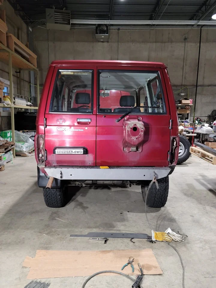

After driving it as daily driver for a year and a couple off road trips was time for some updgrades

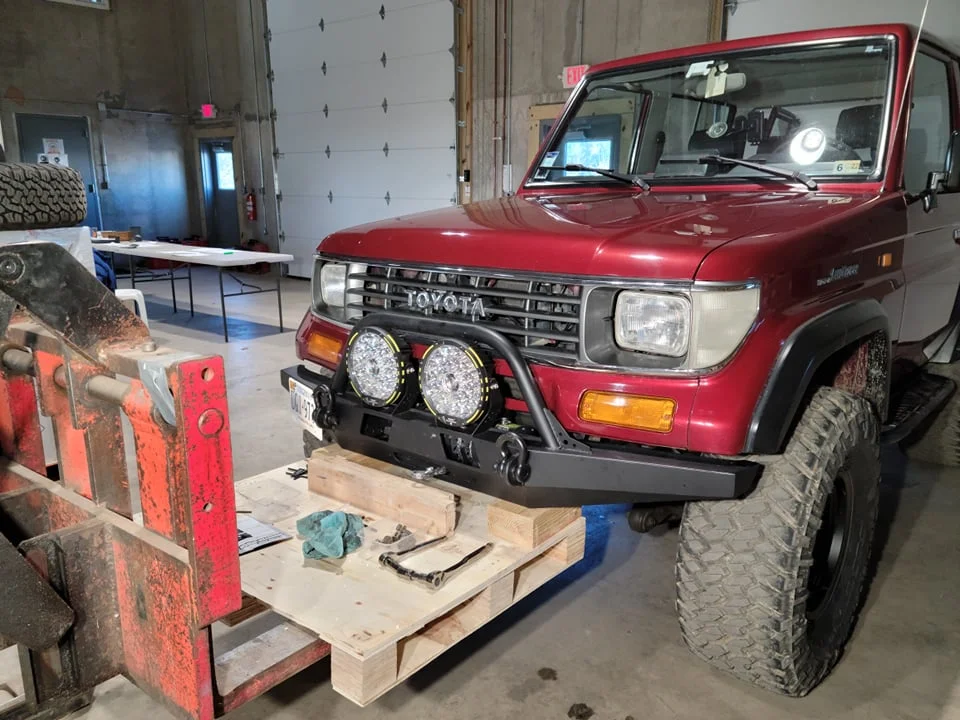

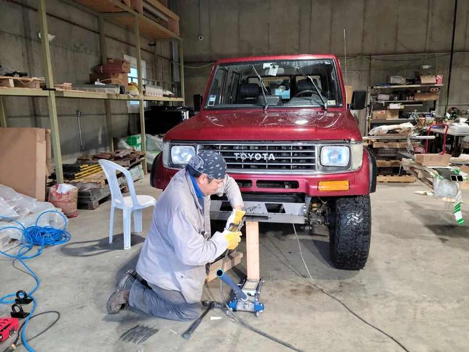

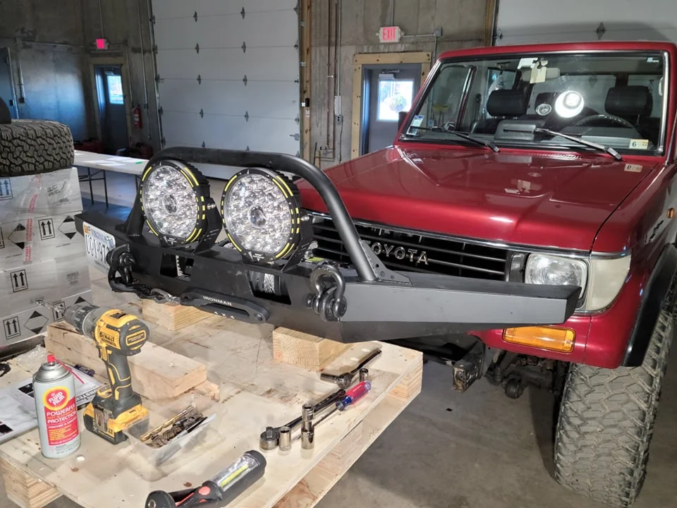

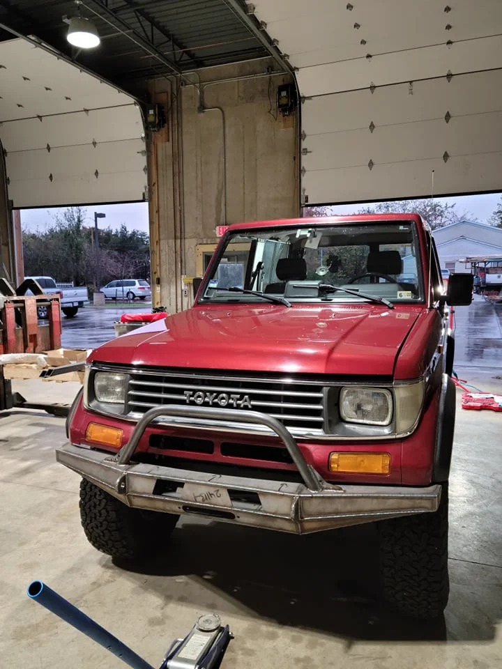

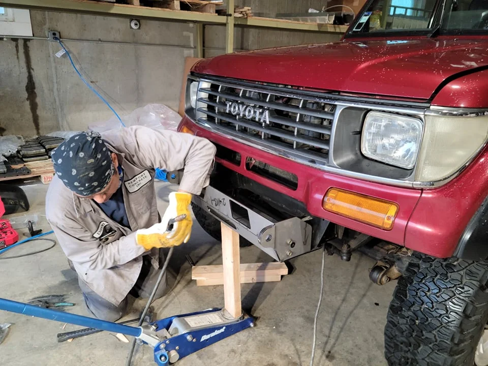

Costal Offroad front Bumper
This is that I start with .
Perfect fit and easy to put it together
Antonio

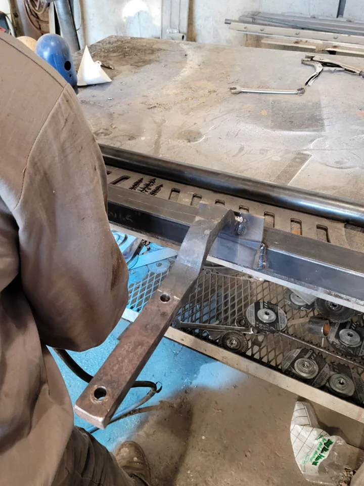

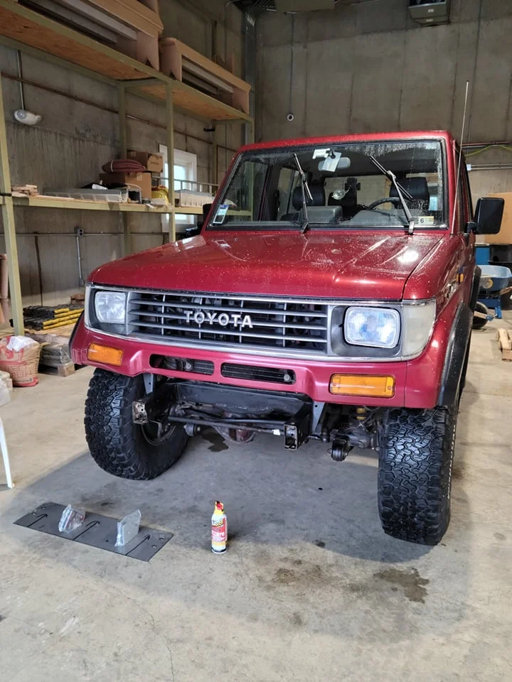

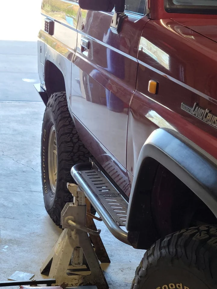

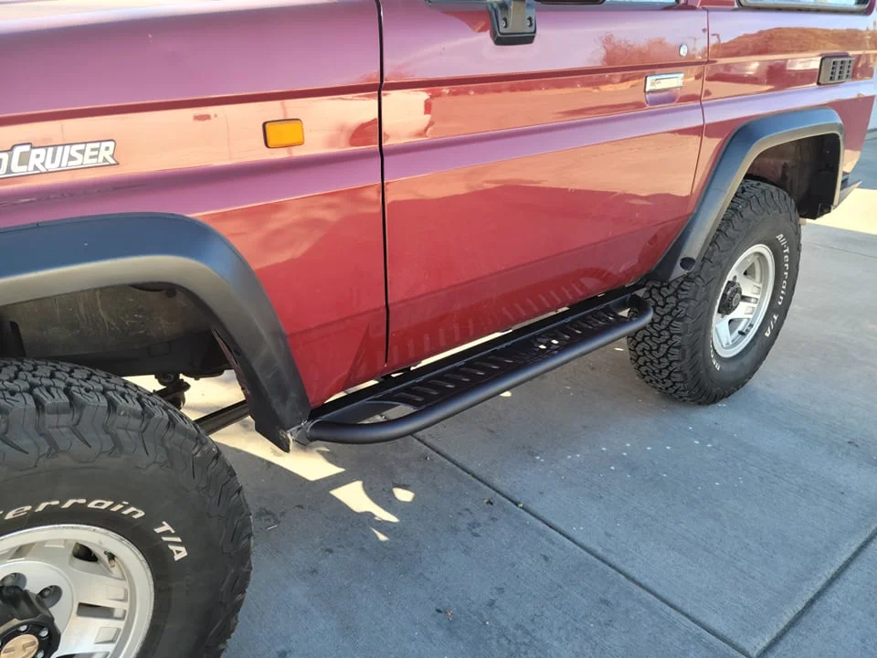

Rocksliders due to fact were send for a LWB also requires some mod. But easier to make it work

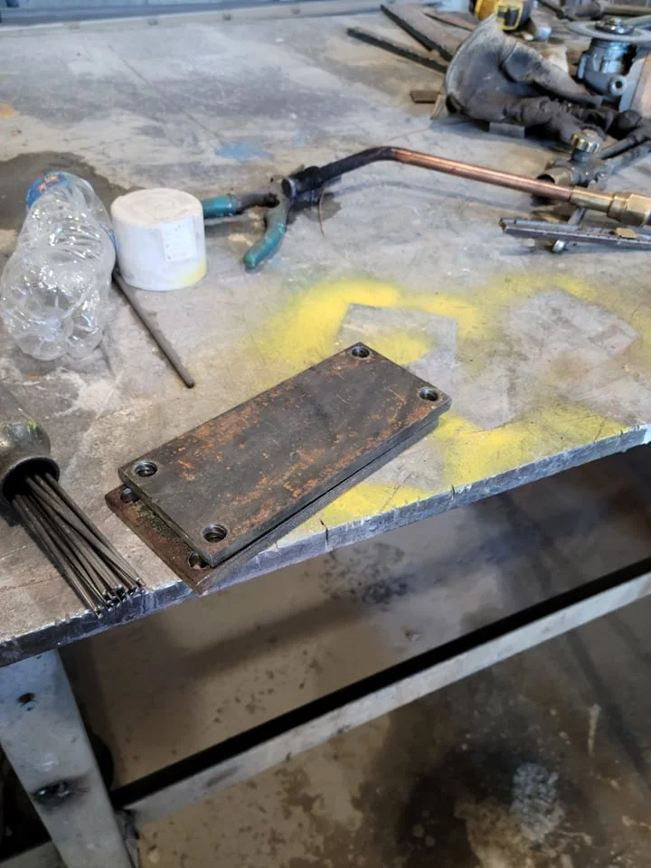

Comes with plates to weld to the chassi but I decided to make some brackets to make it easy to remove , just in case
The flex exhaust pipe is right on the way , under the passanger side, I end up beef up a little the bracket and I will make something to protect the exhaust in the future
Test
The braket for in order to pass the flex pipe
Double brackets for the chassi
Final product

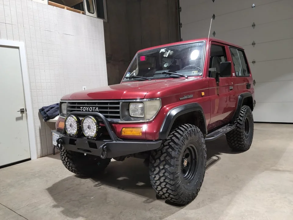

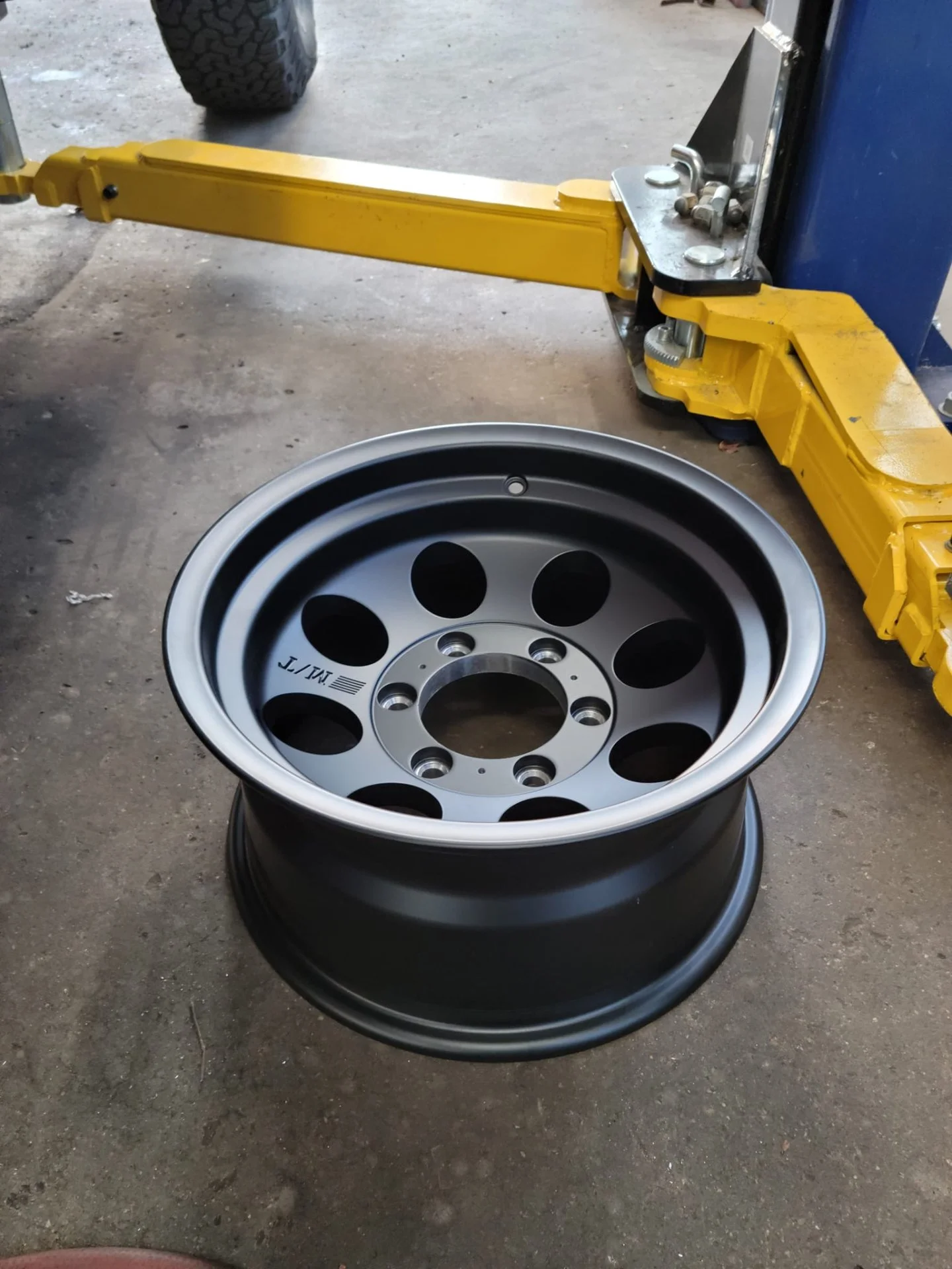

Tires arrive ; )
but the wheels come in with wrong off set .

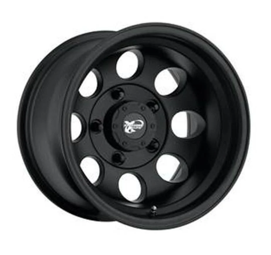

I found a 15" wheel with -47 ET and it might work but was send out -19
Pro Comp Alloy Series 69 Wheel 15x8 6x5.5 (6x139.7) - Matte Black -47 mm Offset​

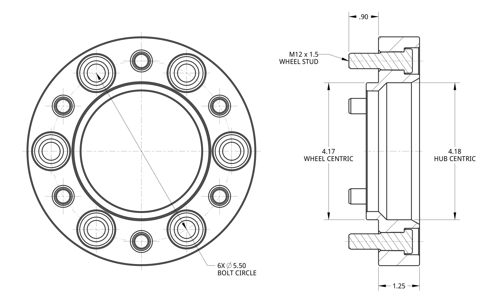

This wheels will required a hub centric ring from 106.1 mm to 108 mm
If doesnt work out I will look for
Mickey tompson Wheel with right Bore 106.1 and add spacers on it
Antonio

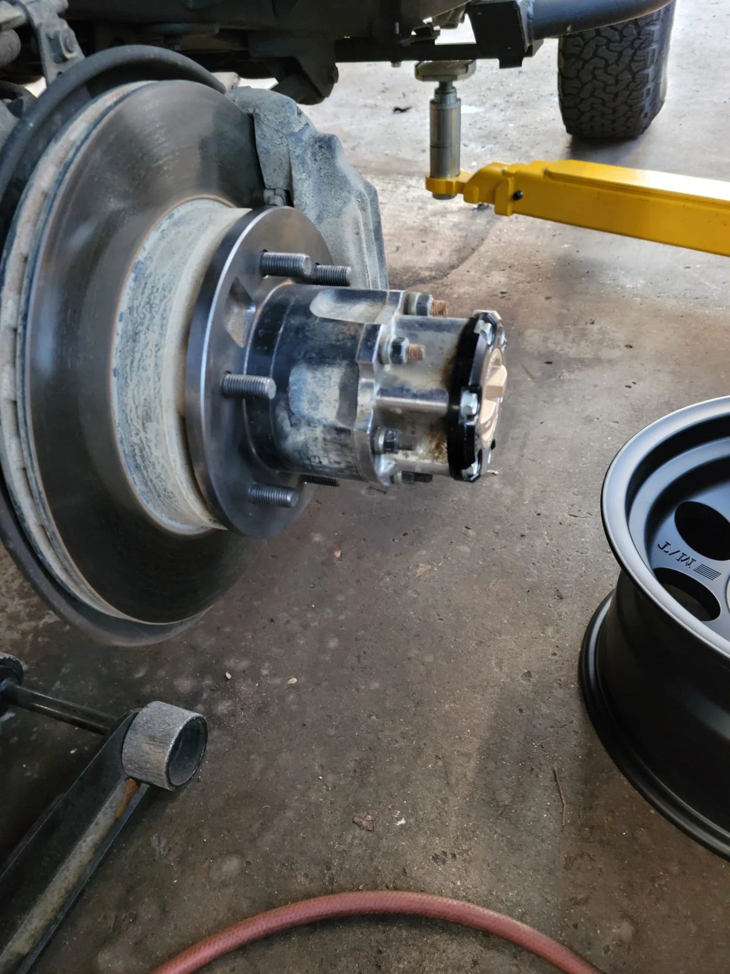

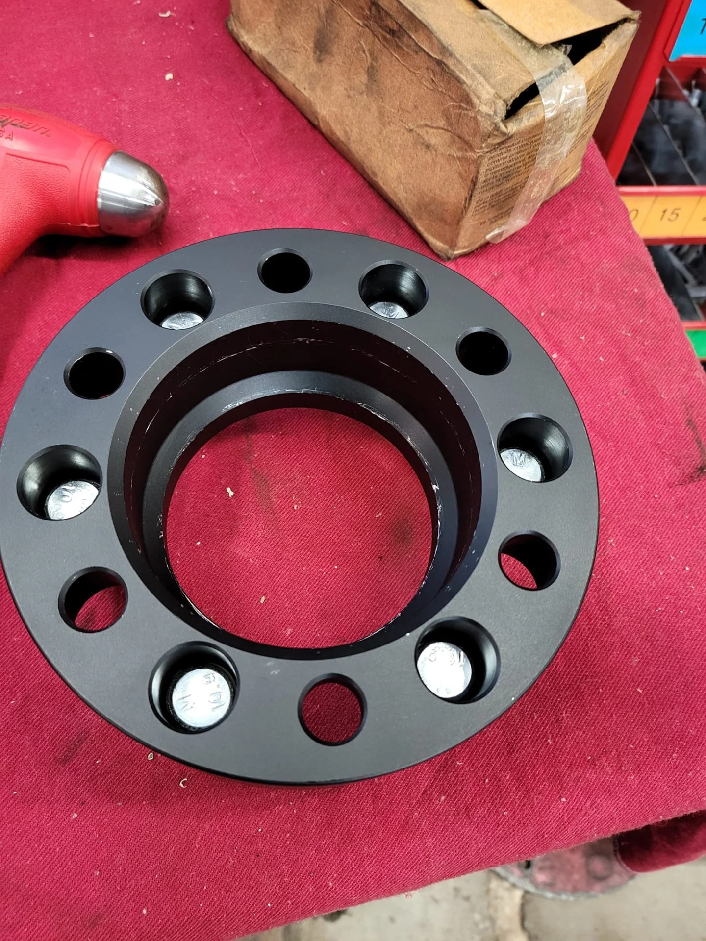

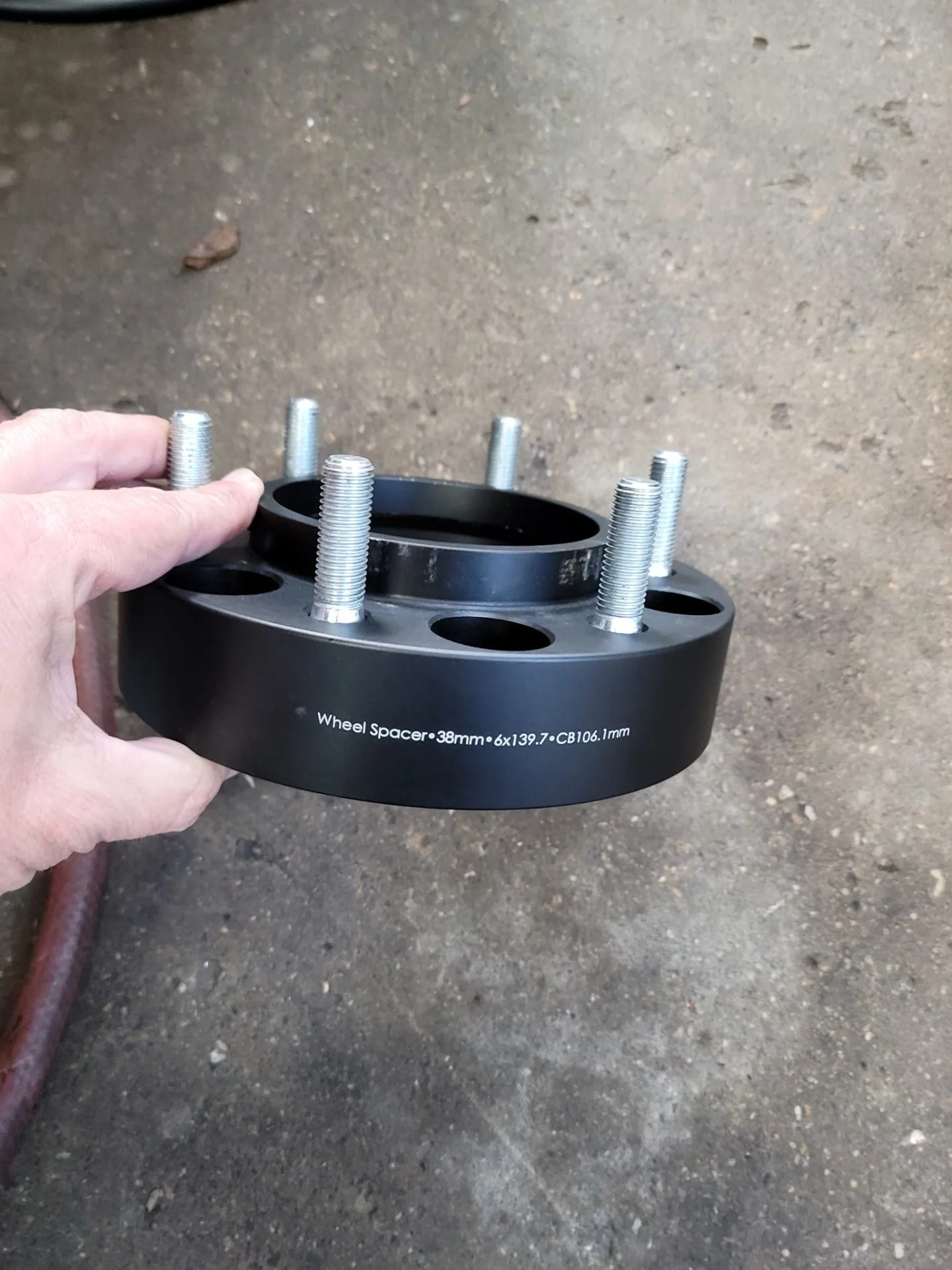

For now I will use the Mickey tompson Wheel, amazon got them and the Bore is 106.1 exactly same size as original Toyota wheels but 8 but the maximum offset available is -22 mm

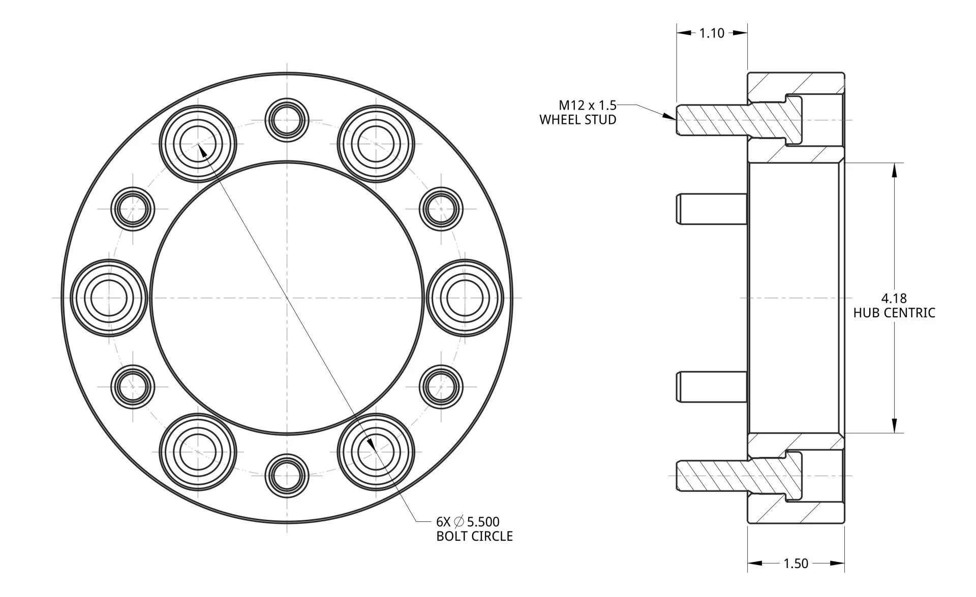

Therefore only option for this set up is to use a with 1.5" 38mm spacer.
Spacers
For the front wheels only option is a hub centric as far I know , I will try this by the end of the week , the Hub and wheel centric will not clear in the front
Antonio
Front Hub test with spacer with a hub and wheel centric .
I will test soon this spacer in the rear but I think it will work in the rear .
The front I am guessing people are using just hub centric and I am wondering if will cause future vibrations but I will give it a try as soon the spacers arrive from spidertrax
Antonio

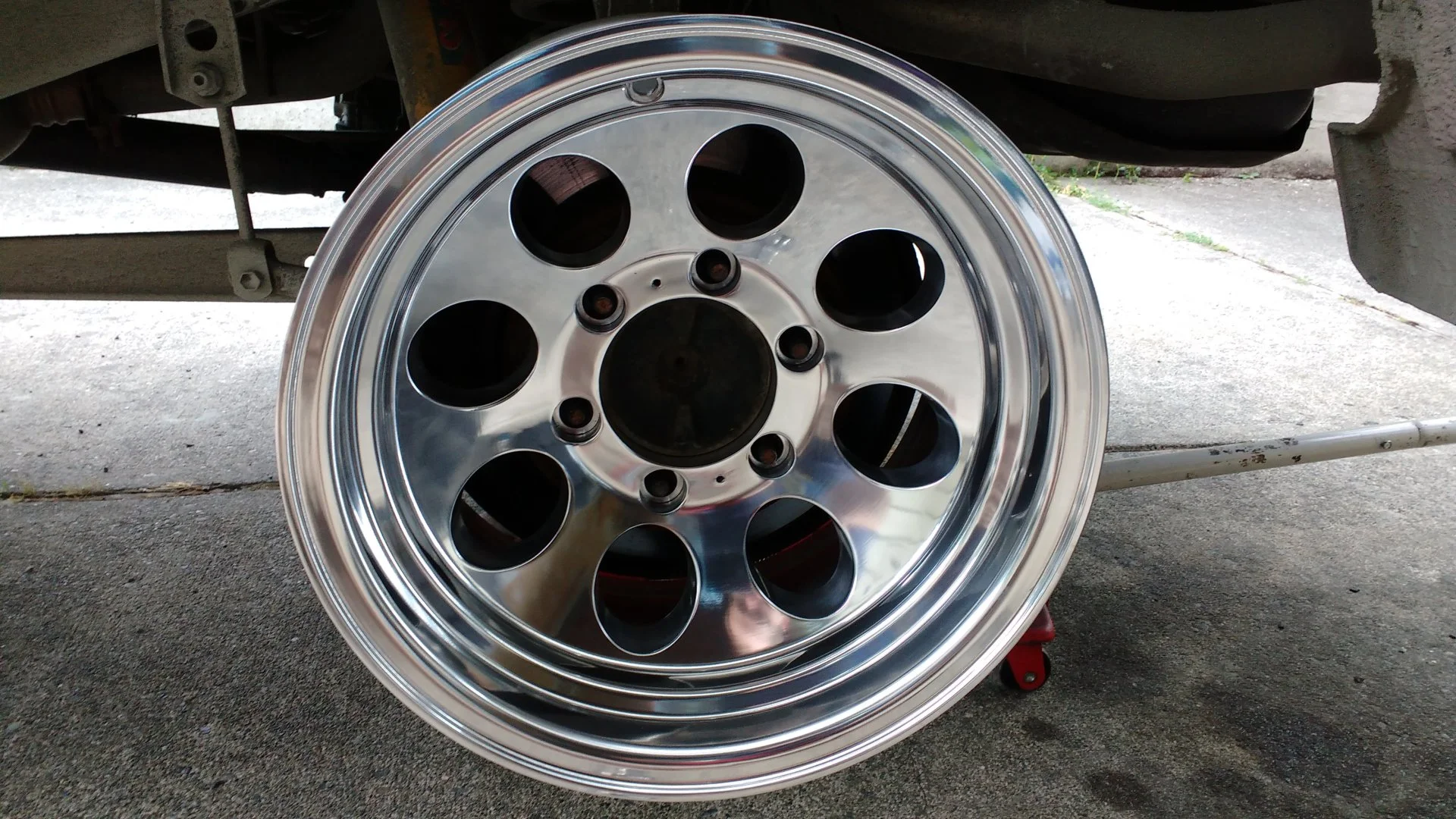

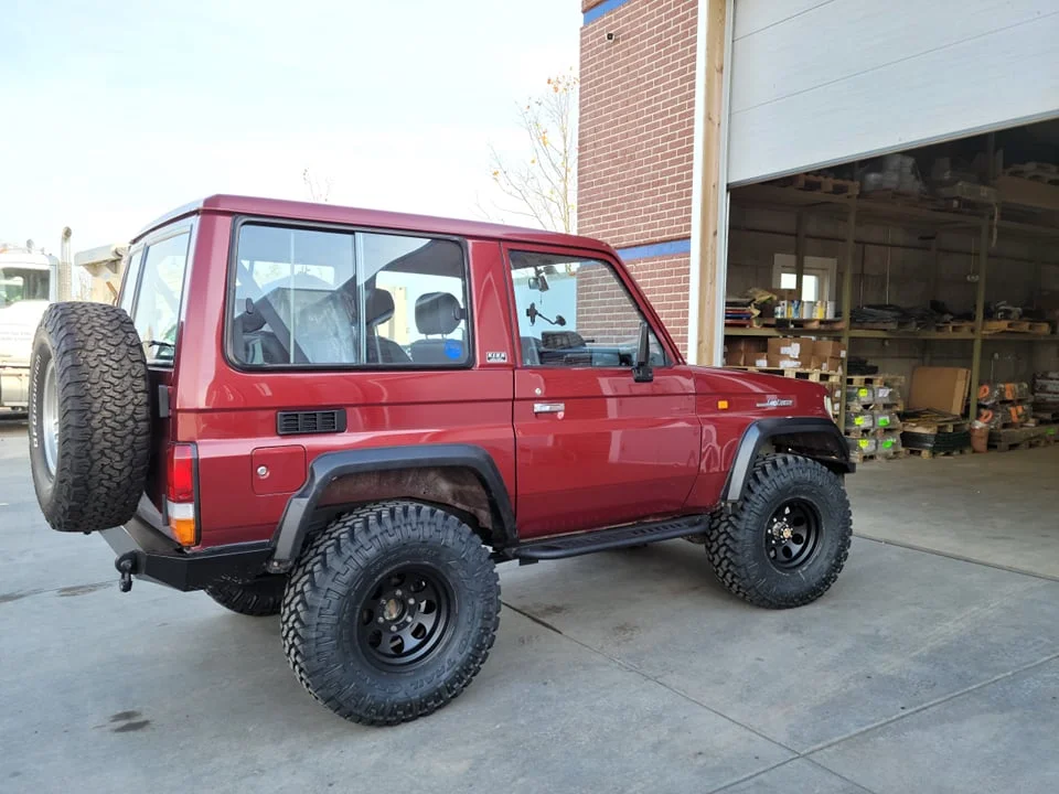

Just FYI, but you can get those same style of wheels from Ion (171 series). I bought them in 15x8 with the proper Toyota hub centric bore diameter. I bought-27mm offset which I found to be perfect (upon recommendation of a KZJ78 owner who does a lot of off road). I run 35x12.5R15 tires on them and don't have interference issues. A more or less aggressive offset would definitely cause me issues with the 35" tires; I think -27mm is perfect.
The part number I bought (polished aluminum finish) is: 171-5883P. I believe they have black versions too....
Couple pictures here showing how well they work: Ditch my sway bars? - https://forum.ih8mud.com/threads/ditch-my-sway-bars.1268994/post-14153316
Here's how it looked before putting a tire on.
The original Toyota stock wheels are -20 mm that means -27 mm wheels are only 1/4 inch different , are you sure your wheels are -27 mm off set with 106.1 bore?
I was thinking to have a set made but would have to be custom made as -50 mm ET 15 x 8 with a 106.1 bore
Your truck looks amazing
Antonio
Nice work! Great looking truck.
Antonio
Hello, yes, I'm sure my wheels are -27mm. My LJ78 originals were 16"x6" 0mm offset. With the KZJ7x, Toyota went to 15"x7" -20mm offset.
Thanks for the compliment. Here are some more pictures showing fitment. I think with this tire size, and -50mm offset, the tires would definitely hit the fenders upon full articulation. LJ78 100mm lift on 35s - https://forum.ih8mud.com/threads/lj78-100mm-lift-on-35s.1232042/

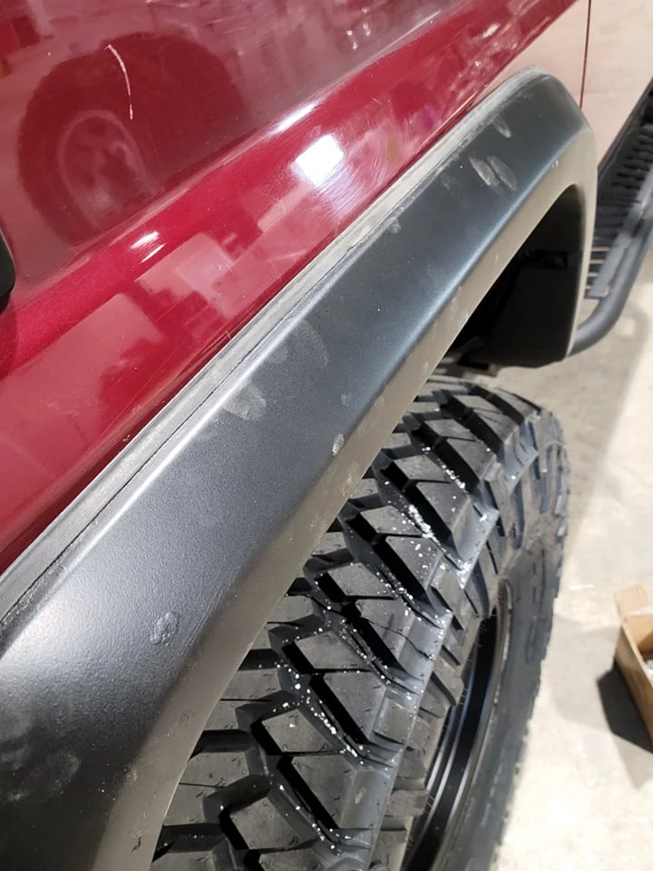

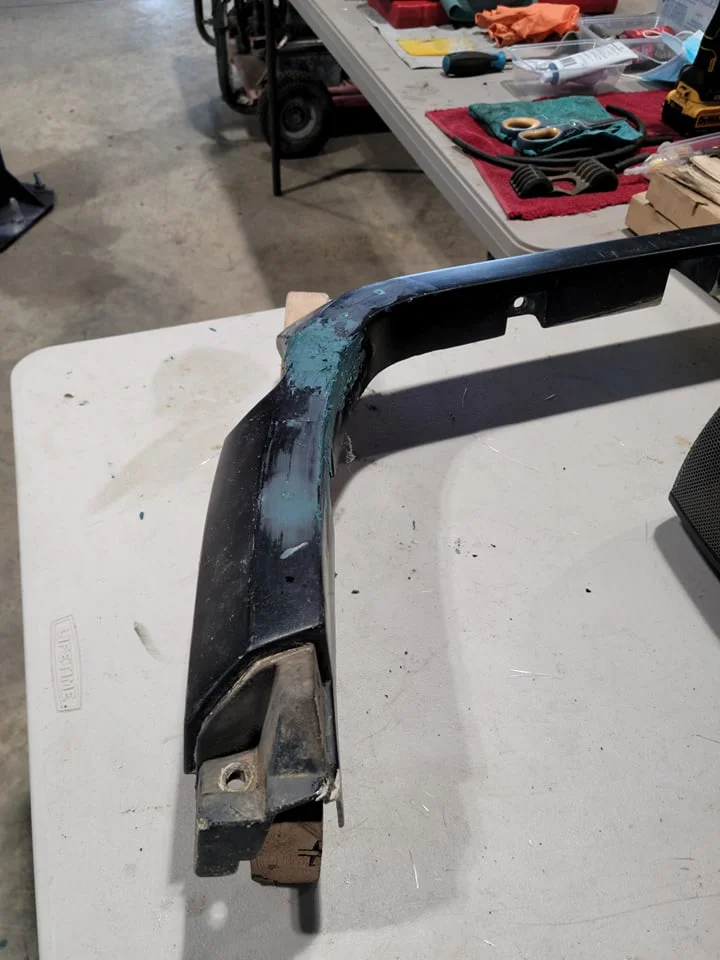

Also fixed the a broken rear fender
First time doing a repair with fiber glass, actually much easier that I thought , use fiber glass on inside to re enforce some bondo on outside sand it and painted with plastic dip paint final product looks ok
