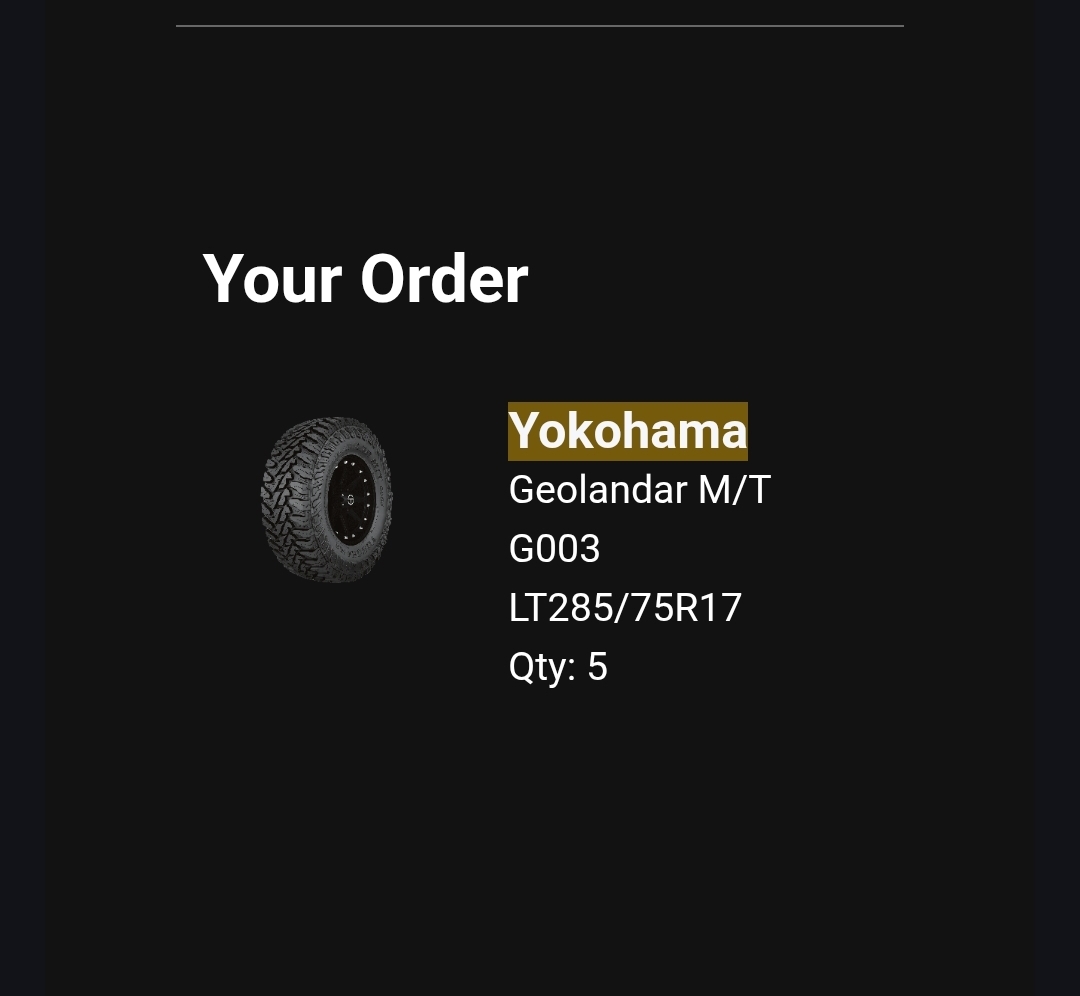

I usually benefit from the trove of wisdom here, so tonight I want to give back. If anyone is considering building their 200 and using it for real wheeling, you will need to choose tires.
The shop, which did an excellent job on my build last summer, recommended KO2s. I used them for a little more than a year, wheeling regularly in the summer and fall. I tore through three sidewalls. One of them left me flat on the trail. The other two rendered the tires unsafe for road use.
I don't think the KO2 can handle the weight of the 200 on challenging, rocky trails.
I have now switched to the Yokohama Geolander G003. After two days of hard wheeling, they show not so much as a scratch on the sidewall. They seem far stronger.
I will update if anything changes.

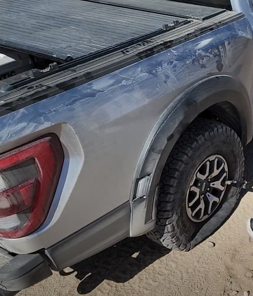

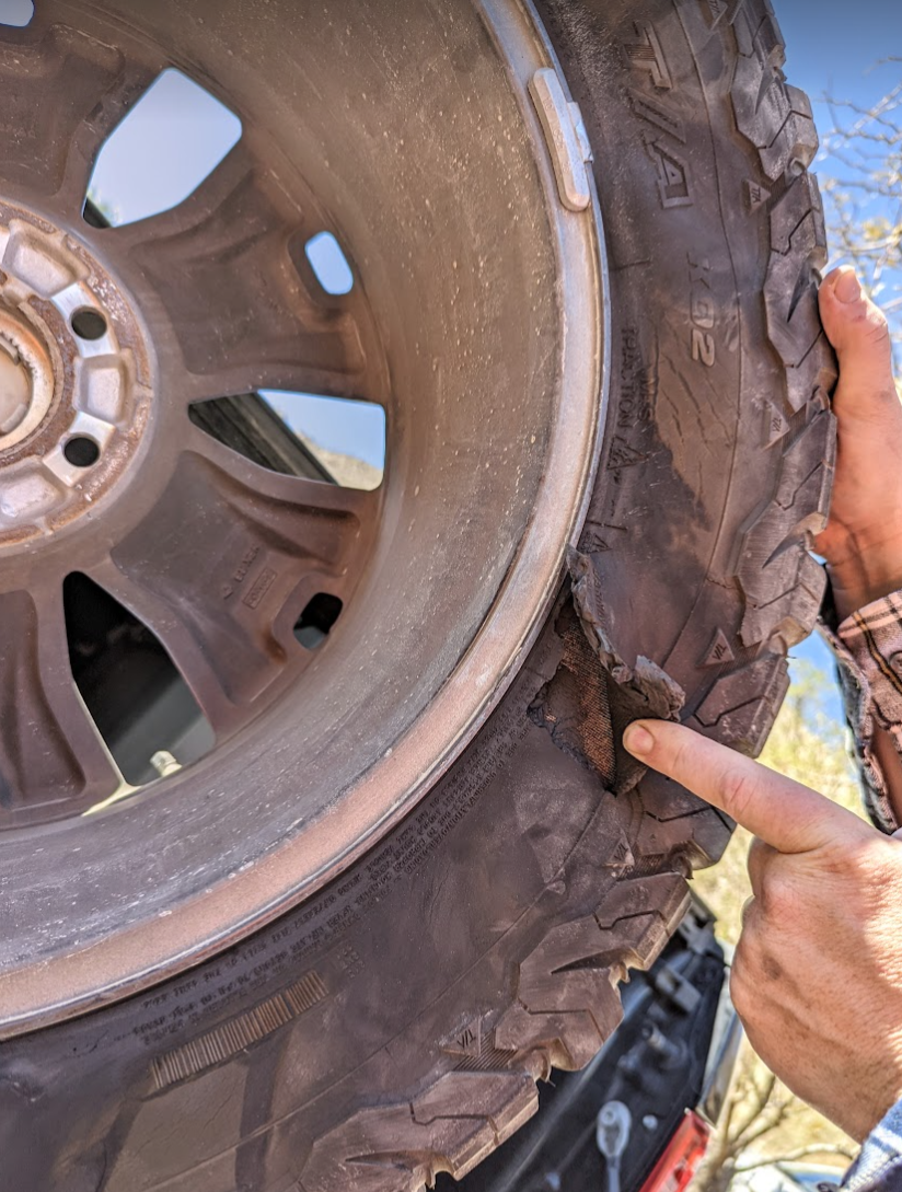

I've been keeping score on tire failures in my group. We're up to 12 tires. 5 of which were KO2s. Granted, they probably represent 1/3 of all the tires in the running as they are pretty good for the southwest region we wheel in.
I've been a critic of the KO2s as they sometimes get blanket fanboi enthusiasm even as there's better tires out. Including KO3s being maybe a new benchmark.
To be fair, KO2s are one of the few ATs that use 3 ply sidewall construction. Though you'll want to check specifics as some milder sizes and load range C or less only use 2 plys. Most all floatation sizes will have 3. I don't think KO2s are any less durable than most competing AT tires as that's suppose to be one of their pros.

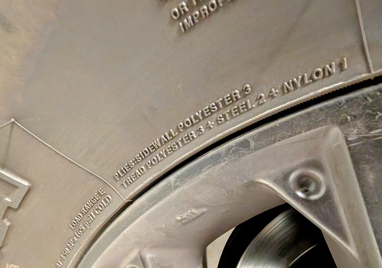

Do you happen to know how many plys are in the Yokohama Geolander G003?
I don't know firsthand but most MT tires, being the most aggressive, are going to be 3-ply construction across the board. That's not to say all brands are going to be made equal in robustness and is only one parameter. I would always encourage floatation sizes as that's going to be better even within a tire model, with more tread depth and compliant and durable construction.
I can answer for the Yokohama Geoloander X-AT that is 3-ply and probably closer to what a KO2 is meant for usage wise. It's an R/T tire, but has some of the NVH finishing school qualities of an A/T tire. I've only had it for about 2k miles but I think it's a great alternative if one is willing to trade things like rolling resistance and cornering traction for more aggressiveness and durability.
Other great A/T tires I've had experience, which I would pick ahead of KO2s are Falken Wildpeaks and Toyo Open Country. KO3s would also be really high on my list but have yet to try firsthand.

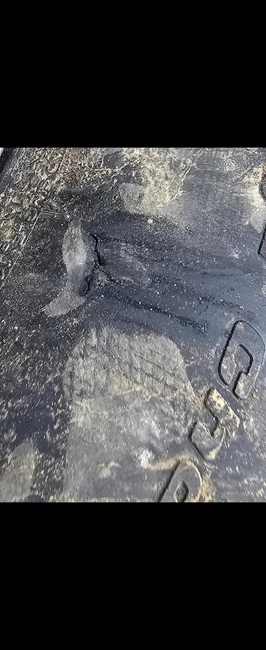

Resurrecting this thread as I have had similar issues with KO2s and now KO3s as well.
@Hendlerj what has been your experience with the Geolanders so far? and how many miles do you have on them?
I have been offroading with KO2s for a decade now and never had a problem with them on other rigs. But on my heavy LC200 series it's been one sidewall after another. My rig is 7300lb which is not uncommon for an armored and equipped example. I damaged 3 sidewalls with the first 15K miles of having KO2s on this rig. Two were big chunks (no puncture) and one was an unrepairable puncture. I got two new KO3s 2 weeks ago and already punctured one of them again on the sidewall. This time, it was a twig!!! Totally crazy. Looking at other tires at this point. My tires are 295/70/18 load E and for whatever reason they are not holding up to my use. I have not changed the way I offroad or the trails I take. They just crap out under my car as soon as the sidewall hits anything.
