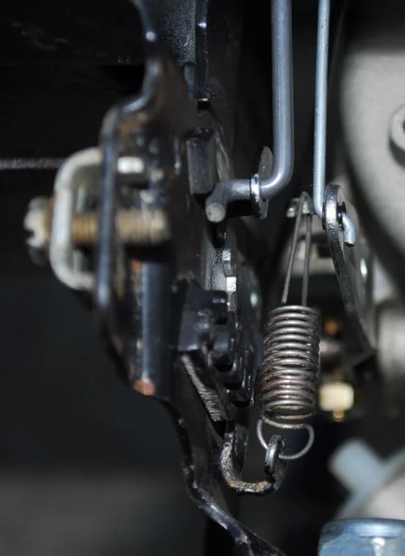

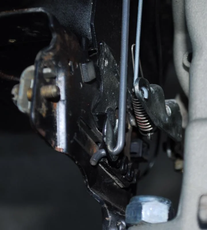

Anyway, a spring got loose while I was scrubbing it and I want to make sure I put it back correctly so the engine doesn't try to go 50,000 rpm on me.
Picture the rod that comes down from the throttle to the area near where the governor lever is coming off the crankcase. At the end of this rod there is a lever with a spring on it. That's the one that came off. Looking at it, I'm guessing that the spring should be connected to the governor linkage (rod going up to the carb). What I think that does is that when the throttle is all the way on, there is a strong tension on the governor linkage, but not when the throttle is off.
Here are a couple of pics. The first one is showing the spring in tension when the throttle is max. The bigger rod is coming down from the throttle. The thinner one is on the governor. The top of the spring in the pic is where it was unattached and where I decided I should probably put it on the gov lever. Second is with the throttle off and the spring is compressed with the U end protruding over the governor lever. Does that look like I set it up properly?
Looks right to me. I would wonder why the key broke? Mike
