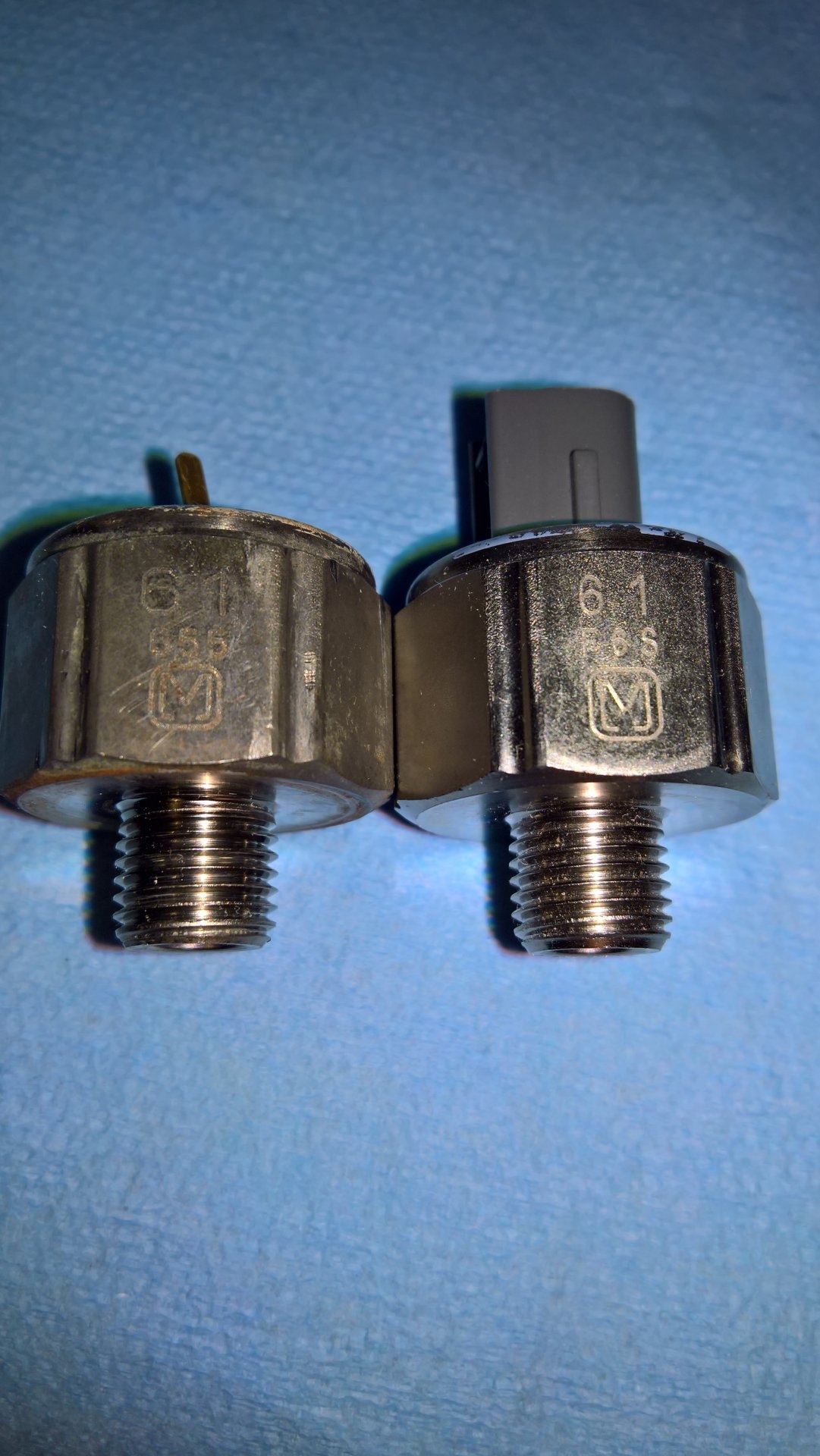

O' Reillys on right...much cheaper
Just for curiosity. Anyone know why the oem knock sensors are so much more expensive? Is it some high precision part?
^ precision markup more likely :rofl:

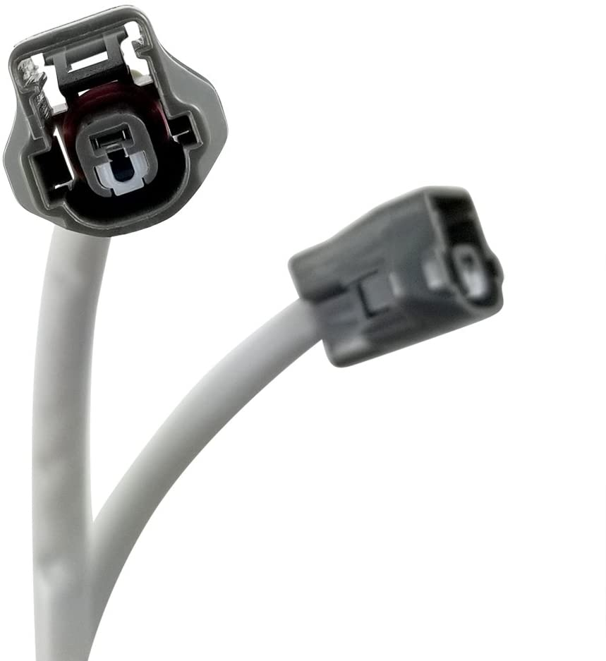

Just finished getting rid of CEL 52 and 55. Bit of a marathon. I'd recommend you view the wiring with suspicion. I started by trying the $30 specials and still both error codes. (BTW with enough practice it is not really too bad to get in there with a 10-12 inch extension on the ratchet to remove them. It was harder getting the plugs off actually. Not a lot of room and my fingers were not really strong enough for Mr. Toyota's locking connectors. I had to use really long pliers.
I found an old set of sensors on the shelf whose provenance I could not recall, so I thought I would try them while waiting for another set from the OEM/used supplier Saraujo recommended above. The connector for the rear sensor fell off the wire during this process. Fortunately I had bough a little harness with two knock sensor plugs from Amazon so I was able to splice in a new connector.
Amazon product ASIN B07F2P5QK9
After I spliced in the new connector error code 55 went away. No joy on the front knock sensor.
The connector on the front sensor looked new-ish. So I kind of ignored it and assumed that the engine control unit is just sensitive and I would need to buy a new OEM expensive one. But coincidentally the OEM/used sensors from the ebay seller showed up in the mail today, so I decided to try swapping one of those in. CEL code 52 persisted. I had bought 2 of the OEM/used so I tried the other one too. Still no joy. I looked at the front connector again and it still looked good, but cheap--and I had the second connector from the little harness at hand so I decided to splice in the new connector and lo and behold NO CEL! Moral of the story is ... maybe its the wiring...

Thanks for posting that up. I'm replacing my knock sensor wiring chasing down an issue. It looks like the link you provided isn't plug and play for FZJ80's, but we can cut the ends off and splice them in. Is that correct?
I broke one of my sensors doing a head gasket, the aftermarket sensor from eBay has worked just fine at a fraction of the cost. I also had to repair my wiring, and the terminal can be unclipped from the connector if the wire isn't damaged. I wouldn't cut and splice unless I had to.
I respectfully disagree with you. Those connectors are all 25 years old and have been soaking in engine heat for all that time. A good splice is not too hard to do. I soldered and used heat shrink tubing. I'd suggest that replacing the connectors is just good preventative maintenance if they are damaged in any way--which they invariably seem to be.
Yes; that is what I did. Much cheaper and easier to get than the exact right part. It is an identical connector but it is for a pigtail for another vehicle.
Right. But the wire can be removed from the old connector housing by removing a plastic pin. It then snaps into the new connector. Unless the wire is already damaged, there is no need to cut and splice.
