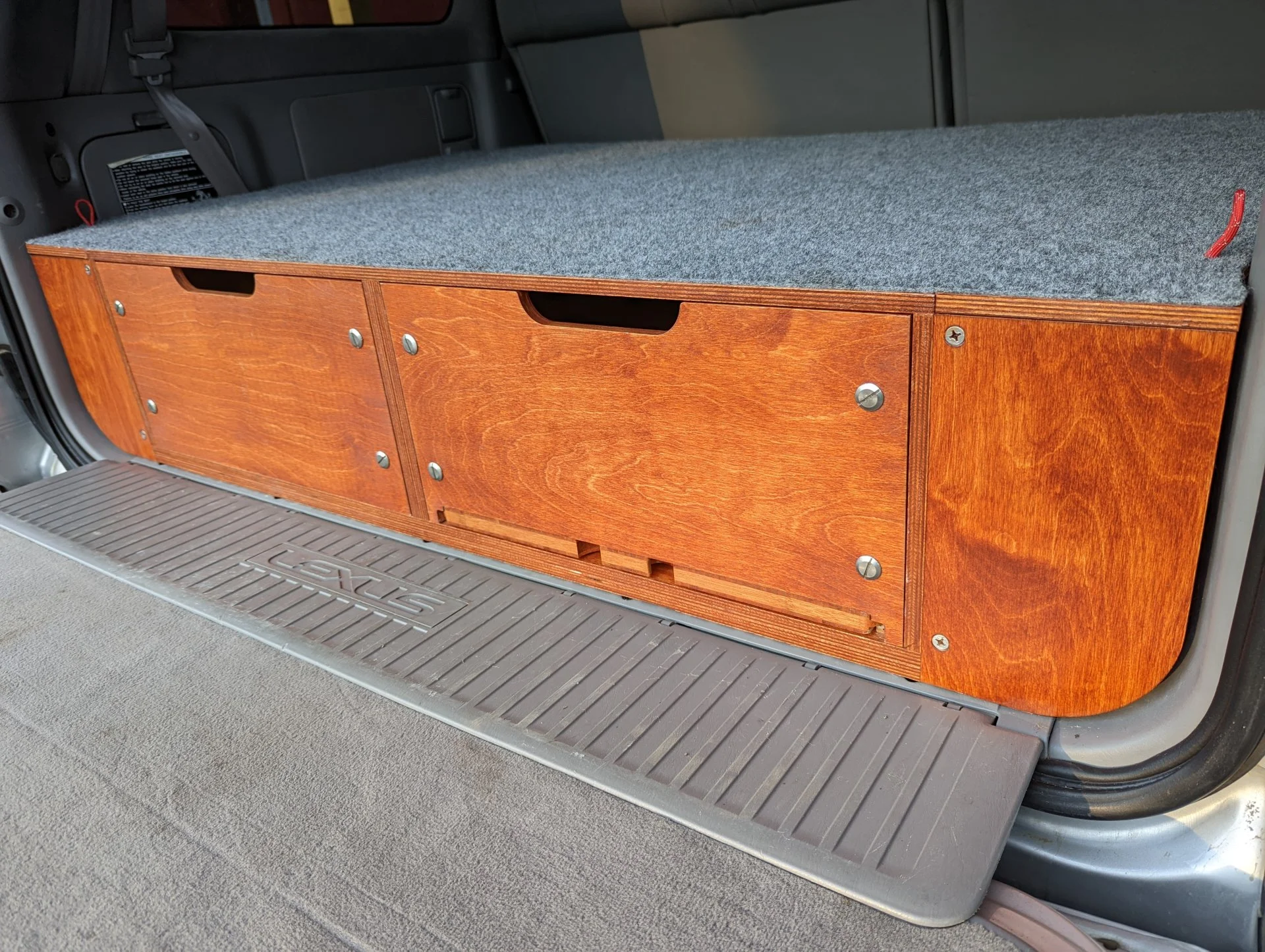

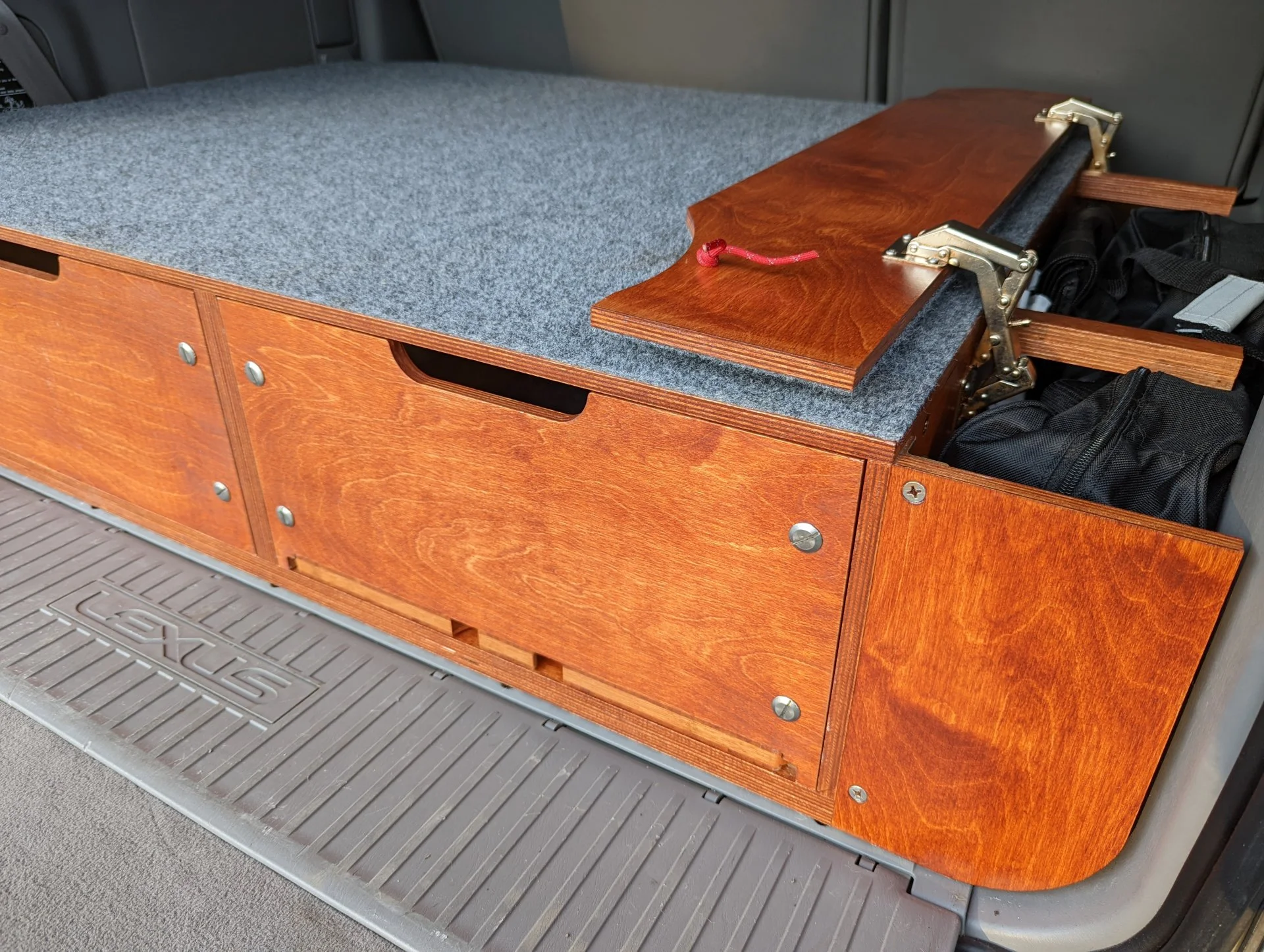

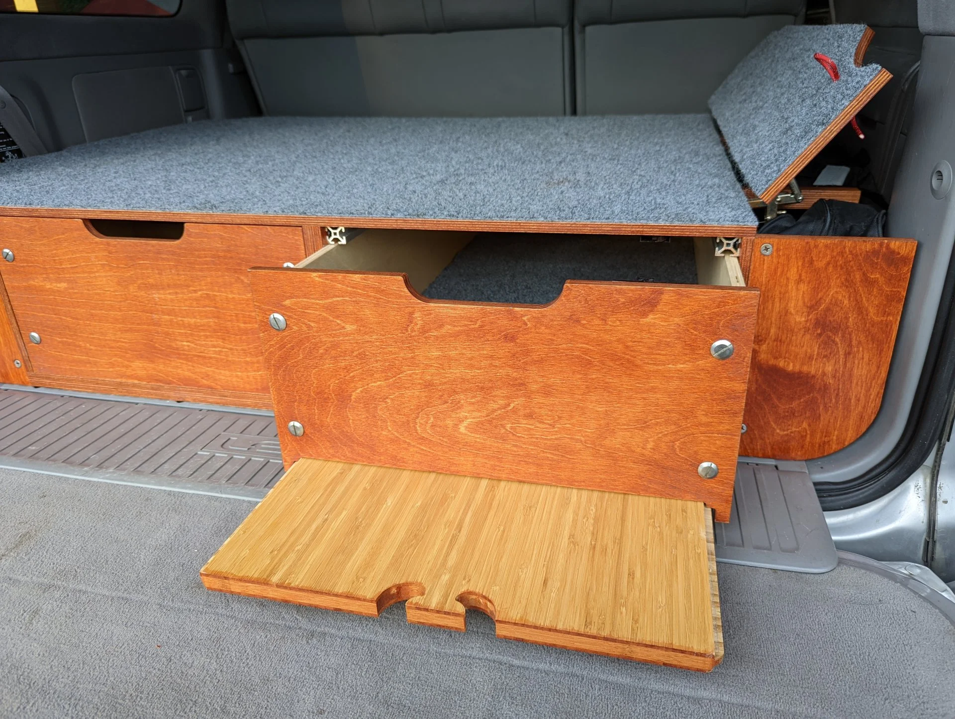

Adding some long overdue pics of the (now OG) Reefs.
Where visible, they're stained with Miniwax Gunstock finish which was a pretty close match to the red toned wood on the LX trim. Sealed with several coats of Polycrylic and topped with cheap marine carpet.
I initially purchased some angled aluminum to protect the leading edge, but then decided to leave it as-is. Figure it's easy enough to add later if things get dinged up and I kinda dig on the baltic edge against the carpet.

Looks fantastic. Have you had any issues with the edge of the carpet lifting? I’m getting ready to carpet my cabinet and that was my main concern.
Thanks! I was concerned about that too, but no issues so far. I used the stronger variety of the 3M spray and made sure there was extra good coverage near all the edges. Also used some strategic scrap boards and weights on the leading edge to ensure good bonding.
There is one big piece of carpet for the entire top. I aligned and glued down just the center portion and left both wings unglued initially. Then traced the curves on the outside/wing edge and trimmed with scissors. Final step was to glue down the wings and then used a razor blade to carefully cut the straight-lines on the wings.

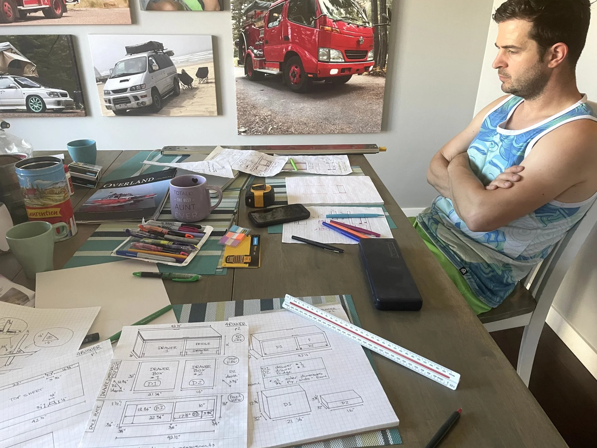

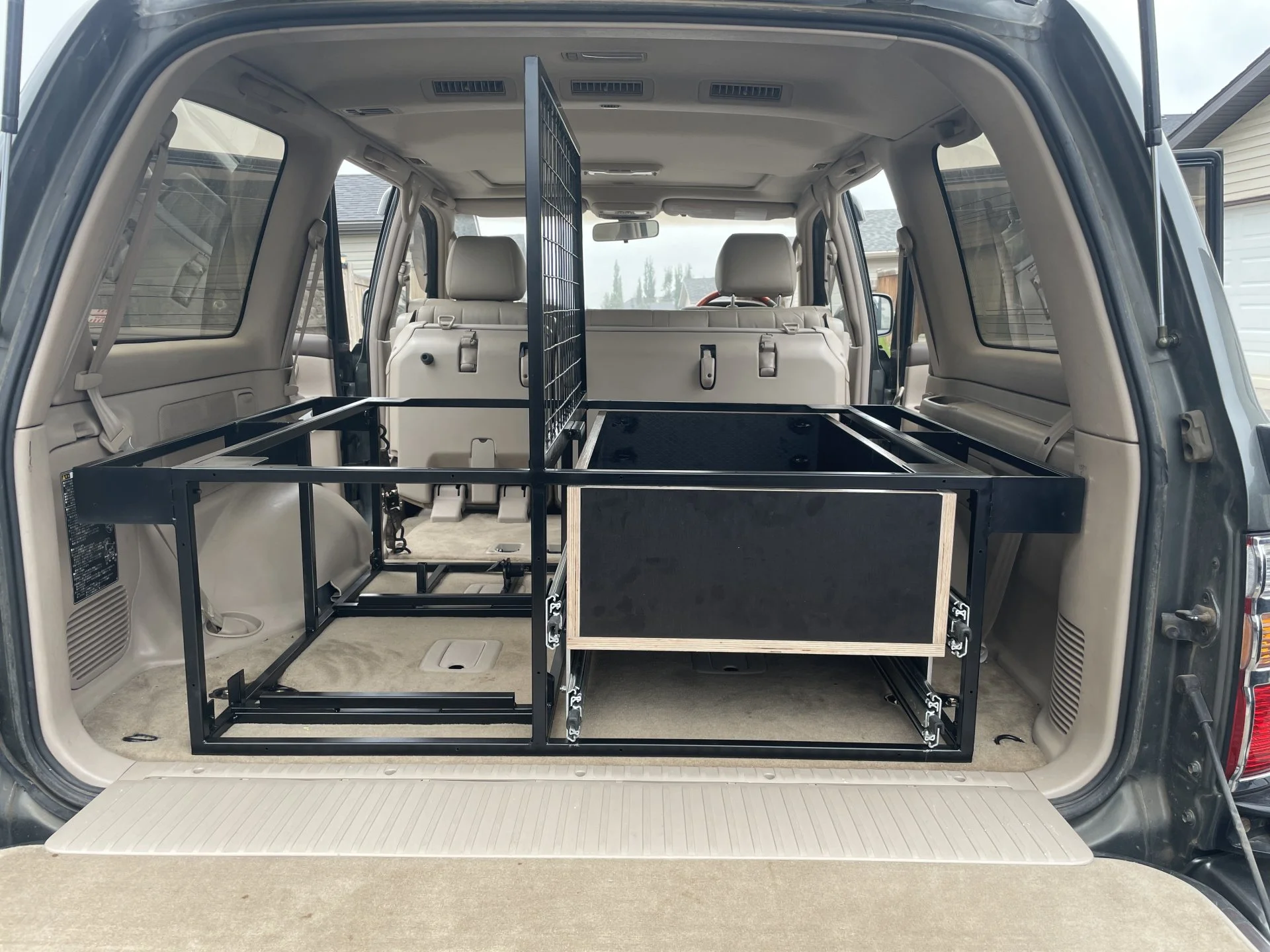

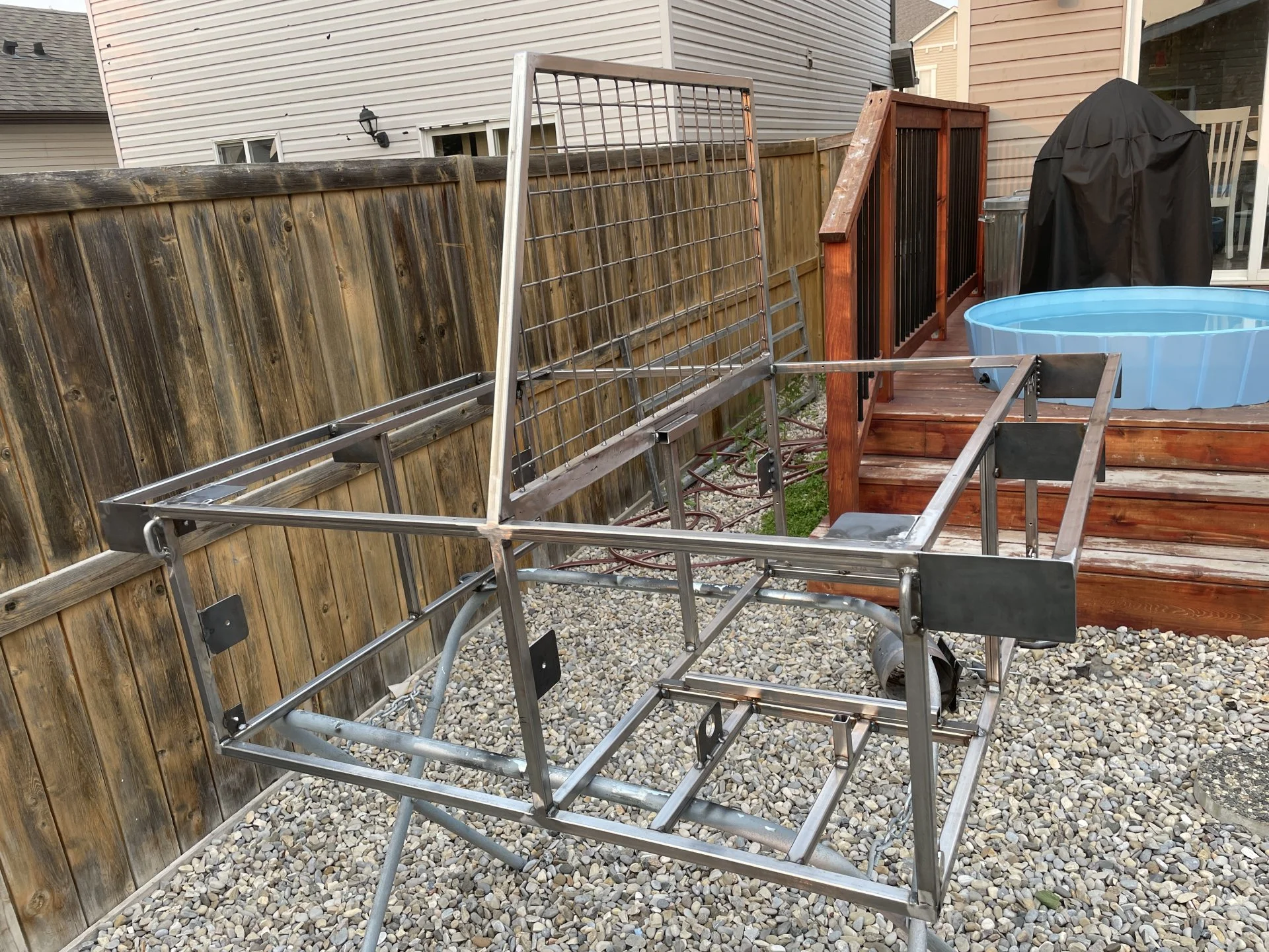

I made this last kit, from inspiration from a few directions. Dave from PullKitchen, for general stacked slides. OB0000 for his rear platform general shape, and the fridge drawer must have. Trekkbox for the vertical divider, but I wouldn't do it again...may even remove it for a track inlay. Plyguys UK for their usage of Heksa Ryga Phenolic veneered Baltic Birch ply (they never tell anyone what it is, or where to get it, but I figured it out anyway).
So, it's a simple storage / platform.
We warm weather camp, and sleep in our branded wedge RTT.
The Dometic 30, was unavailable, only came with a manual thermostat, no compressor shroud, and five times the price of our Alpicool D30. So, if you want a D30 in North America, we are the only vendors. www.bjlanders.com. Bluetooth controls, included shroud, and fraction of the price.

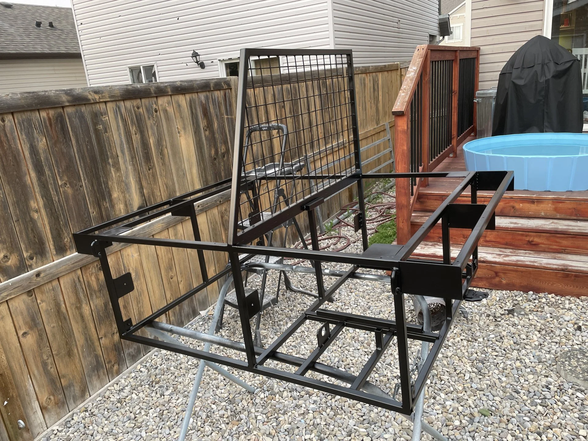

The frame is 3/4 tubular steel. The concern over any rust was moot, as we don't live by any ocean, and we don't sleep in the cab.
The slides were as heavy as available, as we used a grade down previous, and just felt they were a bit suspect. both slides extended fully, I can sit on the end, and the cruiser's suspension compresses.
All the panes are 3/4" BB, and they were all cut via a CNC bed. Some final tweaking / routing was done by hand.
A single 100 watt HTFE flexible panel is on the RTT, and charging of the 'house' sealed AGM battery is done via a Renogy 30a DCDC alt+PV controller. All it runs is hatch lights, fridge, and accessory plug for water pump. Fridge draws 24 watt max, 1 watt min.
Things to change; No divided and grid. 1/2' on the drawer carcass to scrub some weight. Powdercoat the frame.
Took two days, to weld, paint, assemble, and install. I had just completed one for a Four Runner, so had it all planned out already.

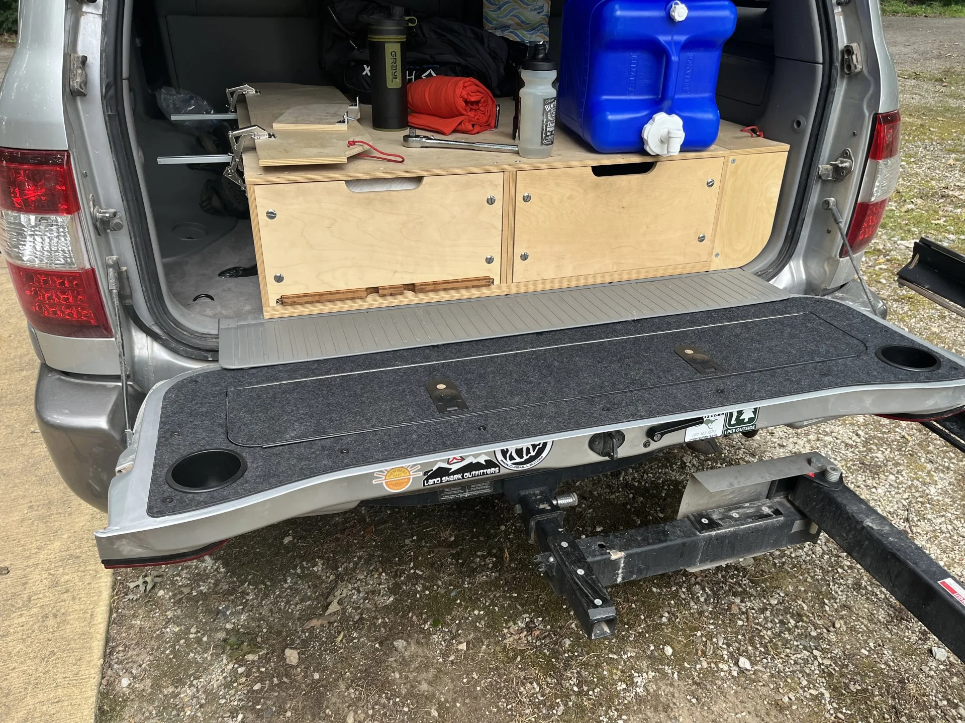

If your drawers are bolted in consider cup holders in the tailgate. If a latch cable/sheath breaks you are f***ed. Cup holders act as excellent access panels. View attachment 3073566

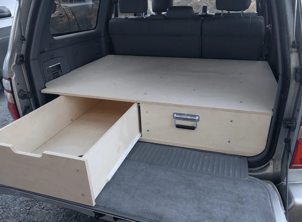

If you can cut a reasonably straight line with a jigsaw then you can build one like Landshark offers via the DIY route. I built mine but only because Dave wasn't taking orders at the time and I needed to get something installed. I don't think ADGU had a 200-series drawer system at the time (IIRC it was released right afterwards, but I could be mistaken and had just missed it). I have a parts list around here somewhere, but in the end it was about $500 in material all-in, plus probably 20 hours of labor (though I'm slow careful and methodical). A good set of drawer slides would add another $100 or so.
I noted in the thread but I'll re-state it here though, the UHMW slides are ok for light duty, but I have 100# or more in the drawer and it's a serious challenge to slide it out. I like the UHMW slides because they give a bit of extra space, but even now I'm still inclined at times to try to figure out how to retrofit normal slides. (I think I could do it with bottom-mount slides, but I'd lose the awesome slide-out table...)
