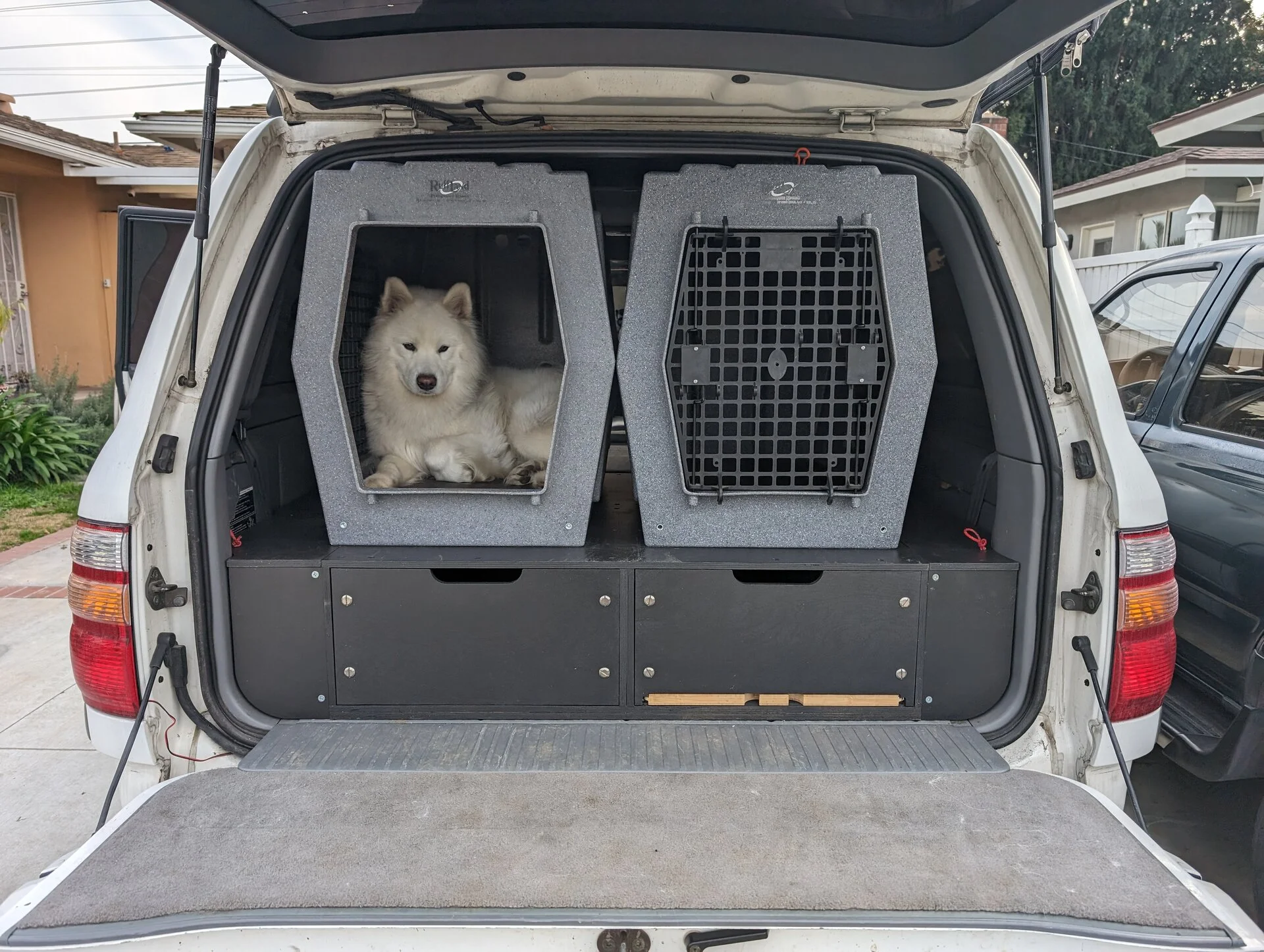

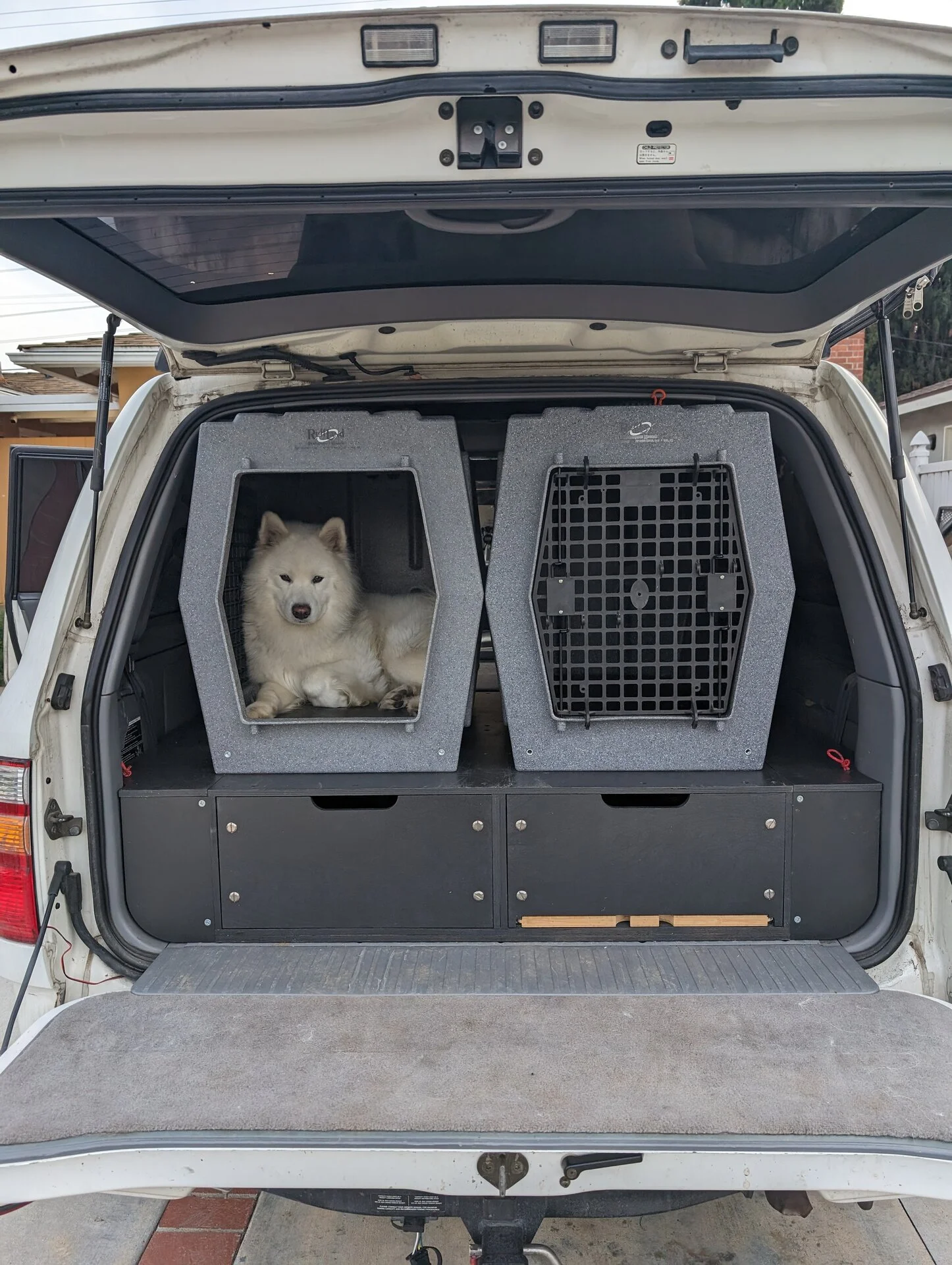

This was my parts list in ~April 2021. Lumber costs were astronomical at the time. My cost was $472.76, not including the 12V outlets I added, but the parts that are required to build a reef drawer was more like $300-350. I don't have my cut sheets for the plywood but I used pretty much all of one sheet and a portion of a second sheet - if you were doing two drawers you probably would need 3 sheets total, not 4. (And probably 3 yards of carpet).
Reef-equivalent partsSellerCost
(2) 4x8 sheets Baltic Birch BB/CP plywoodMenards$ 139.97
20-series and 10-series extruded aluminum railstnutz.com$ 81.95
1" UHMW tapeAmazon$ -
countersink drill bitsAmazon$ -
60 tooth circ saw blade and 20 TPI jigsaw bladeAmazon$ -
(2) 270 degree hingesAmazon$ 30.58
1/4"x4"x48" UHMW sheetAmazon$ 22.52
(2) M6 x 60mm, (1) M6 x 50mm flat head torx boltsBelMetric.com$ 10.00
Husky 600# cargo tie-downs, flanged 6mm T-nutsHome Depot$ 10.00
m5/m6 screws and t-nutsAmazon$ 45.66
Subtotal$ 340.68
Extra parts
(2) paddle latchesAmazon$ 20.04
tie downs/boltsAmazon$ 15.00
2yd x 80" Carpet (Superflex medium neutral SF2015)Albright's$ 52.72
DAP Weldwood contact cement + 4" brushHome Depot$ 44.32
$ 472.76

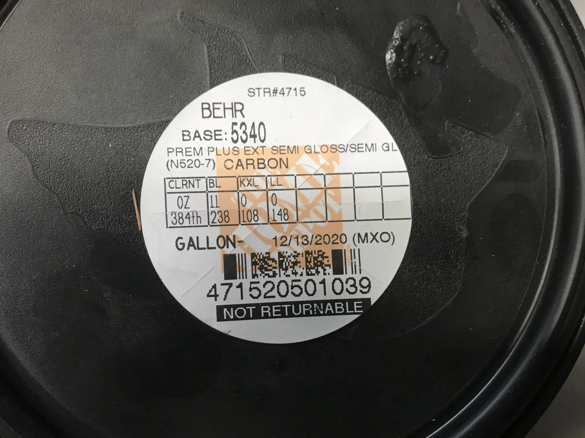

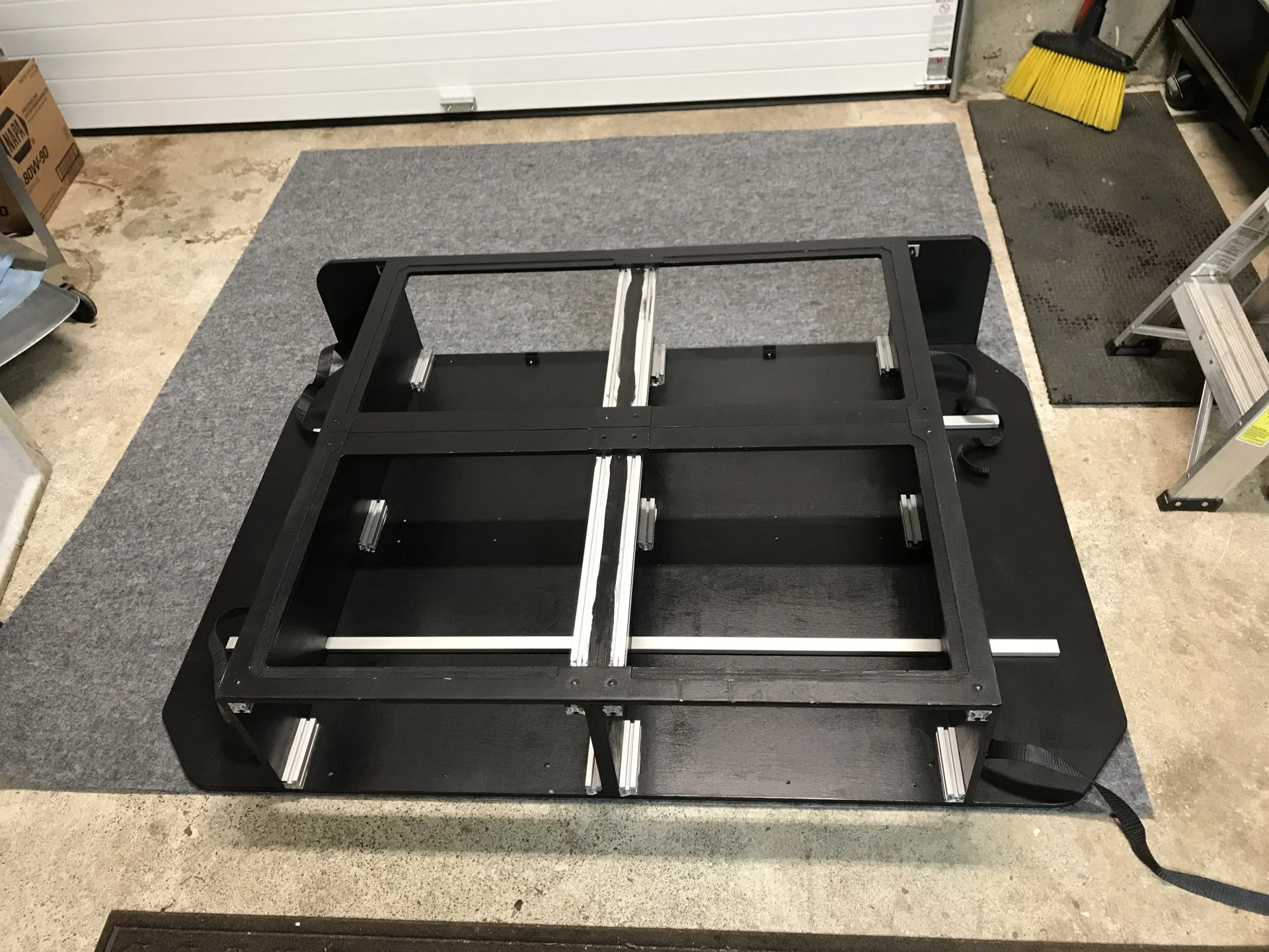

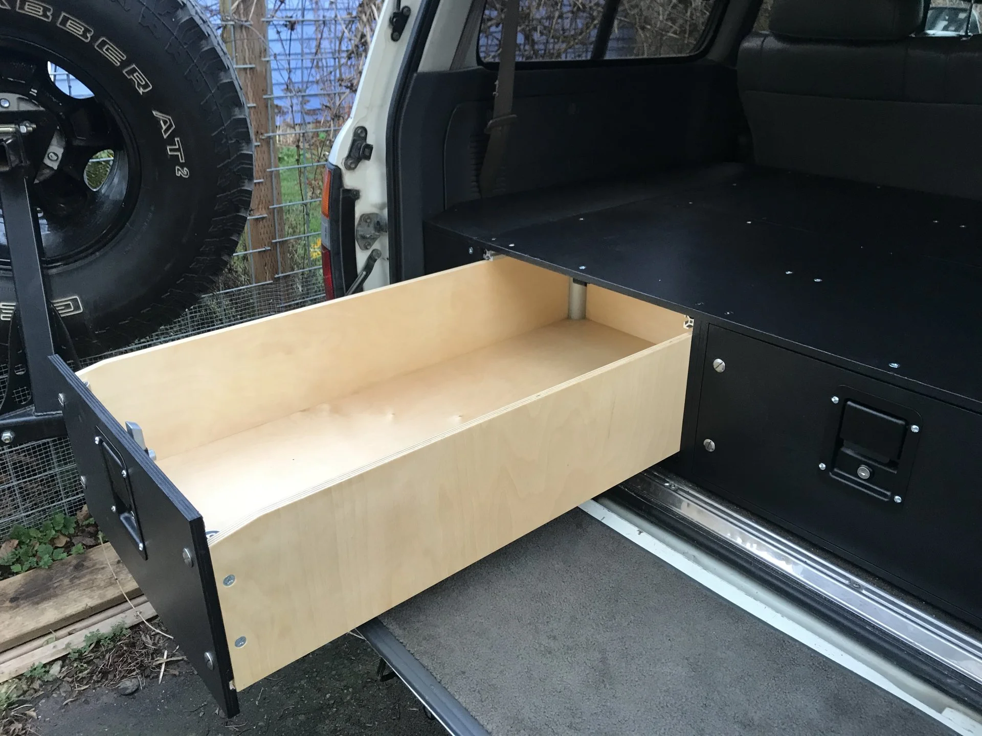

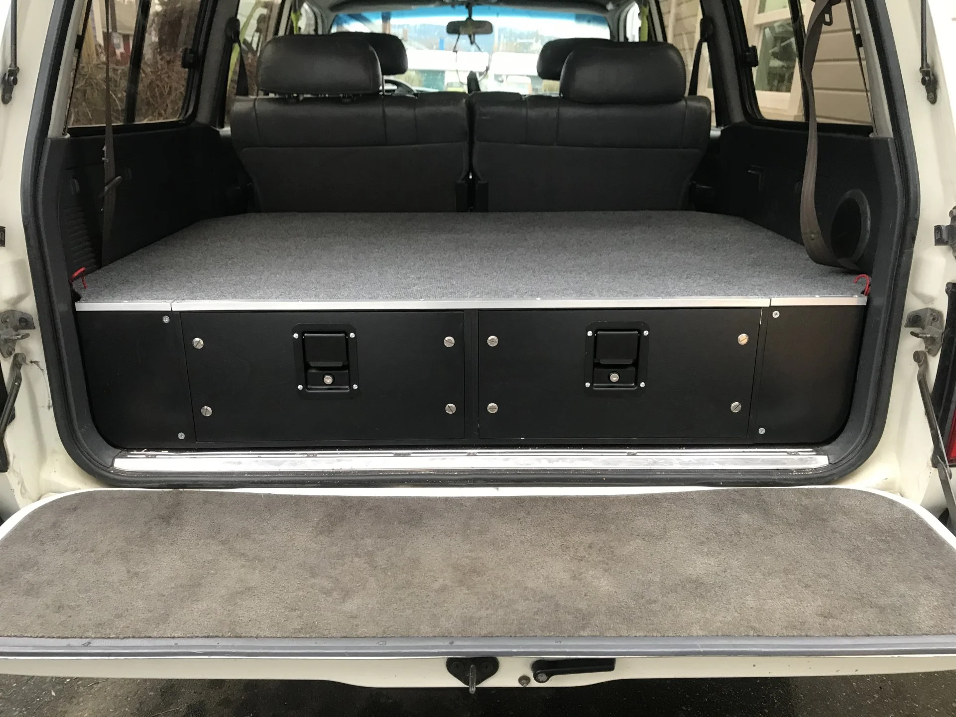

I finished mine with black exterior paint from Lowes. I rolled it on over primer after sanding to 220 with a ROS. I painted the outside of the case and drawer fronts. I finished the drawers in clear shellac, because it cheap, durable, and easy to reapply. I kept the drawer interiors bright this way. The inside of the drawers got some cheap tool box liner and a second layer marine carpet. I decide not to glue these in. It’s easy to clean this way and will be easy to replace if it gets ruined.
Laying out carpet, but shot shows case painted. Two coats and it was good to go. I removed wing supports and hardware, I taped the aluminum bits. I didn’t paint before assembling since LSO says it may make fitting too tight.
View attachment 3029704test fit before carpet. You can see the drawers are bright.

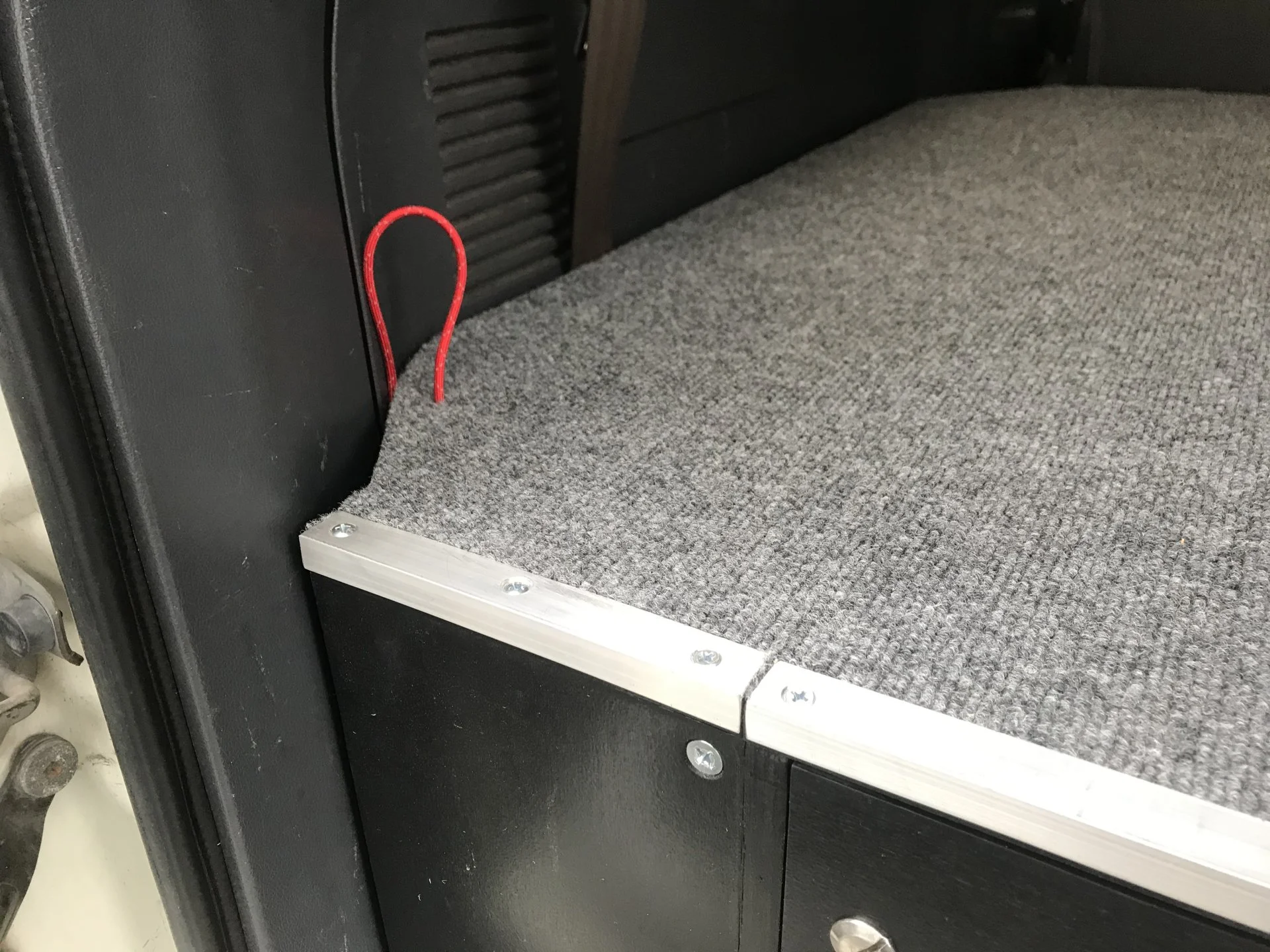

Carpet edge is aluminum L track from lowes.
It’s easy to touch up, I just use a black paint pen, or a sharpie.
Paint code.
Thank you for posting this information. I went the same route.

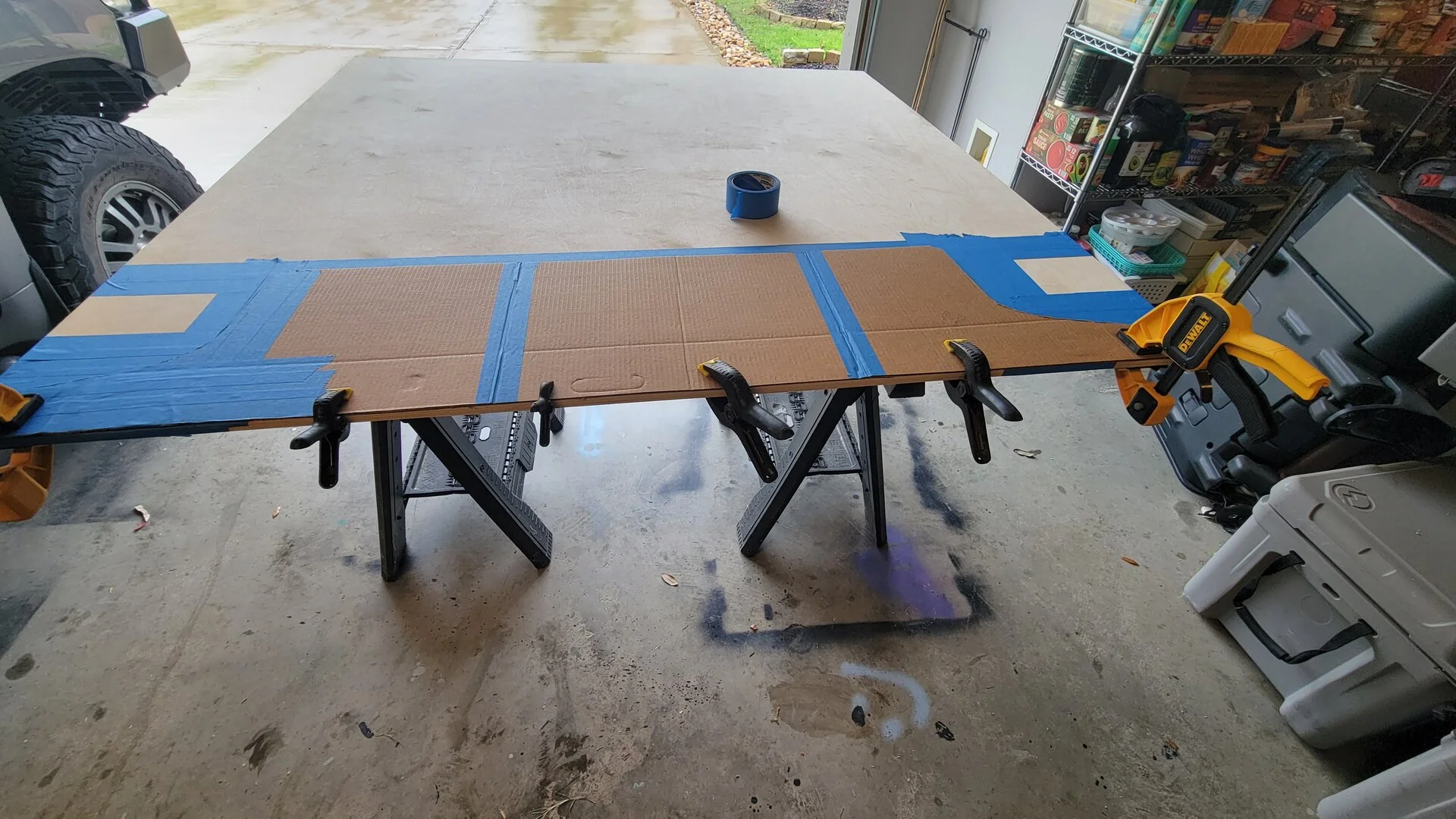

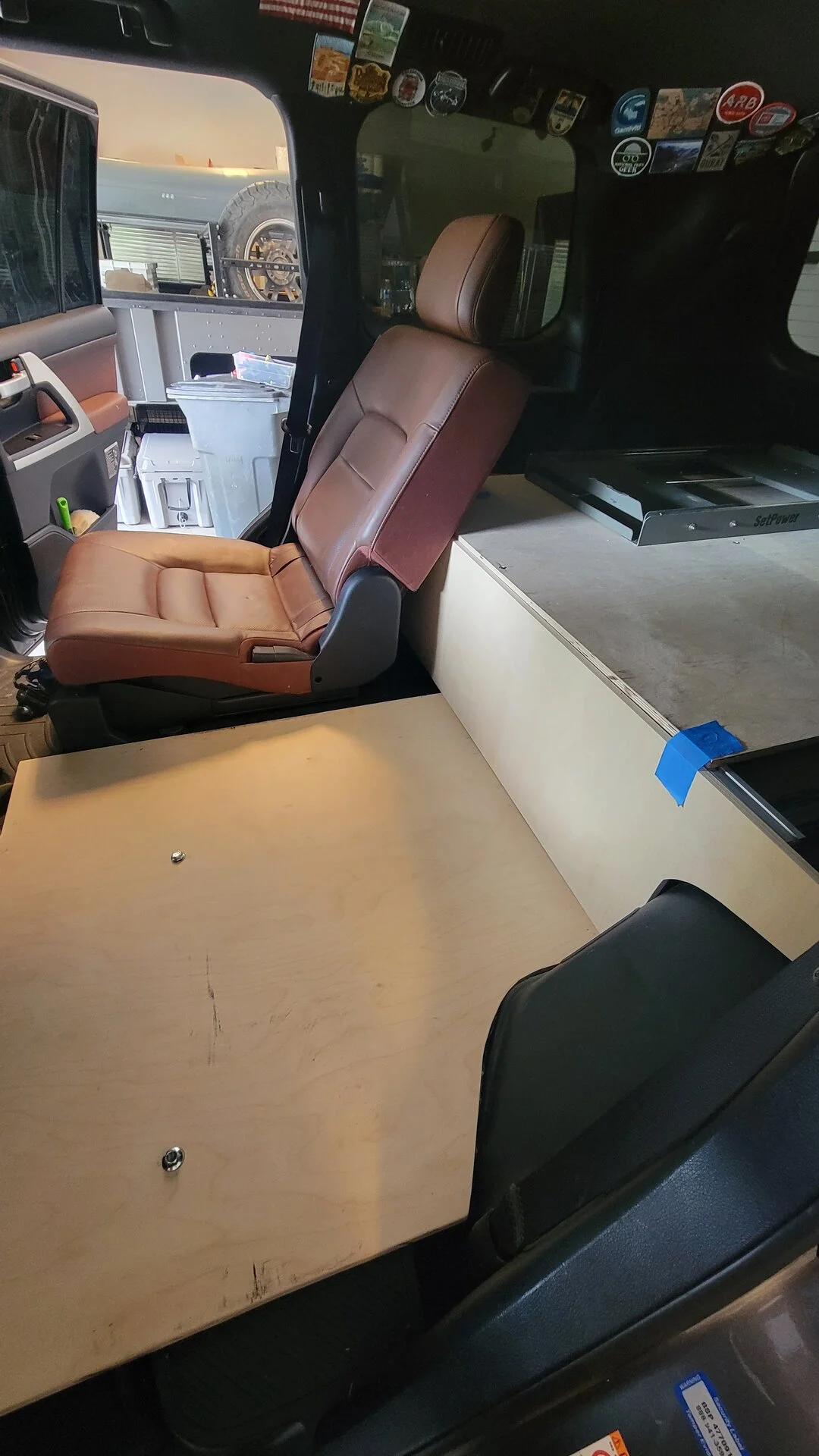

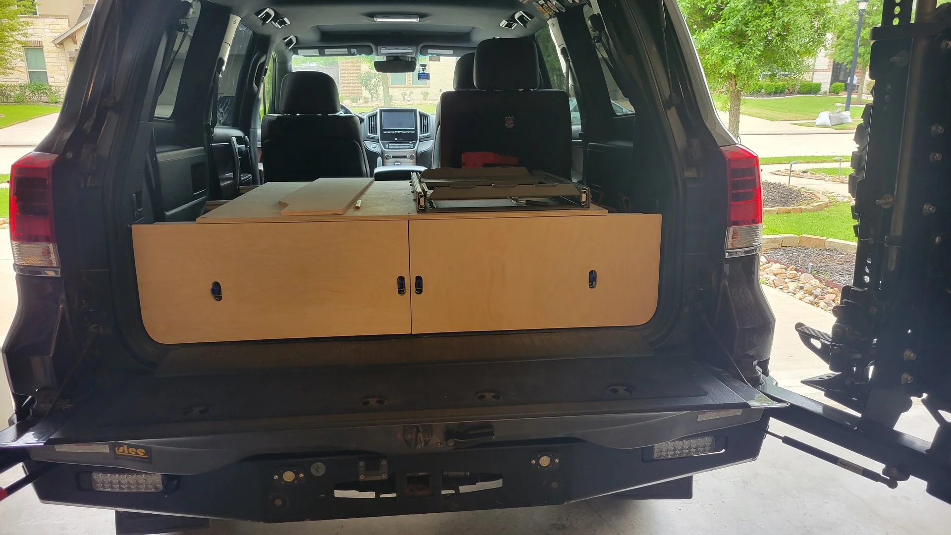

Yep and yep...in final stages of my drawer build before moving on to the second row storage. Measure, draw it out, measure again, then cut out the cardboard, trim, test fit and measure again before cutting your wood. It's been fun and I'd definitely do it again.

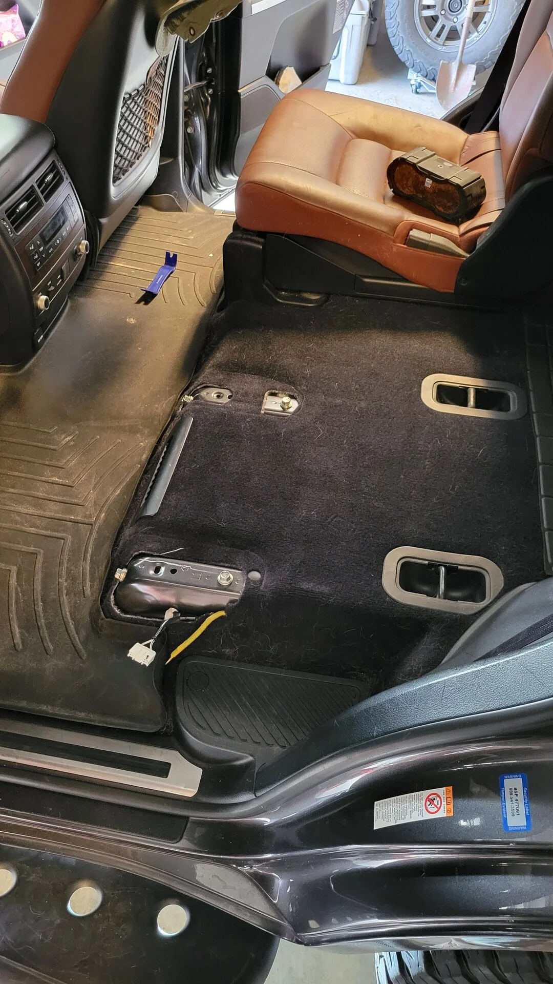

What was your attachment method at the front of the second row mount? I am doing something similar but with the larger seat in and the smaller seat removed.
Those are the mounting bolts for the seat. The other 2 are in the front near the floor board. I think I have a Pic of both...
Also this is on a 200. Buddy has a 100 that had a similar bolt location.
