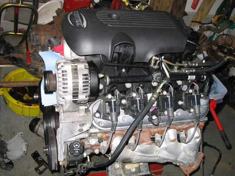

I got one corner broken down and cleaned up today, as well as stripping my new-to-me 355 Chevy bare. Won't be doing a rebuild on it, just cleaning it up, new seals, and possibly new heads.

Mmmm... power. 295hp/330tq stock, should be ~320/360 after the PCM tune.

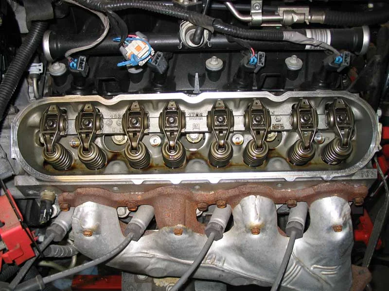

Nice and clean under the valve covers too.. 55k on the motor.
Yeah Jack.. Medusa for SURE!!! Can't wait to get this thinned out..
