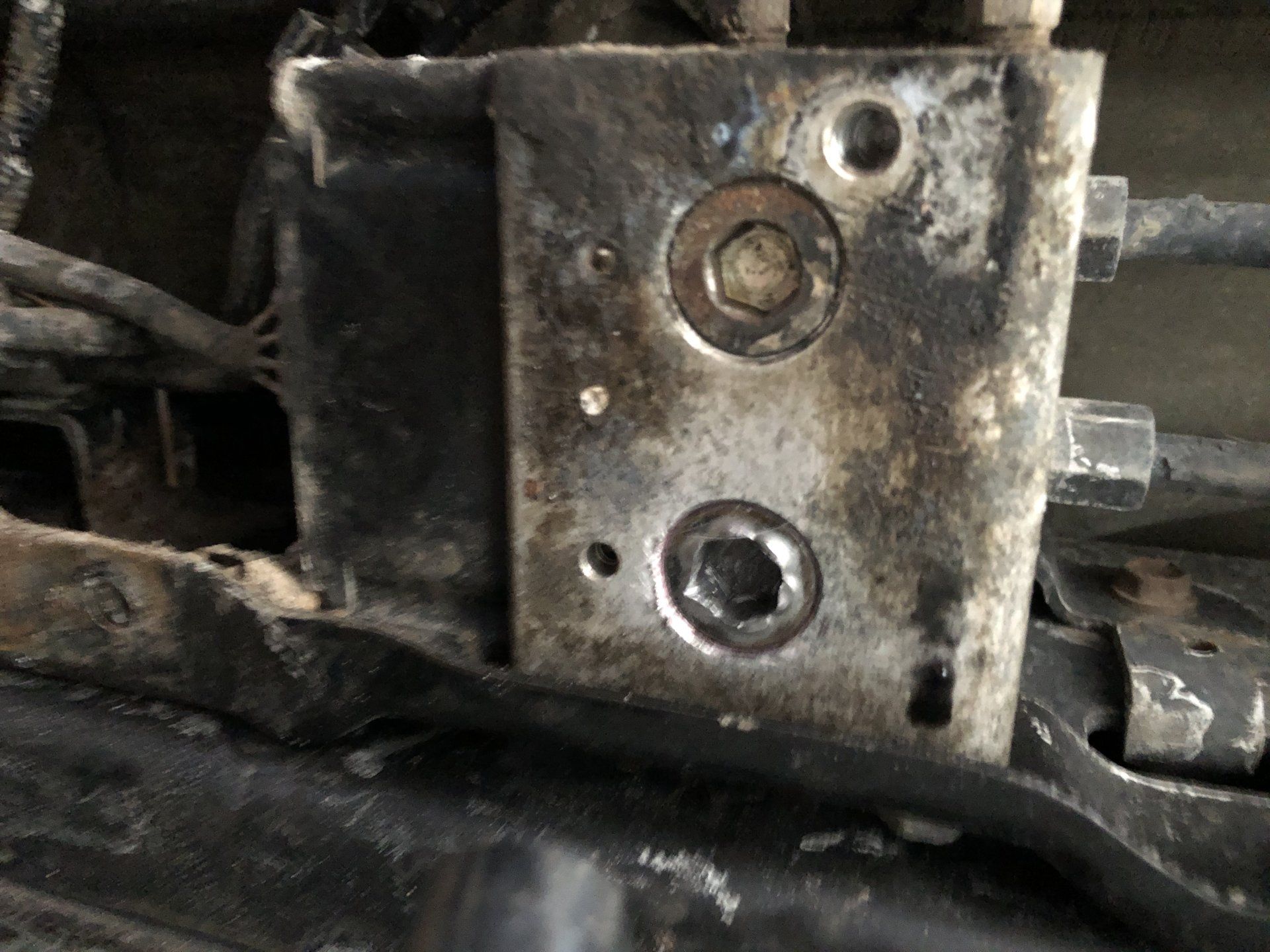

First post here but I’ve been reading through the forum extensively. Thank you all for the valuable information. I recently purchased an 05 sport gx with KDSS and I’ve been going through the basics before I install a small lift and other upgrades.
I installed the Metaltech stage 2 spring conversion kit with Moog 81081 springs a few weeks ago. I discovered the KDSS shutter valves were buried in road sand and whatever else they use on the Colorado roads. One of the valves was gummed up and I’ve only made it worse. I’ve tried AeroKroil for the past few weeks trying to loosen the valve with no luck and it’s stripping the more I try. Today I took an 11mm hex bit and filed it down to fit but still no movement.
Are there any suggestions on how to break it free? I’d love to find a solution that doesn’t involve taking it to the dealer for a replacement valve and to have the system re-pressurized.

That looks quite corroded so I would hit that with some PB and consider welding on a nut.
That’s what I’ve been thinking. The metal for the set screw seemed soft and I have no experience with wedding so I wasn’t sure if that was an option.
Welding a bolt worked. Had to go pretty big, first bolt sheared right off but it’s done. I can finally get going on ordering lift components and install the new stabilizer bar bushings.
