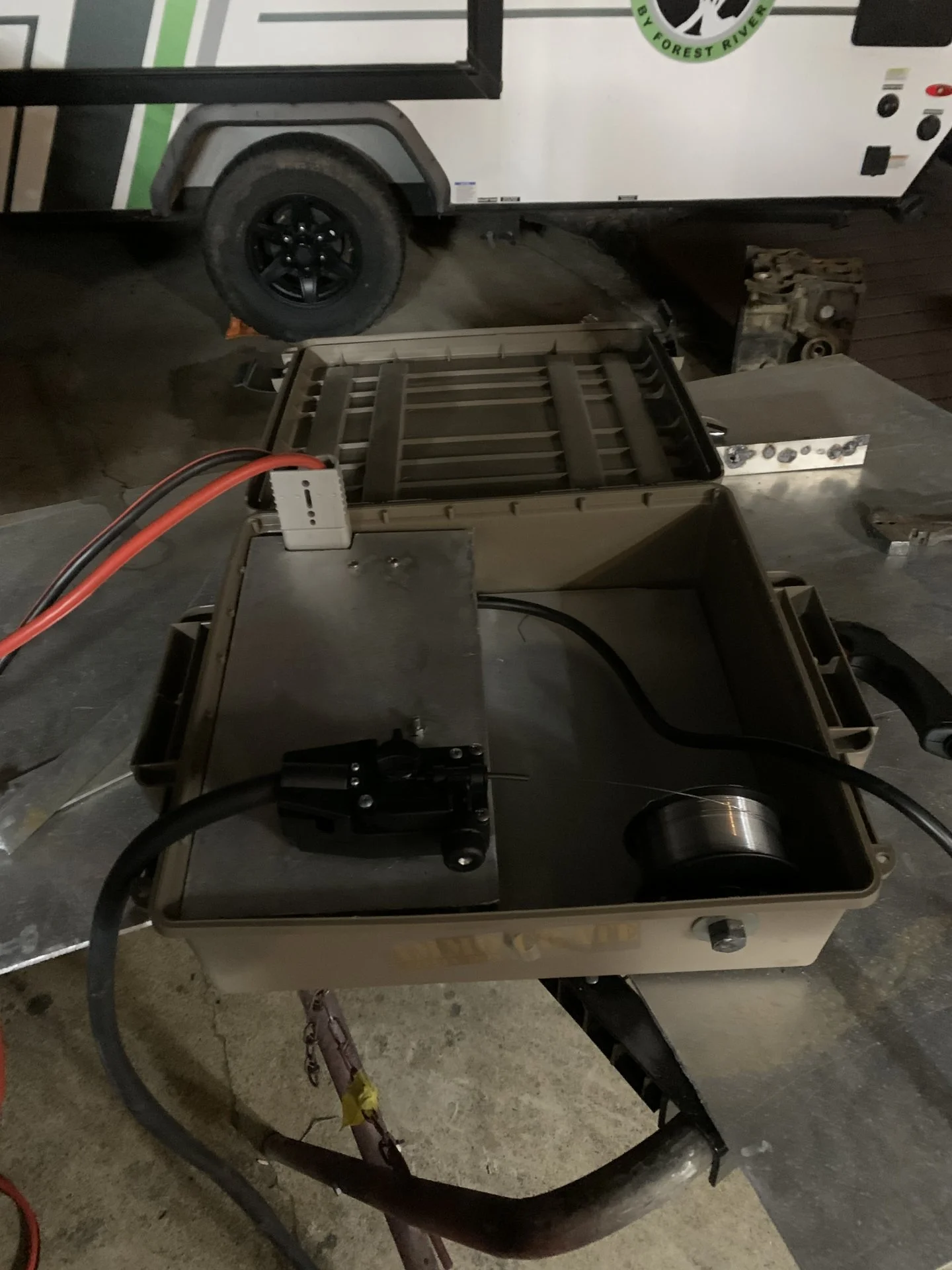

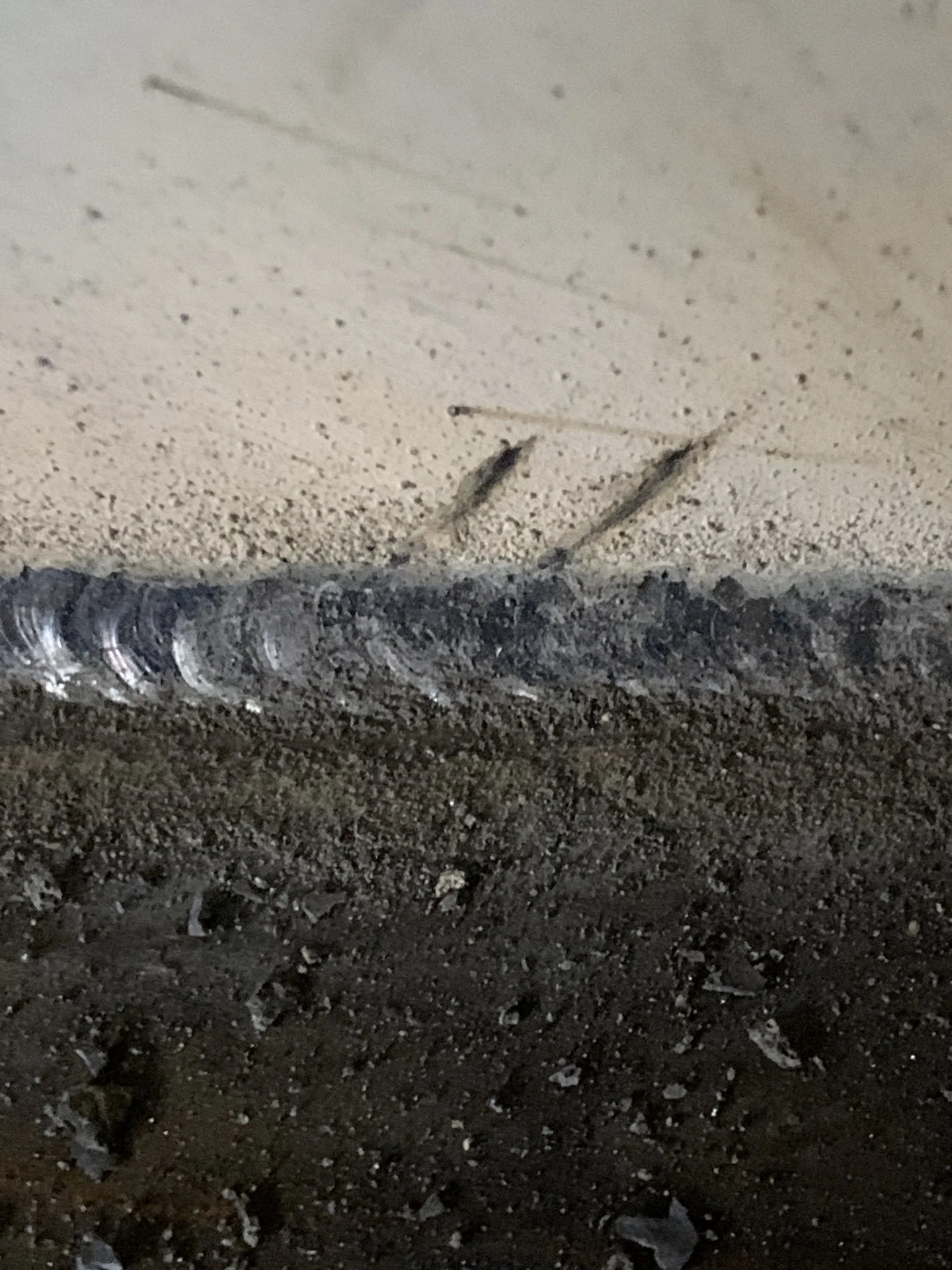

I just finished and tested my flux core mig trail welder. Works off two car batteries and runs .035 flux core. Total cost was about $230.00 with parts bought off Amazon.
Awesome looking
Is the wire speed adjustable?
