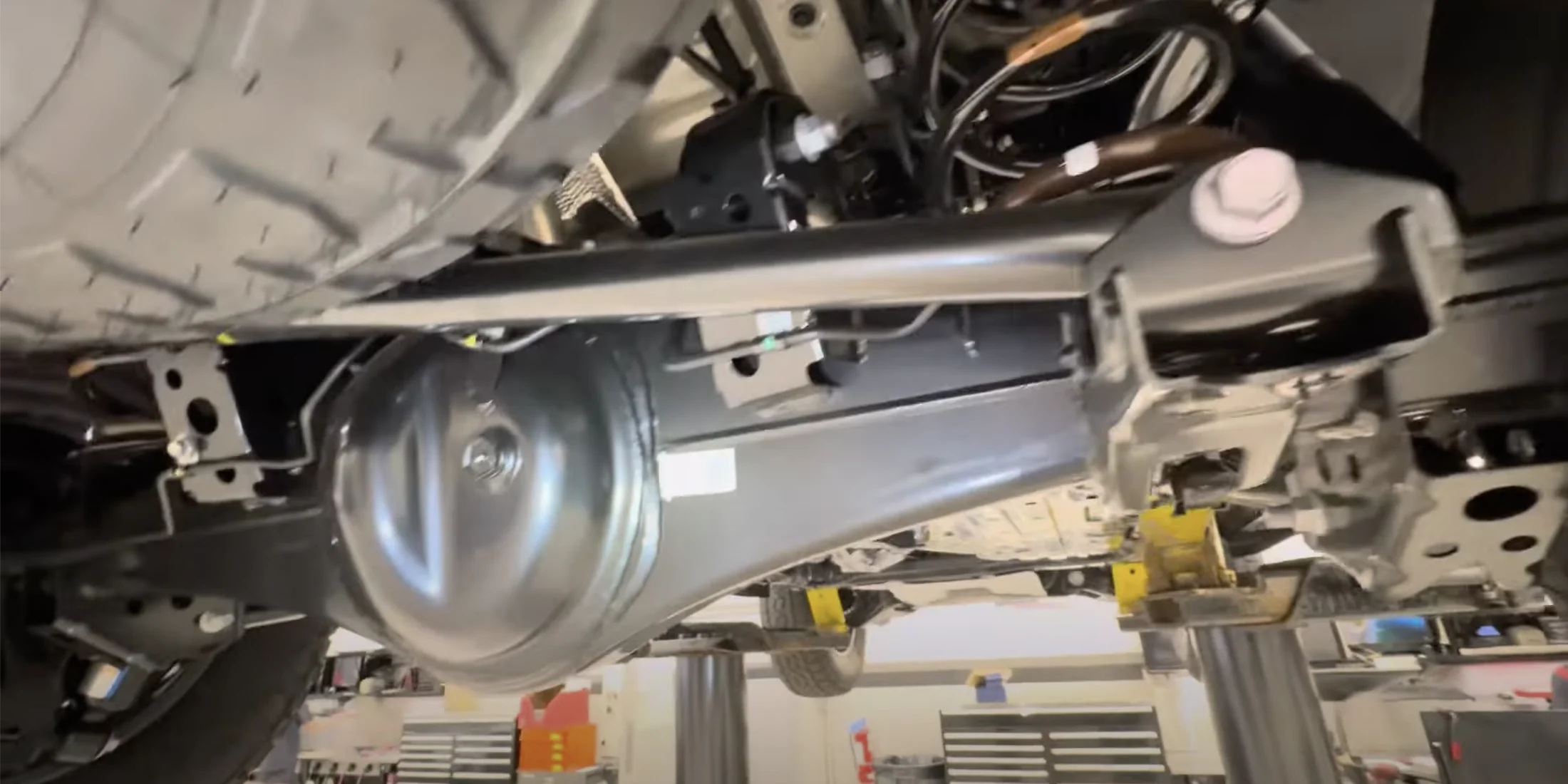

The jury is still out for me but I've been taking mental notes. The size of the 250 is certainly a positive aspect in my mind. But on the negative, there's a lot of minor details that makes me go, hmm.
As mentioned in the video, the rear shock mounts and control arm mounts are less robust.
Also mentioned is the steering arms are way less beefy than the 200. The steering rack is electric... which time will tell but the latest LC70 and LC300 still use hydraulic racks. Does the new 250 have a more robust steering rack than the flagship 300 or the industrial 70? 🤷‍♀️
The CV's are quite small. The upgraded CV's for the 250 is from the Tacoma? Hmmm.
The 8.X" rear differential is smaller than the 200. The GX550 has a 9.5" differential but the rear axle is more "trussed" in a manner that reduces ground clearance. You can also see the 5 control arm mounts and compare them to the 200. Minor details but it "looks" less substantial. Look at the panhard and the LCA mounts, they are welded on all sides, not leaving one side open like on the 250. Does it matter? I dunno but it certainly is easier to overbuild than to engineer to the exact need. The LC250 front LCA strut mounts are single shear vs double shear on the 200. Do they really need to be double shear? Maybe not. Or maybe only needs it if the vehicle is 500 lbs heavier!

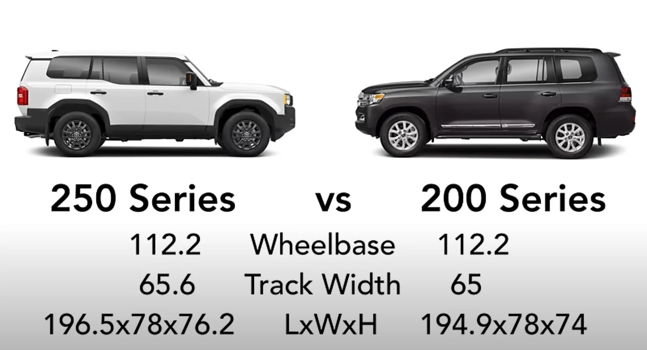

Didn't realize 250 was almost the same size as the 200!
I am not sure on the source for this info or the criteria they used, but I have heard this before (250 same size as 200). It is a real head scratcher when you visually see these two rigs side by side. I have seen them side by side now more than once and I can't for the life of me see the 250 the same size as the 200, let alone bigger. It looks narrower, shorter and smaller lengthwise. I do not know...maybe it is an optical illusion.
On a separate note, this comparison is also not appropriate. The PRADO 250 compares with the PRADO GX460. We should compare the 200 with the 300. It doesn't matter we don't get it here in the US.
It’s the wide fender flares on the 250 which from a dimension perspective (let’s say you’re trying to fit it in a shipping container to ship) would have to be accounted for. The rest of the body was slimmed down from a width perspective though.
