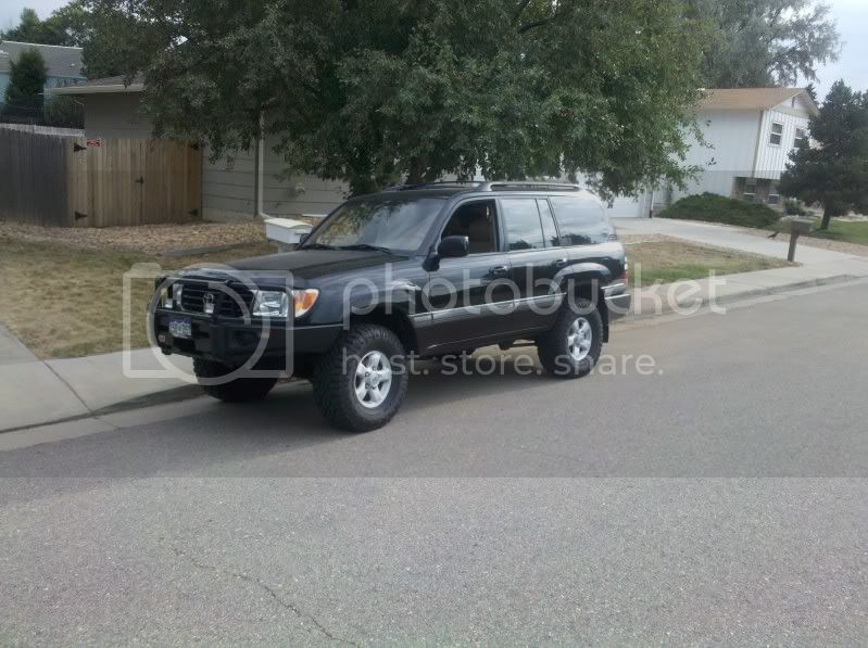

Same boat here. Driven very little....driven off road even less! Not by choice, mostly due to work schedule and not getting to play during the daytime on weekends like most normal folks.
Added Slee 30mm spacers, and re-indexed the OEM torsion bars to bring the front up after adding the ARB (which was purchased courtesy of my insurance company after a fender bender, otherwise I wouldn't even have it!).
All told I'm sitting at about 1.5" rear, 2" front (maybe a touch less now as the t-bars probably settled some). With the 285 DTs the stance is pretty good. I have OME 865 springs sitting here waiting to go on, but I need to reboot my CV's before going any higher in the front. Diff drop would probably be a good investment too.
Pic from last summer when I still had 305s....*sigh*.
More recent (285s):
