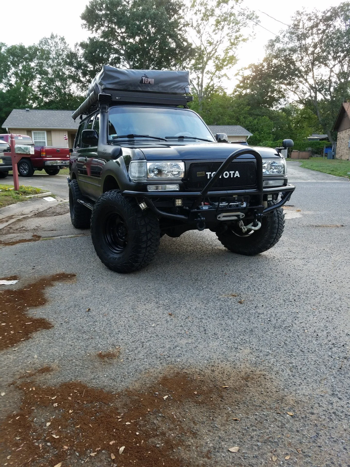

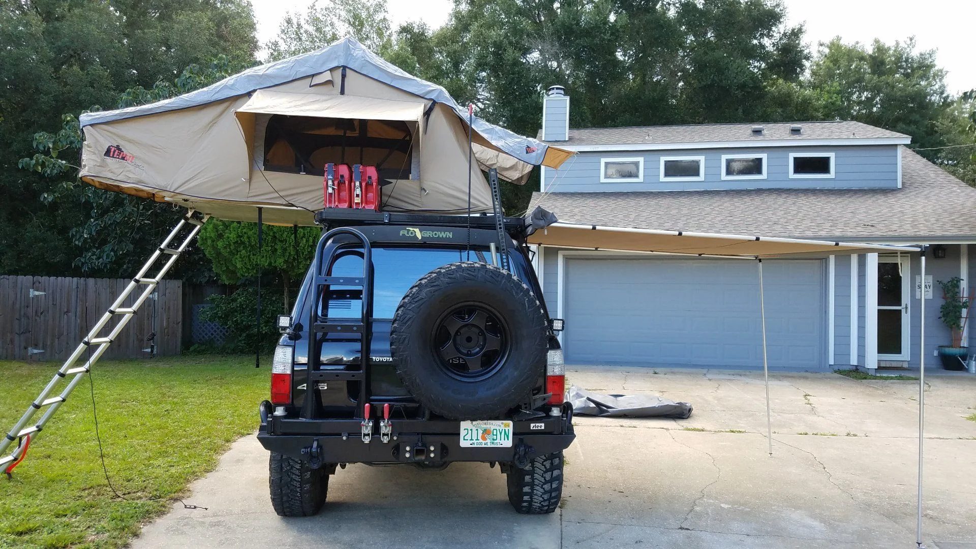

Hey there! Sounds like you're not new to 80's, just this one. I can't claim to have a ton of experience but I do have some of the items you're asking about.
1.) Rear bumper with swing-outs: I have the older Slee bumper which I like quite a bit. I'd consider the new one if I were in the market but I like what I have well enough. Very solid. Looks good.
I also have a Metal Tech front bumper. I like it but I guess it depends on your taste and what you think looks good.
My roof rack is Frontrunner and I have been very happy with it. Its solid and its easy to attach things to because the extruded rails can have any number of attachments or custom brackets bolted to them. Holds a RTT just fine. I even drove into a hole big enough to swallow the cruiser (long story, poor judgement, enough said) and the roof rack didn't show any damage even though it was loaded at the time.
Nice ride. That Frontrunner roof rack looks like it can hold a lot and some. How high is the lift and what do you have in it?​
The lift is approximately 2.5". TJM springs in front, OME heavies in the rear, and TJM gold shocks on all four corners. Full disclosure, I didn't do any of the modifications that you see. I bought the truck this way. I do work on it myself and I have done mechanical repairs and maintenance but it looked pretty much like this when I got it. PO had a pretty good aesthetic eye so I've been happy with most of what he did.
