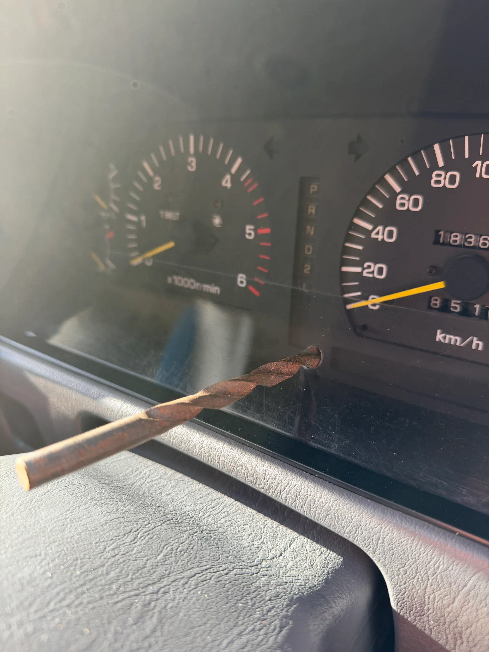

Does anyone have a source for a Reset Stem Knob for the trip odometer?
My detail guy wiped it out of existence the other day and I’m having a hard time sourcing one.
I need both the knob stem and rubber grommet.
See the pic of where it should be and the 95 turbo diesel it belongs to.
Just to confirm, you're looking for the grommet that goes in that hole to the left of the trip reset?
The grommet only comes with the clear glass assembly which is still available from Toyota: 83134-60120
The stem is only available with the speedometer assembly which is discontinued from Toyota. Only available used or NOS from the Middle East.
Post a classifieds ad in the classifieds section of MUD.
Yes. The rubber ring and the stick that goes through it
The hole in the middle doesn't have a stick, it has a grommet that you remove to reset the timing belt counter/indicator
