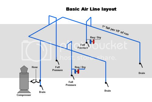

The main theme I took how was:
Use copper, use at least type L. Copper won't degrade/rust, has a smoother inner wall for better air flow and allows the air to cool faster/better than other materials
Make "drop's" with a drain at each drop, taking the air above area that will collect water. This way, you will be able to pull as much water out of the air as possible before getting to your tools
Here is one crappy illustration of what I'm talking about
You can see that at each drop with a regulator/filter, they have a drain at the bottom to allow you to drain off the water that will collect at the lowest point.
This how I did mine, a flexible hose to the main line then the first regulator/filter with a 6" tail before it with a 1/4 turn ballcock to drain the water, ran it up the wall to the ceiling, along the ceiling to the hose reel with another 6" tail with another ballcock, taking the air above it, again to get as dry of air as possible. And, repeat along the path you want to run the air.
