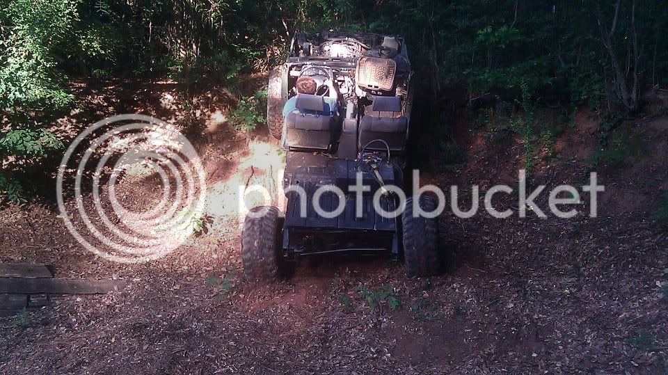

Green Mamba Extension was rough on the ole girl. At some point I must have come down on the tie rod just enough to compromise it's lateral strength. The slight bend was all it took for the assist ram to do the rest of the damage. At full force, while trying to turn into a giant boulder, this happened:
The tie rod dented the front of the oil pan and was shooting sparks from its contact with the harmonic balancer. The rod on the ram was bent, the heim on the end of the ram was destroyed, the seals in the ram blew and fluid was shooting out everywhere, the tie rod ends were hosed (they were already pretty worn), and, while trying to get it out of the rocks and back to flat ground, the truck ended up in this position:

We straightened the tie rod as best as we could (pretty fxxxing straight, actually), unbolted the ram and zip tied it out of the way, cut the power steering belt (to save time), and limped it back across town and put it right on the trailer. I came home, unloaded it, pulled it into the garage, and there it sat until the other day.
