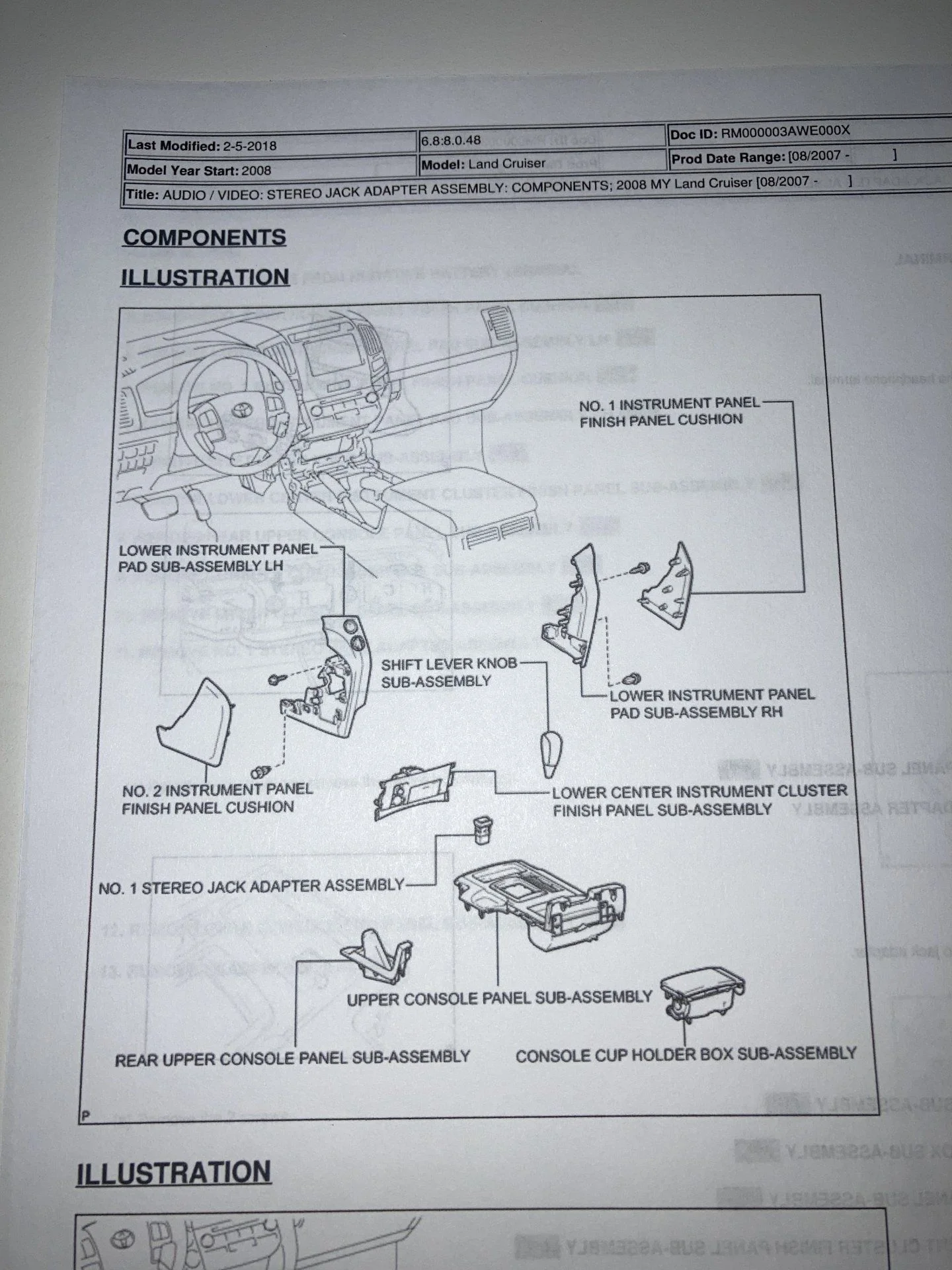

Good idea! I will try some contact cleaner and some air. If that doesn’t work, I’ve found a ton of videos about Tacomas, Tundras, Camry etc that removed the aux jack and found a pin had been dislodged and needed resoldering. Find this little bit in my factory service manual so getting it out should be a breeze!
