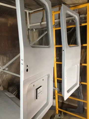

I did not know how i was going to hang parts. Then i saw this scaffold i forgot we had.

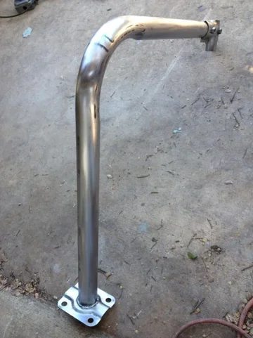

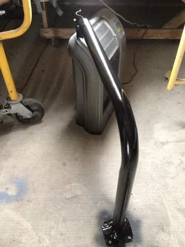

My future father in law came down Sat and Sun to help out. He stripped the roll bar for me and I primered/sprayed them.

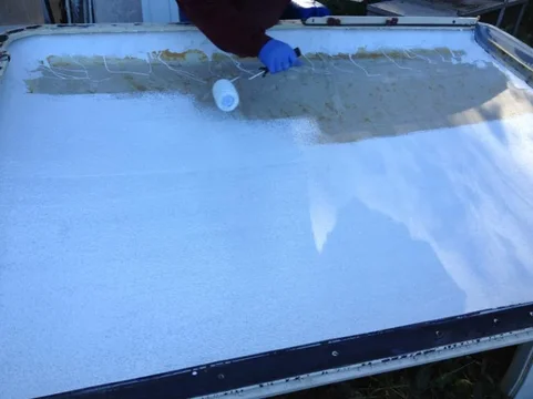

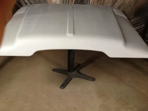

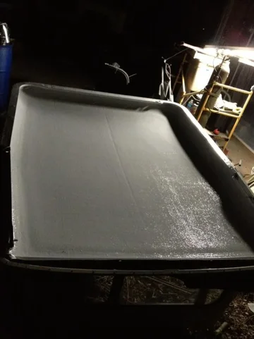

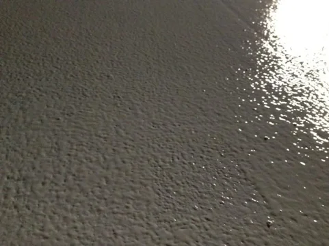

Today we stripped is and sanded the fiberglass. Then we monstaliner ed the inside white.

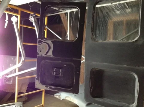

I had a few hiccups of course. I was spraying sealer and the steel beam fell off the scaffold and hit me in the neck. It stunned me for a second and I laid down a nasty run on the back corner. I had to strip it down and sand it all out to start over. Thats not easy when using an epoxy as a sealer!
Im happy with the paint job. At this point, i am just happy to see color and i can live with a few imperfections because the color is beautiful. As usual, i finish up late at night and give y'all terrible pictures. Also featured are my new quick hinges. I almost forgot to install these before i painted. This would have been quite difficult with fresh paint.
That looks great! 21 minutes is smoking. A steel beam hits me in the head and something is getting broken much less a little run. I'm glad you fixed it. I think something like that would have made me mad every time I looked at it.
I went down to check out a few things including how the paint was curing up. I was amazed at how it turned out. I am not even going to need to sand or polish.

I have the monstaliner, but lack the neccessary rollers to do finish the interior. The storm that hit new york is affecting the shipping of what I need. I feel for those guys as they are trying to get power back in their homes let alone try to meet a back log of orders. I did talk to them and they stated that they should ship out everything today.
I do have a couple of Shutz guns and with the rollers I can get every nook and cranny that I want. Nothing else is going into the interior until then. The bracket and pedals have to go on in order to install the Brake and clutch master cylinder. I can easily mask those off as I shoot liner with the Shutz gun. the interior will be lined like the underside of the tub. Any spots that dont get hit with liner have Three separate applications of Epoxy primer.
