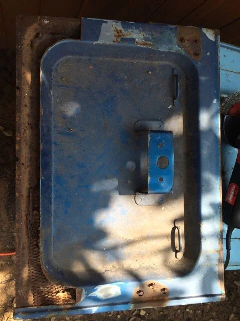

Today I head back to New Braunfels to restore a set of Barn doors that I had considered throwing away. More to come.
If there is enough time this weekend, I may even build some rear speaker boxes. Wifey is going out of town so its a matter of how many projects I can get done in 3 days!

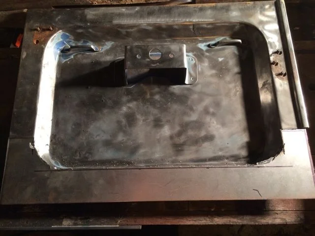

After a little wire wheeling and one harbor freight grinder disintegrating

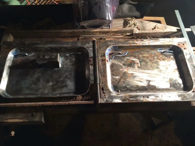

Getting closer
I hope i can finish these saturday. Perhaps thats a lofty goal.

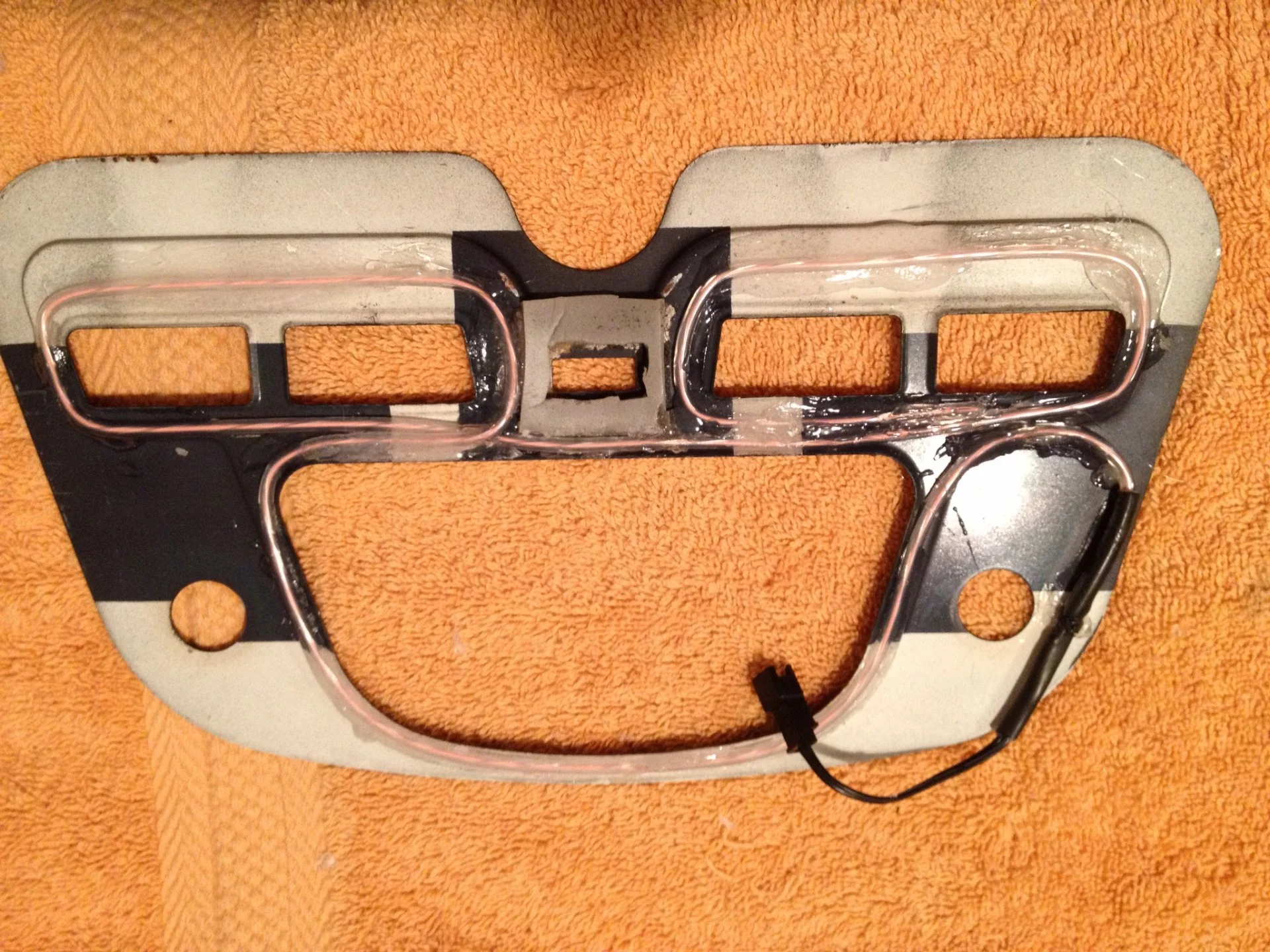

Nice looking rig and great build thread! Would you happen to have a picture of how you wired the EL wire into the back of the dash cluster? I'm assuming the EL wire turns on when you turn the lights on?
Sorry for the late response. You just resin pot it in and hook it up to 12 power that kicks on with the dash lights. There is a small blue capacitor that plugs into this and needs 12v. The little box has a slight hum.

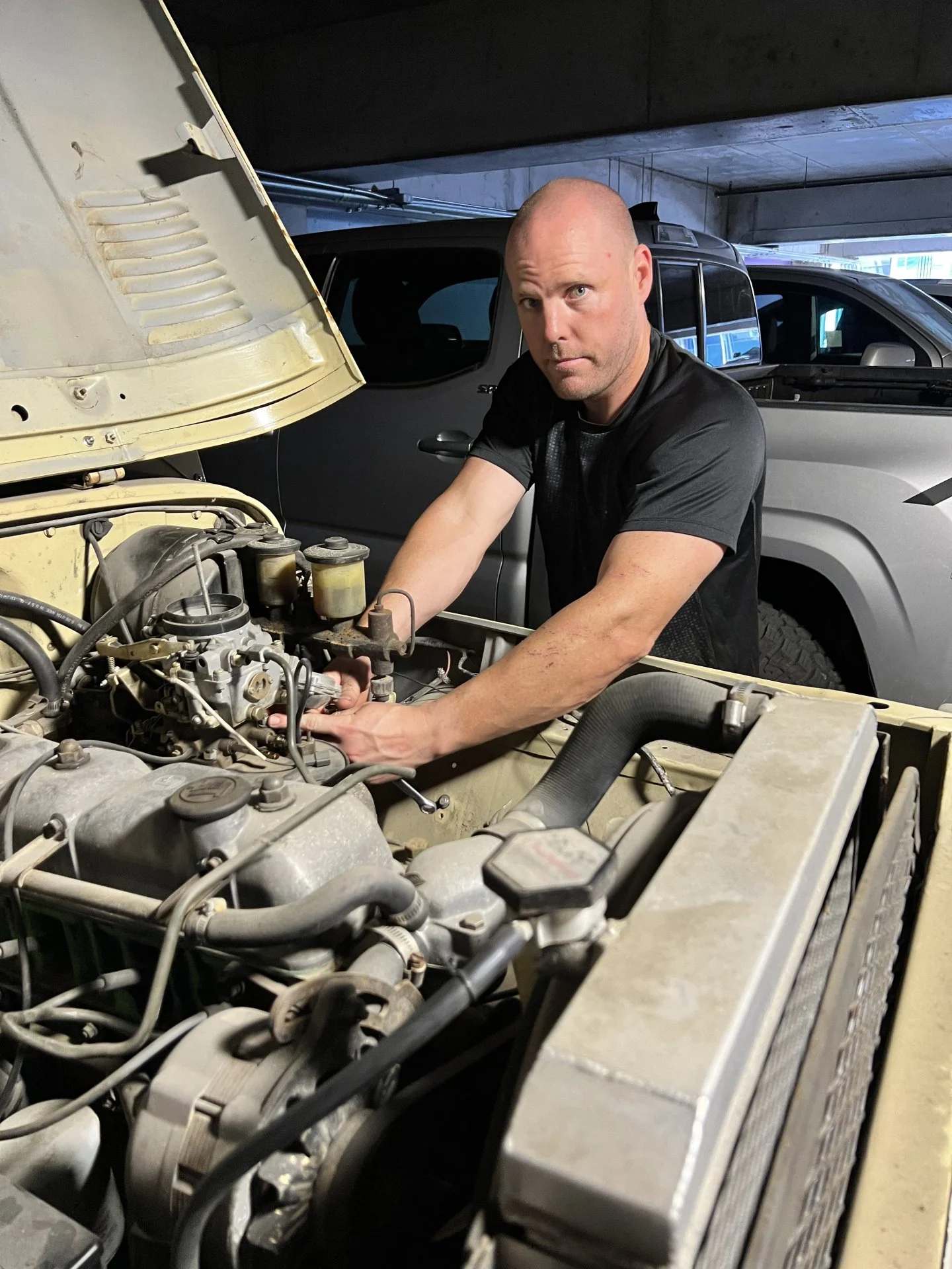

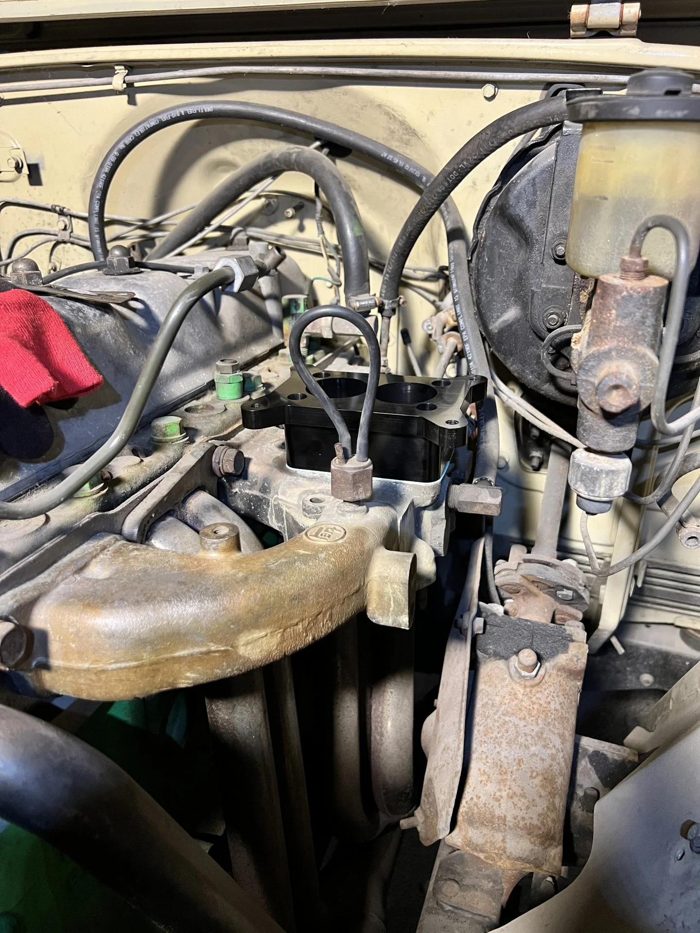

I did swap a 3.70 pumpkin in, but all of the sitting has done a number on the carb. My trollhole carb needs revival, but I’ve opted to swap to EFI instead. Stay tuned for a Sniper EFI install.

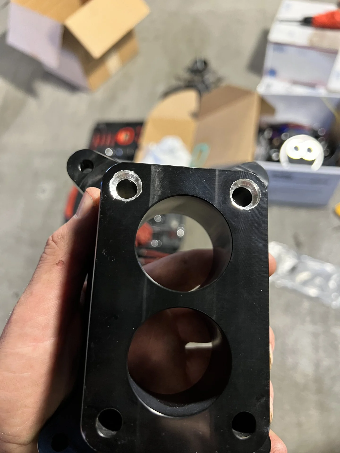

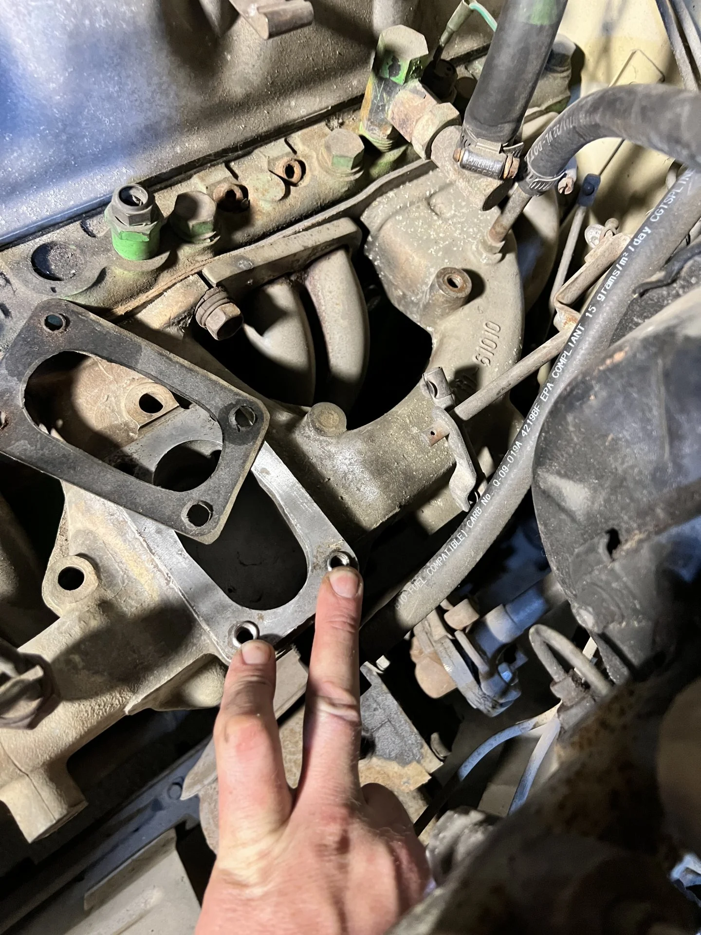

Upon removal of the carb and studs, the project hit a small road block. Some point in the last 45 years, someone Helicoiled the intake. I had to clearance my deadline cruisers adapter (which is sweet BTW)
Redline cruisers has been fantastic in this entire process. Their brackets have been a life saver in allowing me to finish this project easily in 1 weekend in a public parking garage!
I made plenty of friends and a few people now want to install snipers in their Cobras and classic Toyotas.
A weekend in this position reminded me what working on cars does to your body in strange ways. A little different than mountain biking.
Cuts on arm are from previous weekends MTB race. I tagged a rock face of a cliff pretty hard.

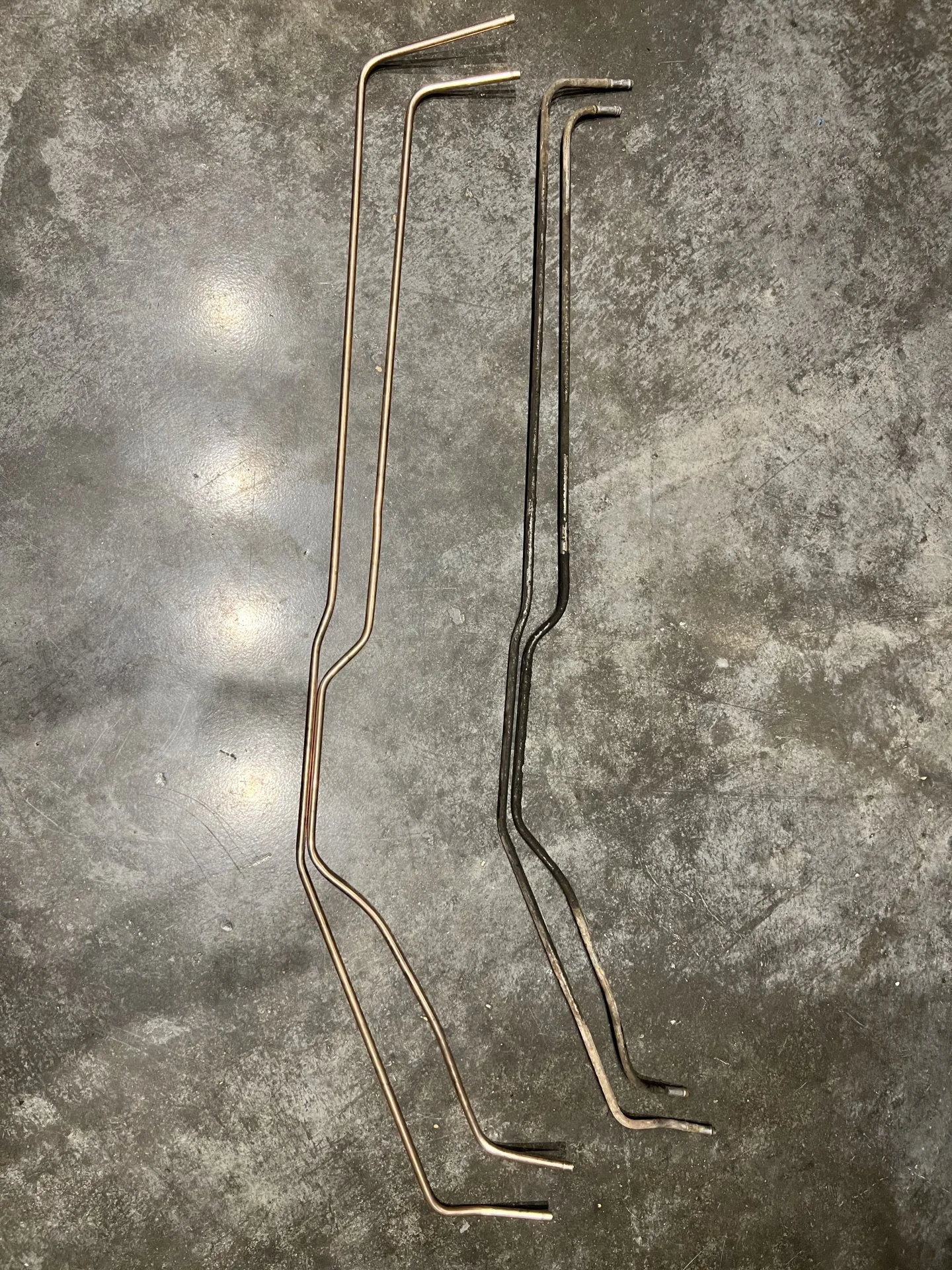

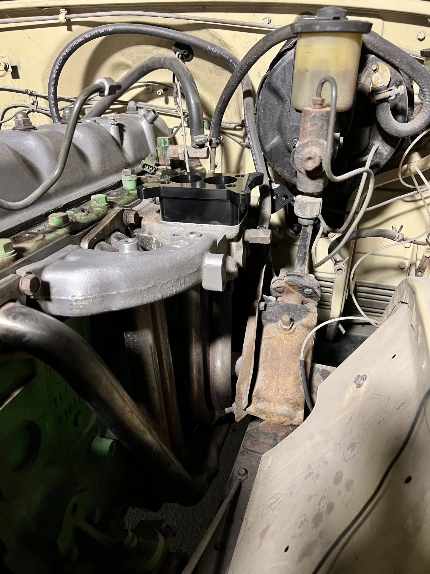

She is all routed up. Since this picture I have reworked the fuel lines which were unacceptably routed.
Also, I couldn’t stand the current state of the intake. A little TLC mid project slowed down progress but was well worth an hour spent with Scotch brute pads.
