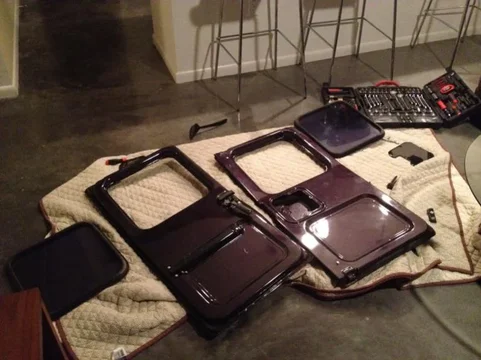

How do you work on your truck in a high rise 45 miles from your truck?
Dissassemble your new to you ambulance doors. Thanks Dbtadford! These purple metallic doors willgo great with the beige.

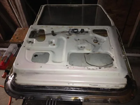

Ill sand these tomorrow and get them ready for primer along with the two front doors i am stripping. That tar on the inside is a mess!
All gone:
I also tackled my second door this past weekend. This was my first big panel to weld. I am glad i warmed up on the hard top. Everything seems fine. these were before i finished grinding. :meh:
