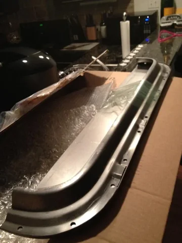

I felt like updating. I've been pretty busy, but have been collecting parts behind the scenes. These beauties came in tonight from real steel cruisers. Made to order and arrived 7 days from my order. Great service and product!

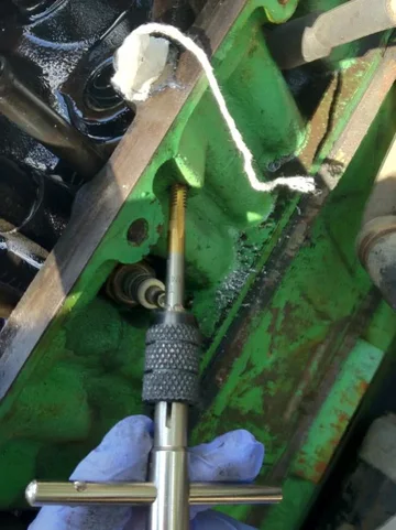

I was able to fix my leaky head plug. I used a 1/4 for the final thread and screwed in an Allen plug with some JB epoxy. I removed the head bolt as recommended and used this nifty household item to prevent any shavings from getting in the motor. Buying the tap and die kit from tractor supply was the best purchase I've made all weekend.

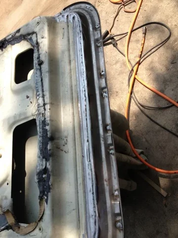

Although there are no other pictures, I got the doors and hard top disassembled so we can make the sheet metal repairs. My friend and paint and body man block sanded and removed some really bad dents. It was amazing to see what he could do with a hammer and dolly. I really lucked out when he moved in down the street. He says the run will be ready for body liner next weekend.

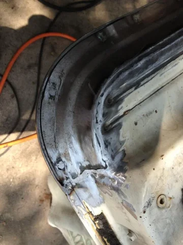

This week we cut out the rust so we begin repairs.
I removed the original tub mounting tabs. A cut off wheel and a sheet metal hammer worked well. I mocked up the new mount to see where I will have to drill. I'll have to blast this piece and paint it.

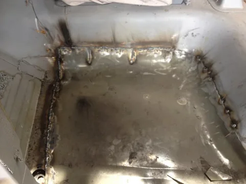

Progress has been slow not due to lack of days available to work on the truck but due to having to wait on my body man to finish up certain parts of the truck. At least the floor has been started now :meh:
We ran out of argon part way through.

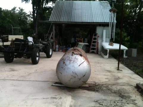

While i have been delayed, i took advantage of the time and started clearing the property. As you may have notice if you follow my thread there are scattered everywhere which are now pretty much gone. There was quite a bit of old construction materials recyclables and junk lying around. I managed to pack a 20 cubic yard dumpster in a few hours, and take 3 trailers of scrap metal. I could tell that dad was taking it all away in the weeks leading to his death. He has all of the copper organized into a nice stack.
Now, a much needed cleaner workspace...the giant tank is a future BBQ pit for my uncle. It just needs a stack and a firebox.
