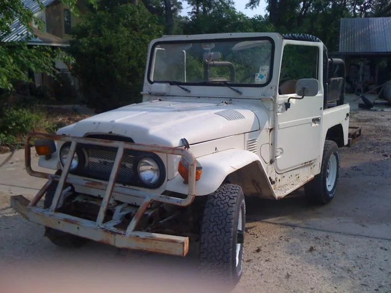

First drive impressions: The truck scoots down the farm roads. It has had some recent TLC to the carb and tune-up courtesy of my dad and a friend of his. The stock seats are trashed, hence the temporary seat :hillbilly: It has a welded on steel front bumper, and a custom rear steel bumper which also brace the basket. This basket is built so it can also have stock tail lights installed. This is for sale for anyone in Texas who wants the start of a swing out bumper (it will make a good start).
I've got my work cut out for me.:cheers:
Haha awesome driver seat. It needs more triangulation. I wouldn't be 'scootin' anywhere too fast.
I had a cousin with a 52 Chevy and had the seats out and was driving sitting on a wooden fruit box. He was messing with his girlfriend and the box fell over and he hit a tree Haa haa! Yep love the 40 seat!
Glad you picked it up and are keeping it in the family and very cool that it is the vehicle you learned to drive a stick on. I love the front bumper, this looks like a great rig to start building back up. I will be looking for more pictures.

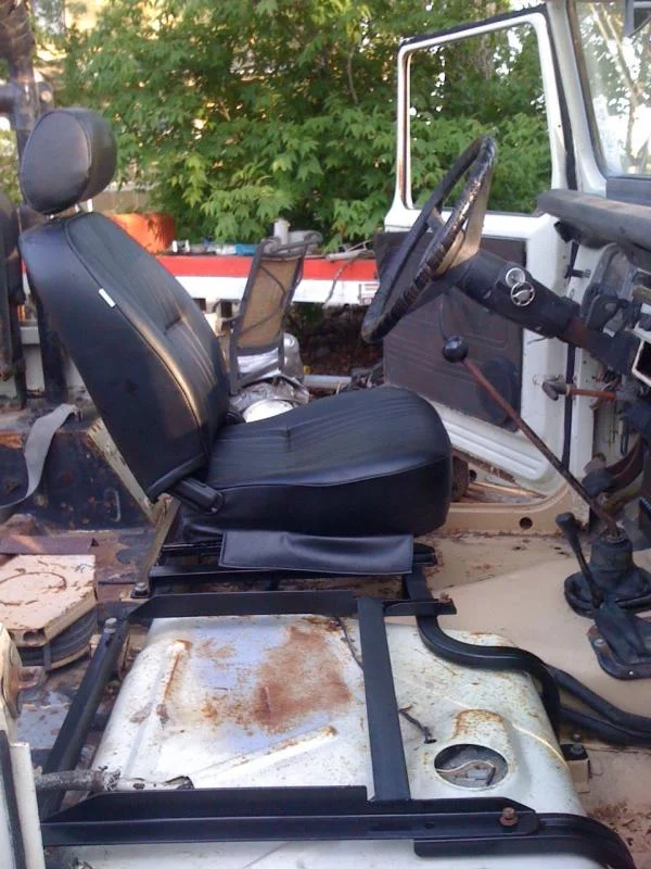

I just received the Procar pro90 seats. This seat is amazingly similar in stitching to the stock 77 seats. I fabricated up brackets for the seats and mocked up positioning. I see a lot of people comment about the higher seat position of the after-market seats, especially the Procar. After looking at how procar designs their bracket and how others have done theirs, I decided to go with this design and am extremely pleased. If anyone is considering the Procars, I will definitely share my pattern and measurements. This was all done with recycled angle iron that will be prepped and powdercoated later. These seats and brackets measure out to the identical seating height as stock.

I welded for the first time today. I am better than I thought I would be. I finished up the passenger side Bracket and Drilled and stripped all the brackets down to bare steel for the ceramic paint coating. I chose to use the Ceramic caliper paint because I have used it before and I like how durable it is and the way it levels. Once this bakes in the sun for a few days, it will cure nicely.
I decided to go ahead and do the front heater restoration today. The core and foam were surprisingly in good shape. I just washed out a little crud. I used duplicolor Vinyl die for the top vent and same Ceramic paint for the steel box. You can see the "before" if you look behind the hanging Brackets. I'm very happy with the way this turned out and am ready to do the pull knobs and lower Dash Pads.
I installed the heater, Brackets and seats and took her for a spin. I also tossed the Toyota molded mat back in, that is not shown in the picture.

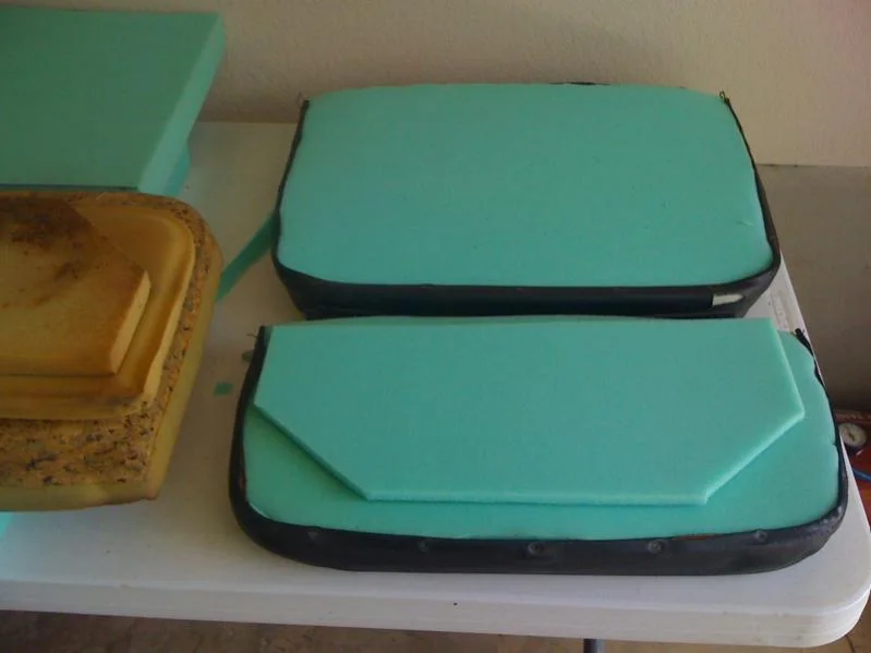

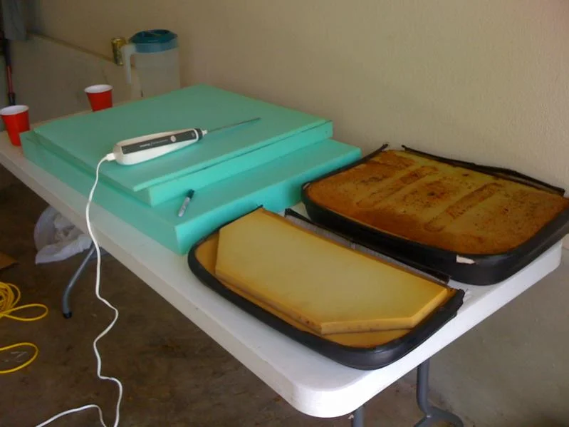

Haven't been down to work on the truck in a while. I purchased a set of original jump seat covers and pads since mine are toast. new pads as shipping from SOR was a little to pricey for me. I got this high density material for 35 with a labor day coupon from Jo Anne fabrics. It is made specifically for seat cushions. Apparently a meat knife I the recommended way to cut seat foam.
Today's little project...

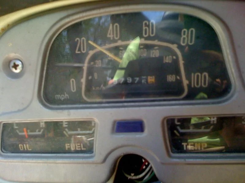

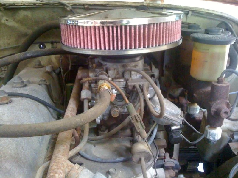

I had a little fun this weekend. My cousin and I Installed a new speedo cable that I ordered from JToutfitters on the assumption mine had rotted, which it had. The part got here in 2 days, so I was very happy to have it before the weekend. That's more than I can say for the fuel filter I ordered from Autozone which never arrived. They eventually refunded my order and I applied the credit towards a new air cleaner.
We drained the gas tank and delightfully found no sediment.

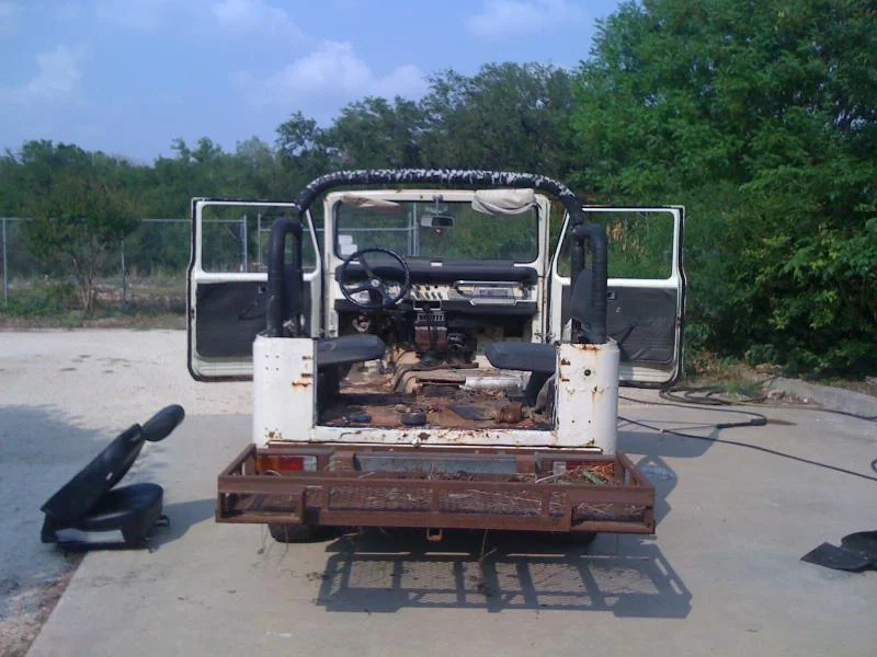

Next, we removed the doors. This takes care of the severe rattling caused by lack of weather stripping and washboard country roads. I really like it doorless, however, boy did 45 mph feel fast.

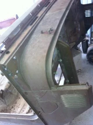

After a quick spin around the block in the 40, we grabbed the flatbed and went about 150 miles round trip to empty out a fellow cruiserhead's storage. He had been parting out a 40 and wanted everything else gone. We picked up an Olive Green complete tub that needs new floors due to some pinhole rust/cancer, and a ton of miscellaneous parts that I am sure will come in handy. One of which was a 1980 roll cage which has the seat belt mounts on it with stock rollbar pads in good shape. I went ahead and installed that Sunday.
Success! The speedometer is a little bouncy, is this normal or due to a small rust issue in my odometer? Perhaps because I did not lube the speedocable core yet, or maybe because the truck hasnt registered a mph in 10+ years.

The fixed speedo, new tub, and temporary air filter.
probably need to lube the speedo cable. Bouncy is not normal.
