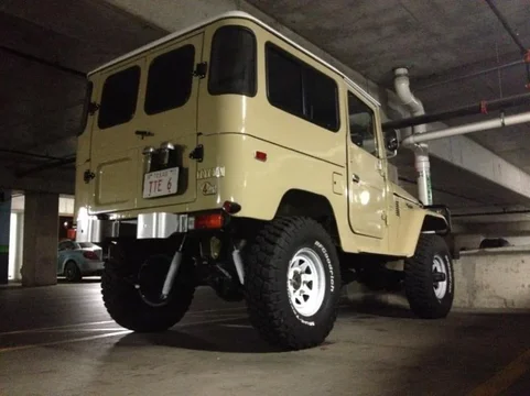

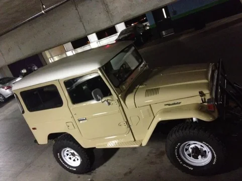

Christmas with my Dad's family went great and they were all amazed at the truck. Especially those who had seen it in 1000 pieces two months ago. Here she sits home sweet home.
Im so glad we bit the bullet and got completely new Toyota door weather stripping, emblems and lights. This made a huge difference.

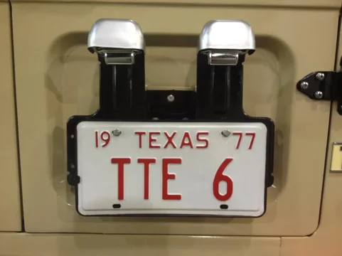

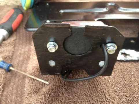

I refused to spend 26 dollars per light for my rear license plate frame, so i modifies these 3 dollar lights (available everywhere) to work. I needed to drill one hole on each side and run an m4 screw and lock nut.

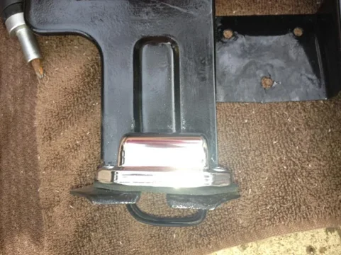

CCOT clutch carnage:
Here is the slave BEFORE the pedal is pushed. You can see how far the piston is out even before fluid pushes it open. Mind you, the CCOT rod is adjusted as far out as possible. The nut is hanging off the end by only a few threads. I was going to just replace the rod, but i decided to check the piston and O-ring first. I will call them tomorrow for a new slave.
