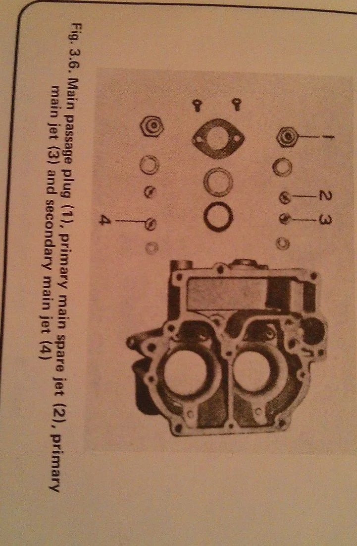

Not sure if you're aware, but there may also be a spare set of jets screwed into the back of the plugs. I found these on my 77 FJ45 carb after a local mechanic drilled the originals out when attempting a tuneup (epic fail).
I installed the spare jets and all was well again.
