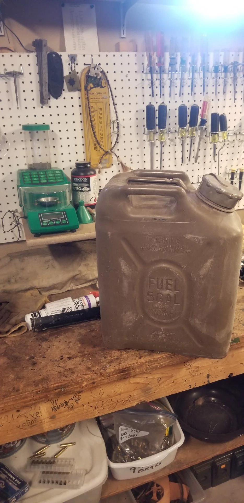

I bought some real Nato cans years and years ago when they were cheap at surplus stores. To this day, they seal tight. No worries about inside the rig or even on their side. I've taken them in the back of the rig on many outback trips before I got large fuel tanks. The only drawback on mine is that they empty slow. I'm thinking the siphon suggestion is a good one. That or a better nozzle than the one I have. But that is the only downside that I've found and I can live with that. Recommended.
Scepter cans all the way, with new gaskets (cans are kind of expensive, new gaskets not so much). I've taken mine thousands of miles around the backcountry over the last decade. No fumes, no problem. I wouldn't hesitate to leave tomorrow with 10G in the cab (or 25, whatever you need to carry).
