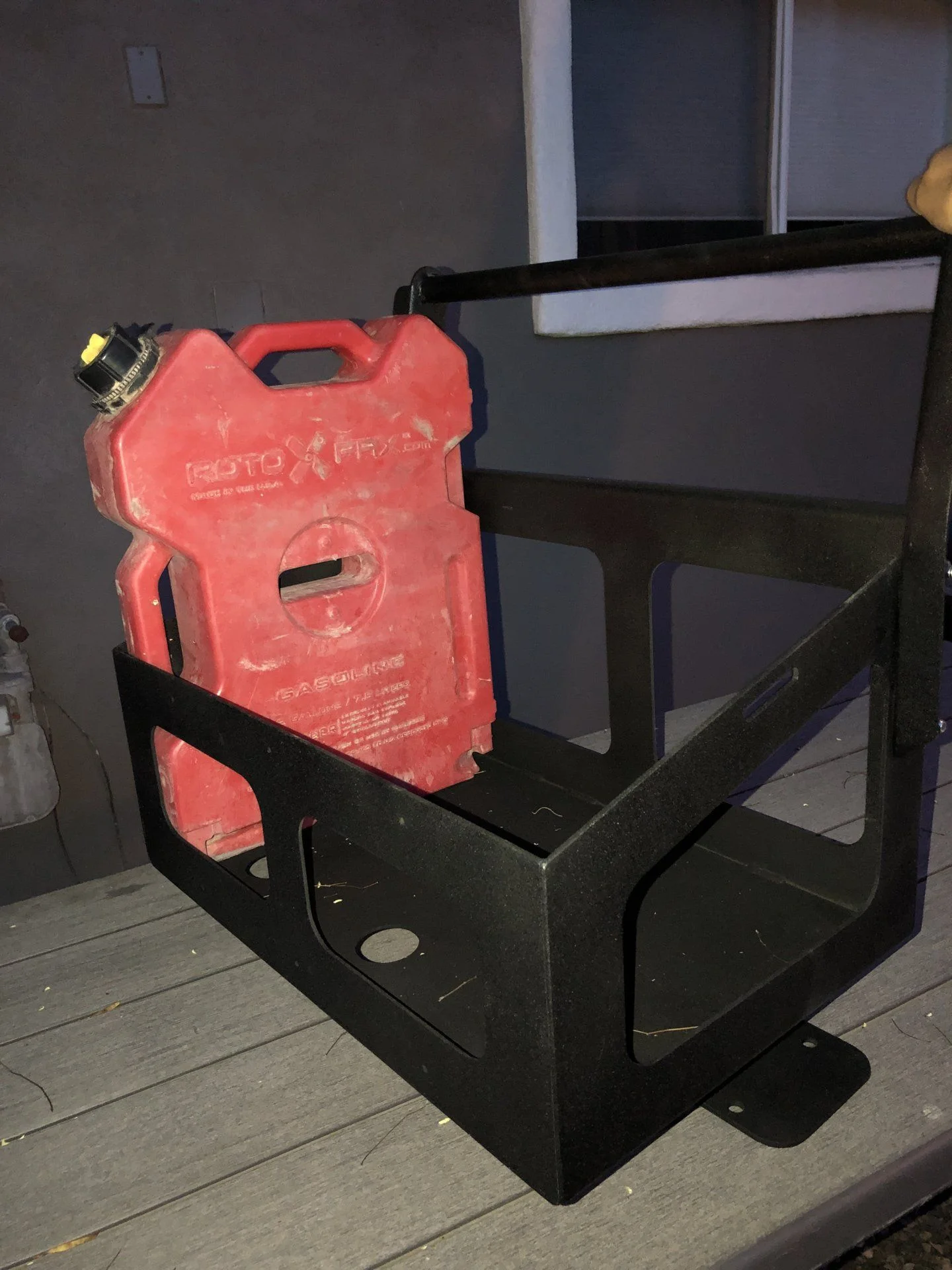

I’m putting a rear bumper on my 200 next week. It’s a dual swing out, and has a holder for 3 Jerry cans. I ordered 2 20L beige water cans from WitsEnd, but I also want 1 20L fuel for the 3rd spot. I have a 2 gallon rotopax that fits (if I bought a 2nd one it’d fill that spot), but in the past year I used the rotopax I’ve grown to despise how it doesn’t self vent. Extreme Altitude and temp changes are a common occurrence and it’s a pain to have to open to vent sometimes multiple times in a day. Any advice on where and what to buy for a high quality 20L fuel can

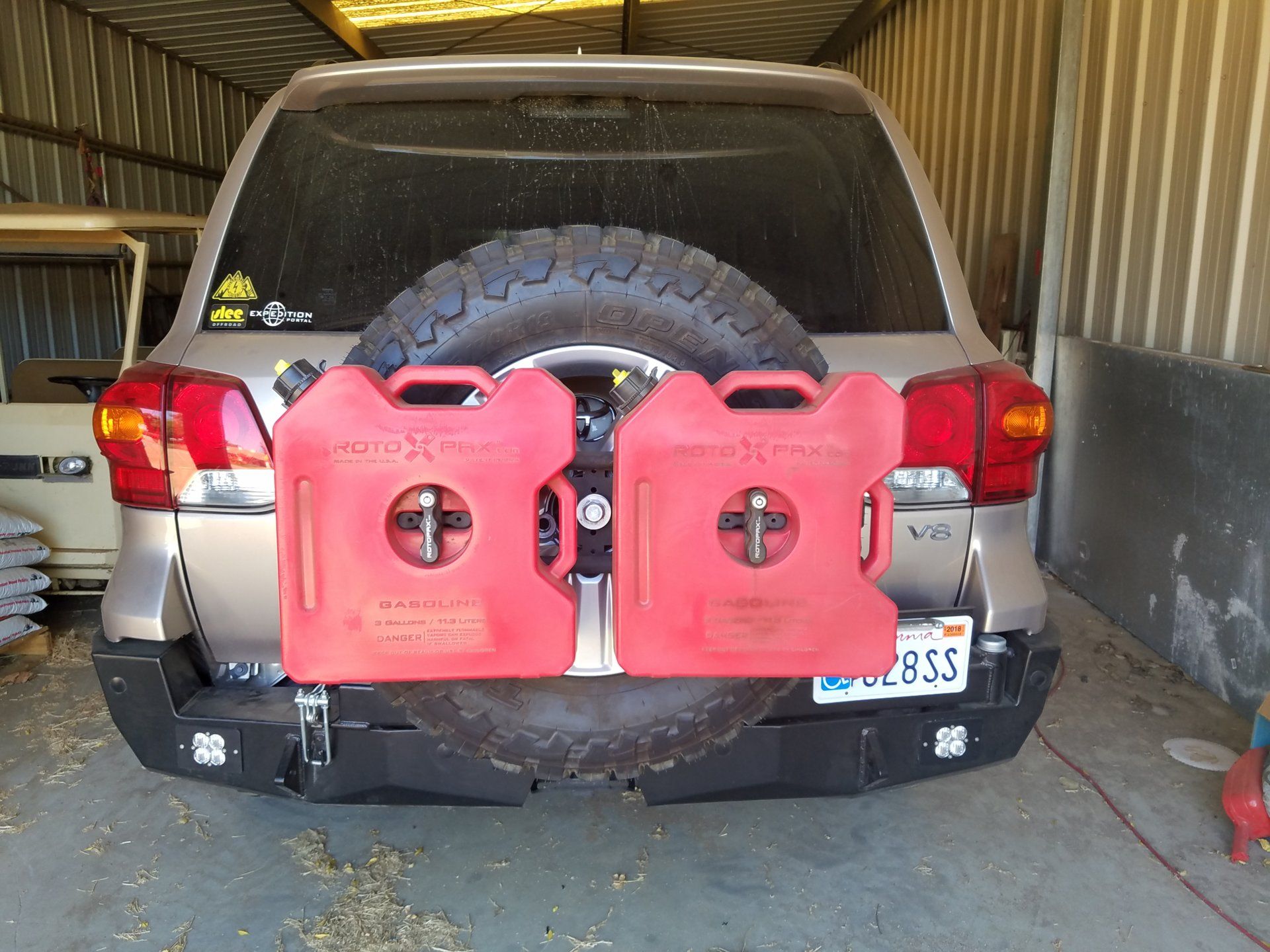

In my use of Rotopax including from sea level to over 13,000ft and even the reverse without venting... -Rotopax don’t need to vent because they can handle swelling without structural stress. My three 4 gallon Rotopax swelled significantly, and have NEVER leaked unless I goof on putting the seal ring in or something. Occasionally I have to put cans temporarily inside the vehicle, and the last thing I want is fume venting.

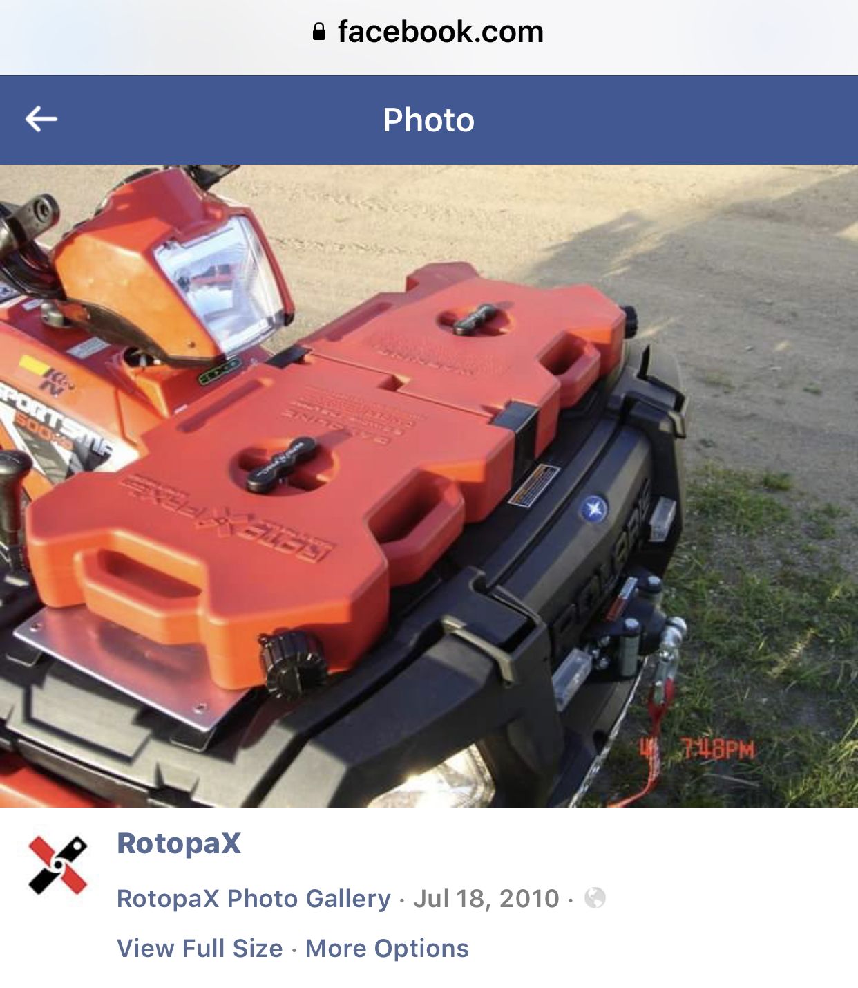

Like I say... I’m sure venting is recommended. Really just saying they are extremely robust, and are made to be mounted upright, or sideways. I would occasionally vent, but my comment about elevation was more about their amazing sealing and robustness. Not meant as a recommendation.
Curious though. Rotopax basically don’t have “seams.” How do you feel it would catch fire on swingouts? Not trying to dispute...just trying to follow your thought on it catching fire. They deform rather than crack. If they self-vented, no one would be able to mount them on their sides as they are designed to do. Curious what you think.
I no longer mount Rotos (subtank) but when I did, expansion wasn’t extreme because there wasn’t much air in them in my use. If they were empty, then I left them to vent upright in back since huge amounts of air would expand way more... but zero issues ever.
