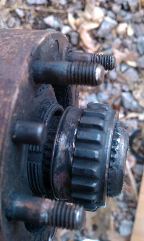

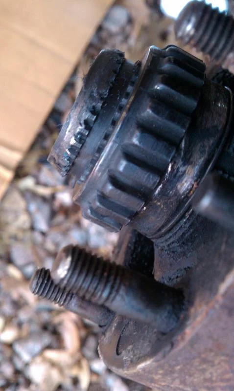

UPDATE! I got the cone washers out. Amazing how the correct tool will make the job a 1000 x's better :D So I pulled the remaining hub off only to find that the outer edge of the axle was ground down (see pics below). So for now it looks like I need the following: seals, bearings, axle, and locking hub. Hopefully will have more time this week or at least the weekend to finish pulling the rest apart. The pics below show the axle where the locking hub and outer edge of axle ground together. I had to cut that part off just to get the remaining hub gear off.
So what is the general opinion. Do you think if I had stopped ASAP when I heard the bearing go would the axle have been eaten up? Or since I continued to drive on it thats what did it in?
It's hard to tell by the pics, but it looks like some of your hub studs have the threads muffed up. You can fix that with a thread restoring 8M x 1.25 die.
When you want to remove the cone washers, spray the cone washers liberally with a quality penetrant such as Kroil, loosen the nuts and leave them on out towards the end of the stud to catch the cone washer when it pops out. Hit the studs straight on using a nice thick brass drift and ballpeen hammer. Brass hammer is good too, but I have better control with the brass drift.
It's hard to tell on the backside of the hub gear what's going on. If you can tap the hub gear back in a bit, you may be able to gently trim the bunged up splines on the end of the axle using a dremel with a fiberglass cutoff disc. It'll take bit of time, but all you're trying to do is return the splines to their original shape.
I'm gathering that you had to cut apart the locking hub body? That's expensive! Good luck.
