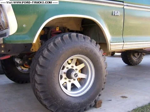

yea, I forgot all about those. I had a set on my first 40 in ~'82. Bought from friend's dad who bought them new for his new 79 Chevy 4WD truck. As I recall they were very thick steel and HD. Water under the bridge as they say and any white spoke avail now will be undescernable to 99.999% of the people. Now if you were looking for a period-correct aluminum 'turbo' rim, that's a different story and considerably different in appearance that everyone would notice.
Edit: images.google search provided this that is just as I remember them. albeit on an F250
http://www.ford-trucks.com/user_gallery/sizeimage.php?photoid=136246&.jpg=

One of the reasons, if not the biggest one, why those type of wheels are not around any more is that they are not DOT street legal.
If you look closely at the pics, or better yet, remember [yes, I too fall into that catagory] that massively thick center section was plate steel. No raised ring to help keep the lugnuts tight. Requires stud snapping torque to keep the lugnuts on.

what do you mean by no raised ring Mark . what kind of wheels are these on my trailer i picked up this summer , wheels look slightly different (see pic) from memory pretty sure mine look like plate steel ,gonna have to go and take a look
Modern steel wheels have a raised section at the lugnut, so that the metal of the wheel directly behind the lugnut does not touch the hub/drum. This acts like a lockwasher, putting extra tension on the lugnut that a flat stamped piece of metal cannot provide.
