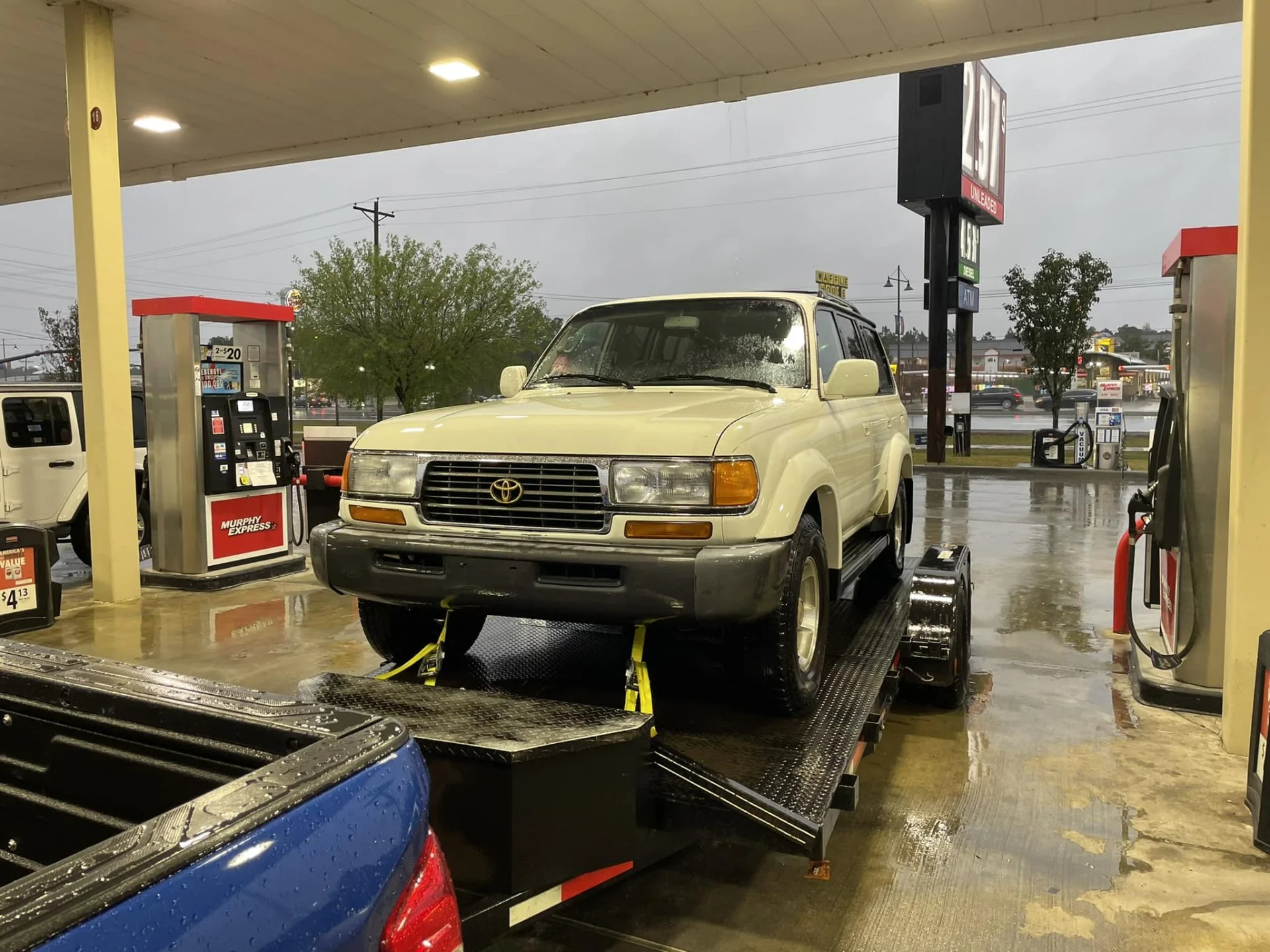

But the car was unmodified and very clean. So after a few days of haggling, she followed me home on a trailer behind the Tundra.
Off we go. Named her Jackie after the previous owner, a very stately older lady. Seemed fitting.

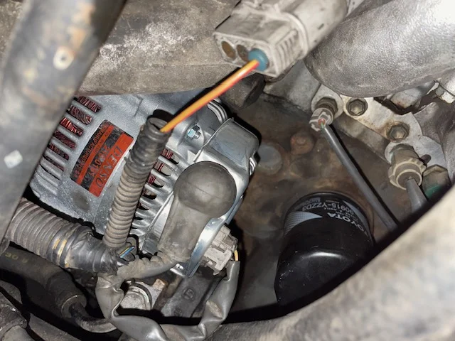

Alternator is in. Got pretty good at changing them out. Took the one that was in it out. Put my friends used one in from his 97 that has been off the road 7 years. That was was also bad. Put in a Denso reman from Rock Auto. All good. Tested the old one, brushes were worn and 3 of the 4 diodes were shot in the rectifier. I'm going to rebuild it and save it for a trial spare.

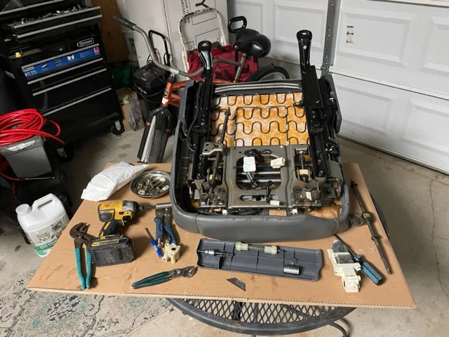

Also tackling the seat motors tonight.
Your already ahead of the game because it's white. Good looking rig!!!
Seats are fixed. The Otramm and Gamavita videos are all you need. Not hard at all.

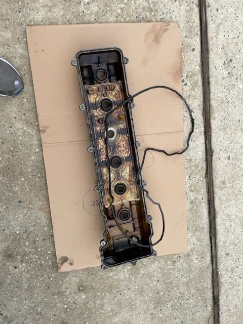

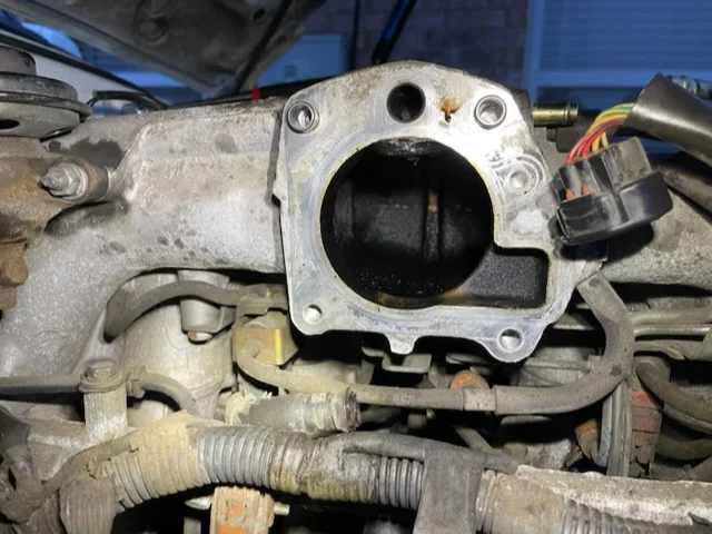

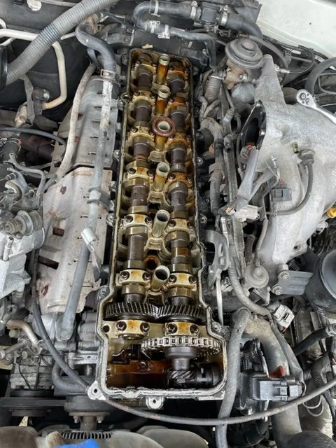

I have lots to do while I wait on the shim. Clean the throttle body, replace the spark plug tube seals, clean the head (last mechanic in here just used permatex and the old OEM valve cover gasket, no wonder it leaked), clean the valve cover, start replacing all the 26 year old vacuum and coolant lines, and a litany of other things not related to this repair.

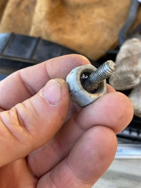

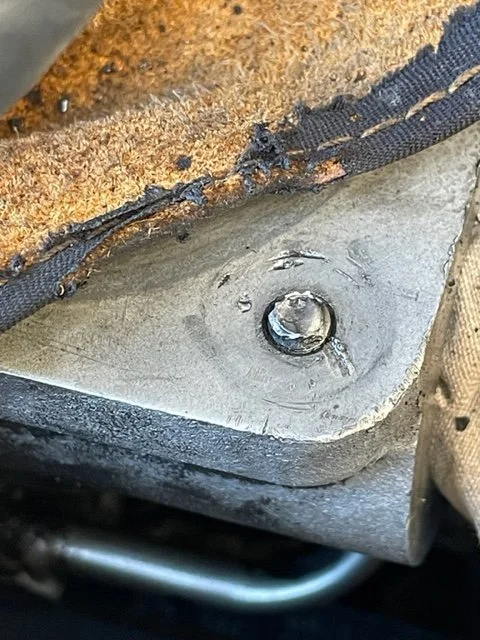

New Dizzy o-ring installed. Cleaned all the old oil sludge off. Next challenge: Broken bolt in the valve cover. Vice grips didn't work (do they ever?). Time to break out the welder, I suppose.

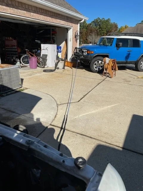

I mustered the courage to go welding on the head to get that broken bolt out. I had to maneuver the truck to within reach of the welder, which brought in the daughter's FJ Cruiser and its winch.

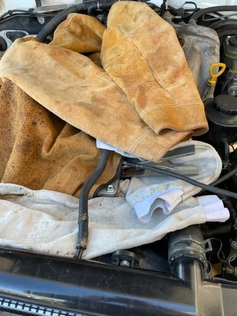

Then the patient had to be prepped. Recall I have the valve cover removed, so I had to protect all that from the splatter. I removed the dizzy for access and to protect the electronics inside the dizzy from stray current from the welder. I can't remove that coolant line without spewing coolant from the throttle body de-icing line that is loose.
Took me 5 attempts, but I got it out. Very thankful. As bad I am as a welder, I am 10 times worse as a broken bolt driller outer. Nothing more satisfying than the feel of that bolt breaking loose. Thankfully the MIG welds will not stick to aluminum.

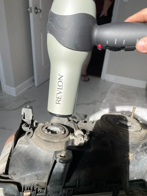

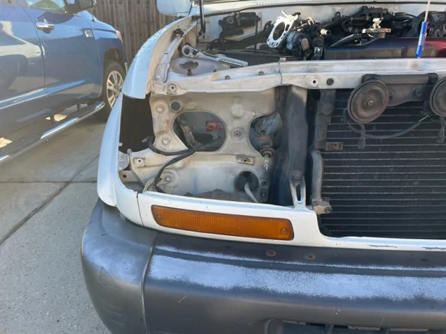

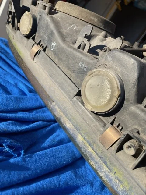

I have moisture in the passenger headlight. I removed the headlight and did a soap and blow test to look for leaks. I cinched off both vents and put a headlight bulb in one opening. Then blew with the shop vac. I could not find a leak. When I blew out one vent, I may have noticed a slight obstruction. But the other vent was clear and should have made up for it.
Anyway, I dried it out and reinstalled it. I'll watch it to see if the moisture comes back.
Look at the clips that hold it together. Very TLC of them to glue and clip them, plus have TWO vents. Gotta love how they build these trucks.

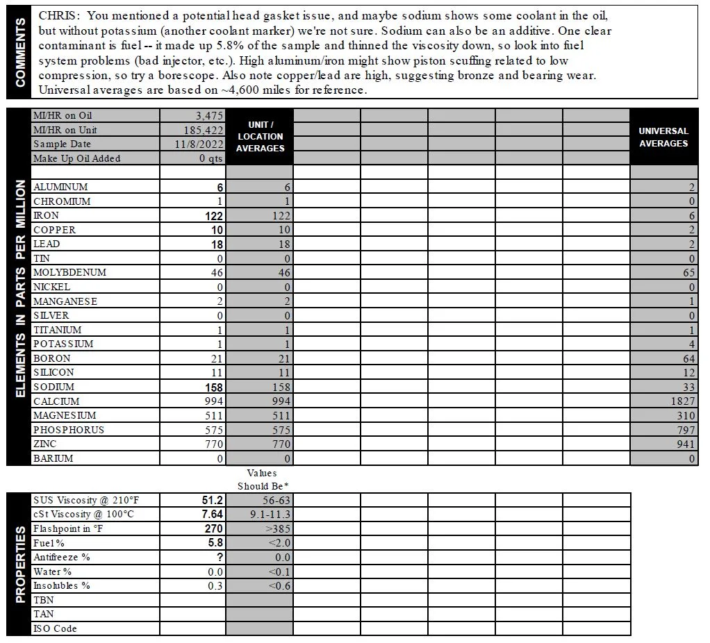

The oil analysis came back from Blackstone. I talked to the tech and she said that it doesn't look like a head gasket based on this sample, but the fuel % is high, and there are definite signs of wear metals. I have an odd idling issue, where it seems to stumble a bit at 600 RPM (which is where it should be, right?). I had been thinking that is a vacuum leak from all the old vacuum lines, but this makes me wonder if I have an injector issue.

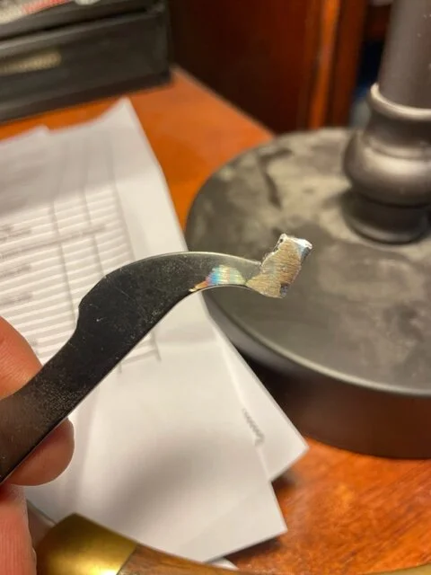

So it turns out that the "Toyota/Lexus" valve shim tool that everyone uses and struggles with is not to be used on 1FZ-FE engines. says it right on the manufacture's page. Its too short.
What is the saying, "when you have a welder, any tool is whatever you want it to be"?
So I added some material to make it longer, ground it to shape and I had those shims out in 10 minutes. All the shims are replaced and she goes back together in the morning. Let's hope that rattle goes away, or at least lessens after all that work.

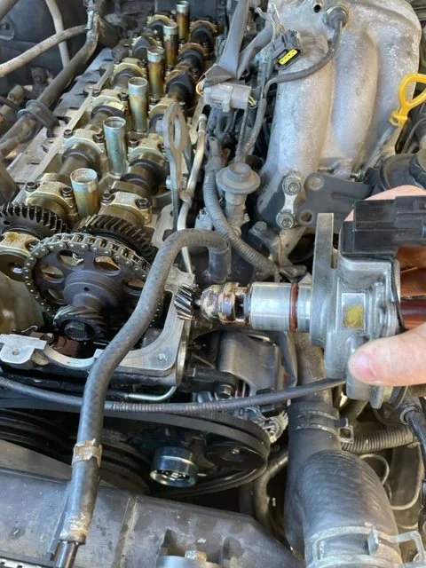

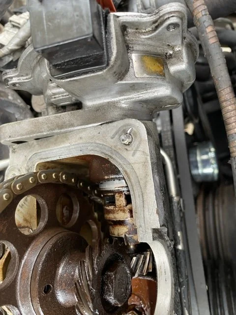

After the valve adjustment, there is still a fair rattle from the front of the valve cover. Only thing left is the timing chain. I went to listen to a friend's 80. His has the same sound, but its faint. His engine was just rebuilt.
I found the source of the ticking sound...
