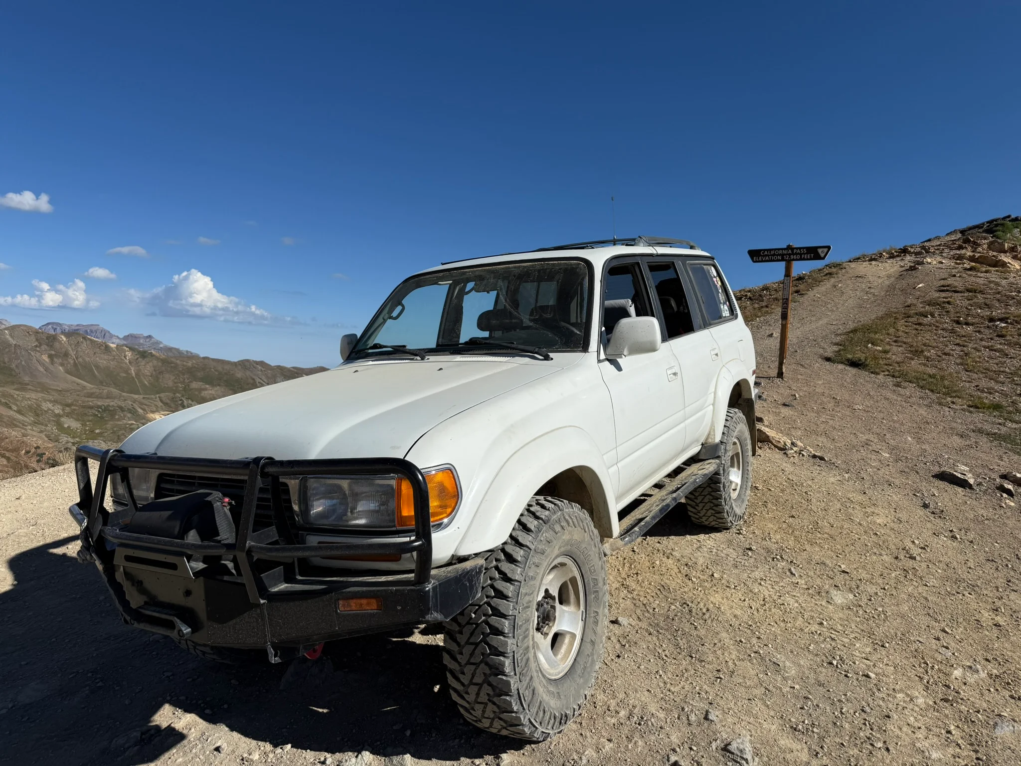

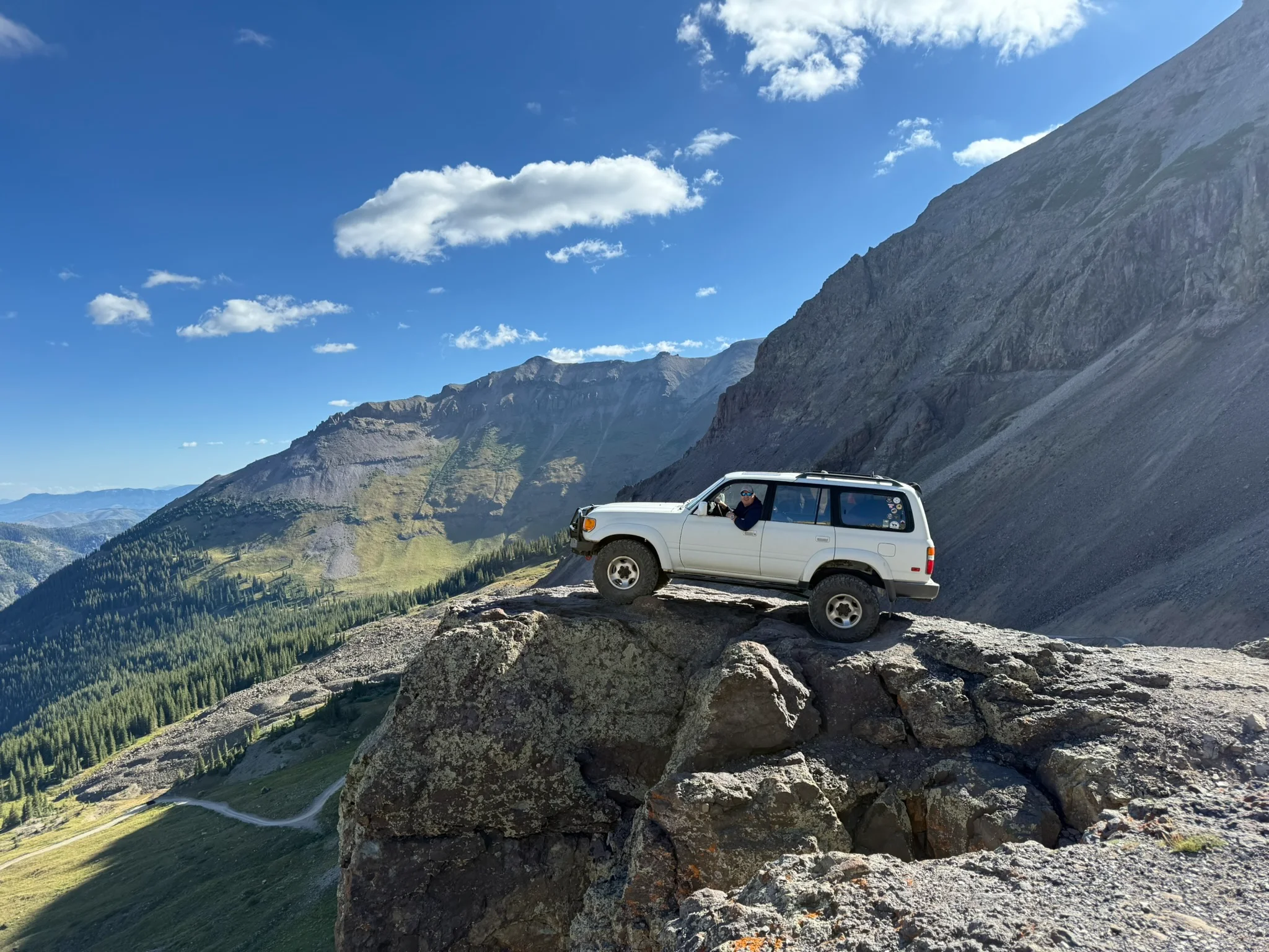

We spent 4 days in the San Juan mountains, staying in Ouray and 1 night camping in Great Sand Dunes National Preserve. I drove Jackie out there and my son drove his Sequoia. My other son and his Fiancé flew in from Austin. It took 2 days to drive out there and 2 days to drive back. All in all, the over 3400 miles of driving.
We did all the popular passes in the San Juans and Medano Pass road in the Great Sand Dunes National park/preserve.

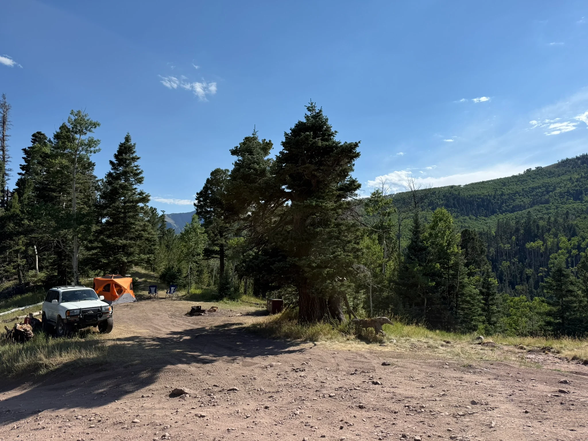

Great Sand Dunes National Park is the coolest thing, in the most unexpected of places. In the middle of the Rockies is this huge set of sand dunes. The wind blew them there across the San Luis Valley over thousands of years. You can't drive on them, but Medano Pass Road gets you very close, and the road is very sandy in spots. We camped at the highest camping spot on the preserve side (# 5.8), so we could have a campfire legally. No fires on the National Forest side of the pass. The site was about 9700 feet above sea level. I think that was the highest we've ever tent camped.
