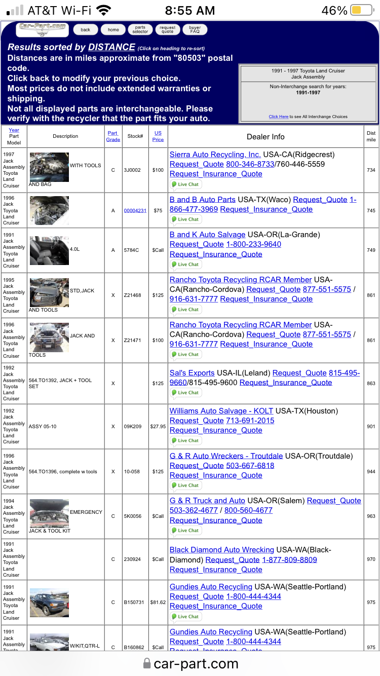

Thanks i have been searching the junk yards and no luck
They’re everywhere 👇🏽

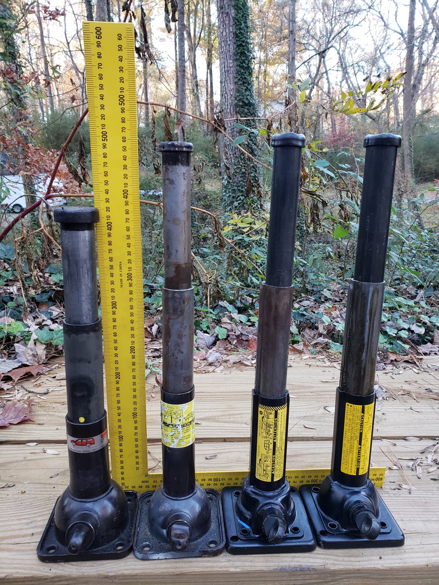

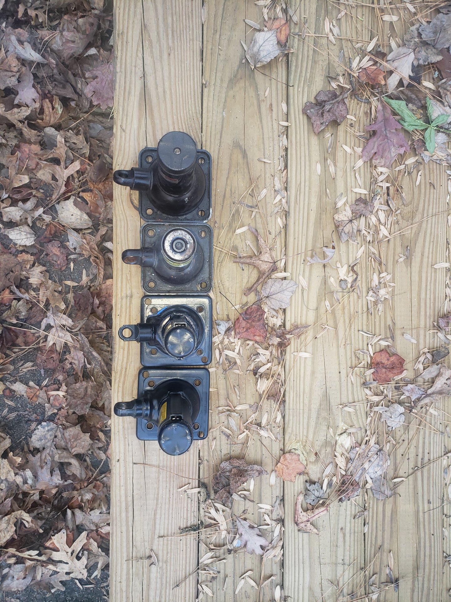

From Left to Right. 80 Series (1800Kg), 100 Series(1800Kg), 1st Gen Sequoia (1340Kg), 1st Gen Tundra (1340Kg).
*Note to use inside measurement for the "compressed" picture with the square. For the non-compressed use the outside measurement on the square.
Hope this helps someone decide.

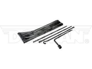

for clarification, will any 1991 to 2000+ toyota suv tire tool kit work to drop the spare? my 80 did not come with the tools and i need to drop the spare .
Pretty sure the tools from most Toyota trucks and SUV will work.The shepherds staff end is the important part. You can likely come up with something else that will fit in the giant slot where that end goes to roll it down.
Check this out!
Dr.Roc Compatible with Spare Tire Tool Kit with Tire Jack Handle and Wheel Lug Wrench 2005-2021 Toyota Tacoma https://a.co/d/9nynU0X
FYI, worked great in letting spare down on my 1996 LC 80. I had looked everywhere and no one said it was compatible. works fine.
i hope this helps.
