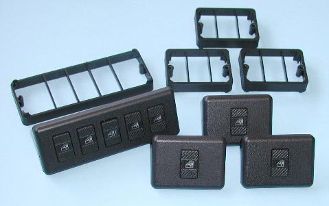

As for aftermarket switches, I was thinking something like this:
http://www.a1electric.com/Merchant2...PROD&Store_Code=AEOS&Product_Code=4990-50-227
I have yet to find one that has the 4 window switches + window lock + door lock configuration. So I may dump the window lock switch.
Alternately, I'm told that you can just pick up individual generic switches, and then have someone fab up a panel for them.
