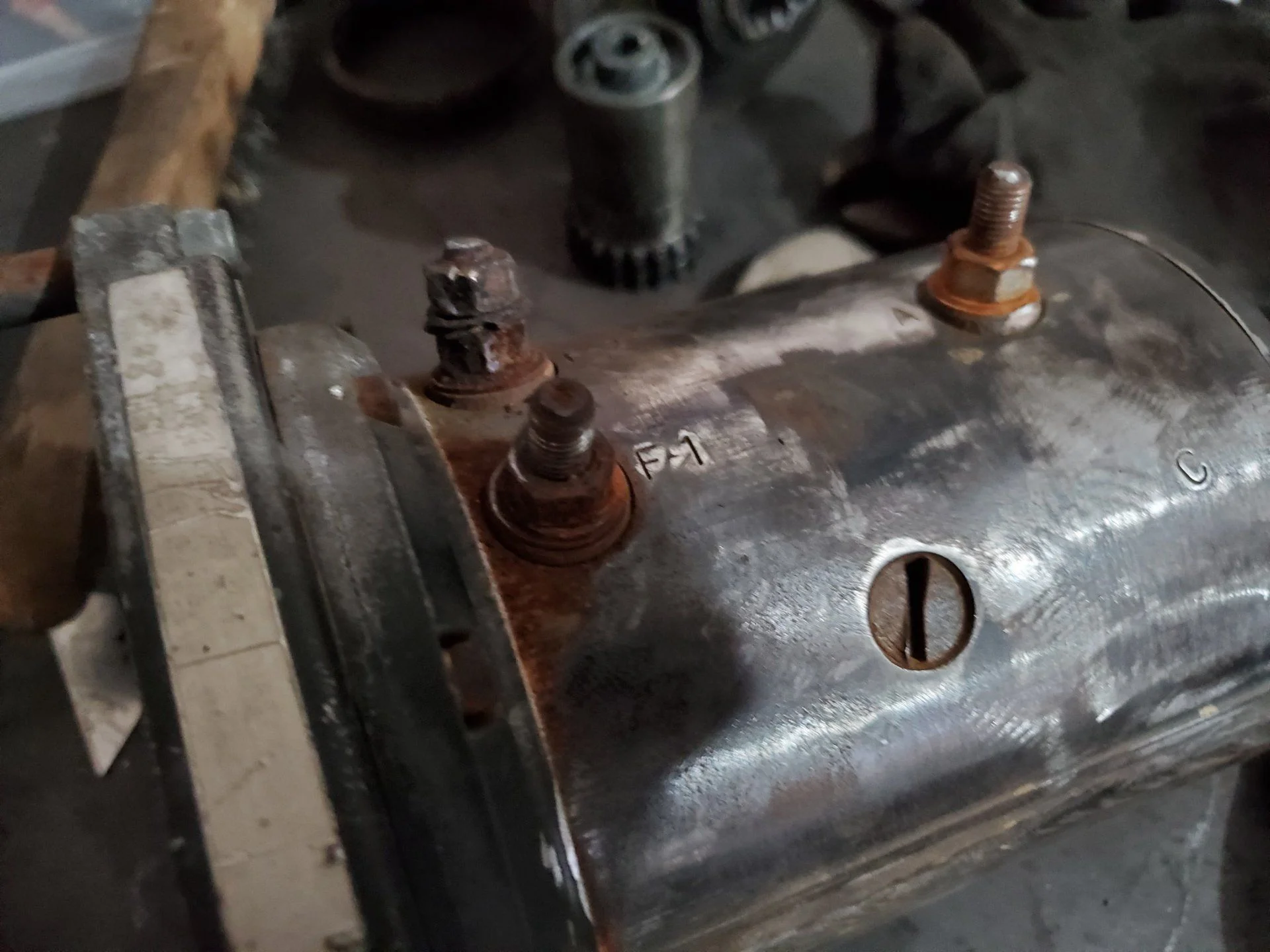

My wife's FJ came with this old warn winch. The contacts are pretty rusty and old and so is the wiring so I was going to by a new kit from warn with this https://www.warn.com/control-pack-upgrade-kit-99760

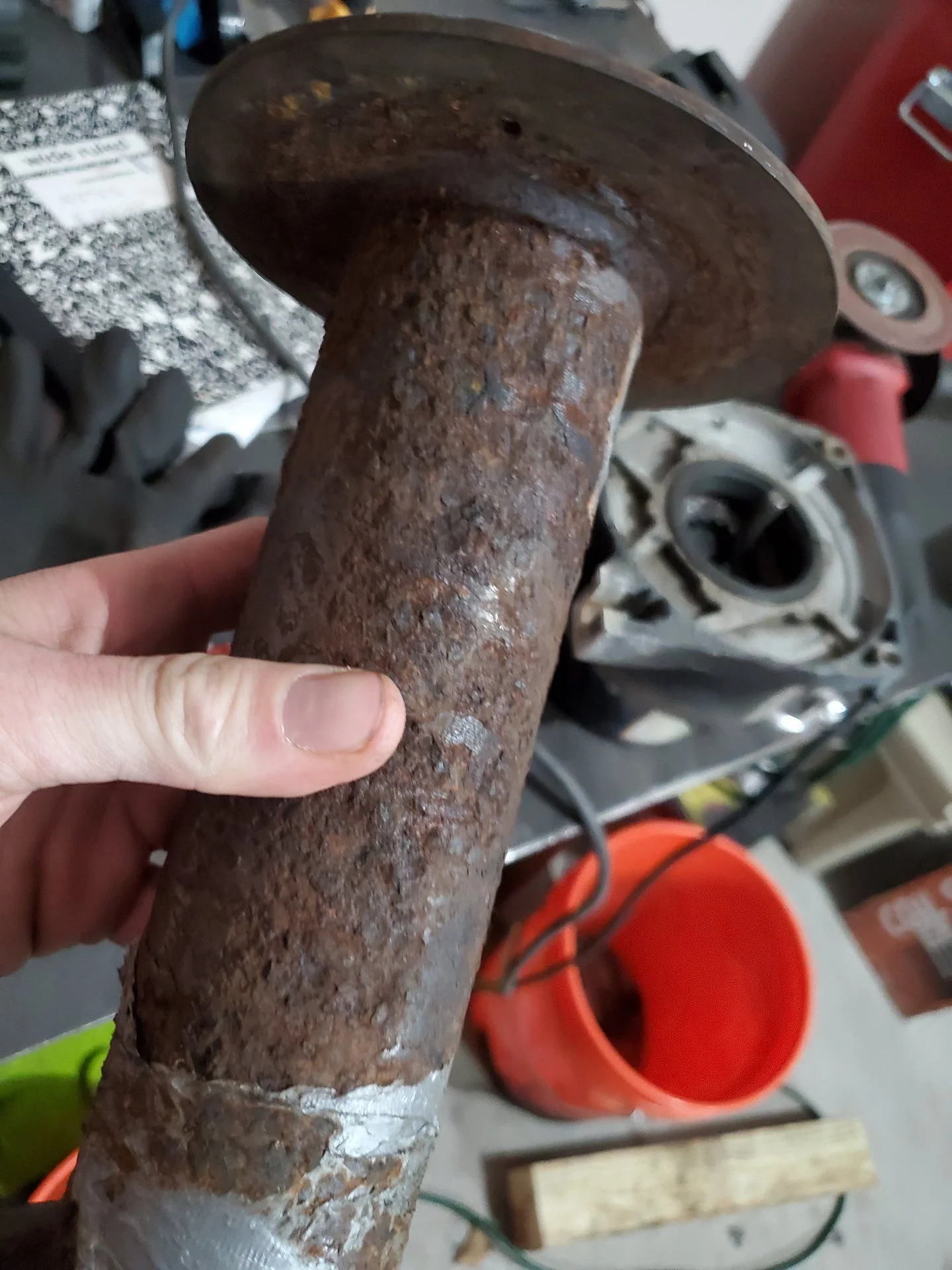

But the posts in the motor have rusted together and are spinning, then I took the line of and the drum is majorly rusted. Is this worth trying to salvage? It was running when I took it off, but created a lot of heat at the post connections.
I’m certainly no authority on rebuilding winches, but- if you’re seeing this much rust damage on easily accessible parts, I‘d be concerned that other, less obvious parts are also severely damaged. Either strip it all the way down, and replace or repair the damaged parts, or save yourself the time and headache and go with something in better condition. You’re in FL, right? Bet it was submerged in salt water more than once and left to “dry.”
Yeah probably was submerged before. A while ago I took it all apart and cleaned the posts and everything, but they rusted even worse afterwards. Obviously not stainless hardware. I didn't take the line off last time though and that drum looks really bad.
Like I said I hate to trash it since it does work, but that drum will destroy my line and the rust is pretty bad everywhere else.
May just buy a smittybuilt and put the synthetic line from this winch on it

I think its an m8000. The internals look good and well greased, but the drum rust is pretty thick. I'm on the fence because a new drum is about $100 and the new solenoids and wires are about $200. At $300 I can just about buy a Smittybuilt or a brand new 12k badlands

i would rebuild it, but I’m a glutton for punishment. I’ve rebuilt 4 warns. The drums are stout and once the rust is cleaned up I’m sure it will be fine. Is the brake functional?

I'd rebuild it if it were me. Trash the drum and throw the rest in a large flat rate USPS box. I'd take it and I'm sure many others would, too. Would be a fun rebuild project.
I rebuild these all the time. That looks like an early MX8000 from the mid-late 80's. The drum isn't usable anymore so you'd want to find a used one on ebay or someone here maybe. Your motor is also no good anymore. A new one is about $190. You'd have around $400 into it to get it in good shape but it'd be FAR BETTER than a Chinese winch like Smitty or HF junk. If you want to sell this for parts, Im very interested because I need some parts off of this that are no longer available. Please PM me if so.
