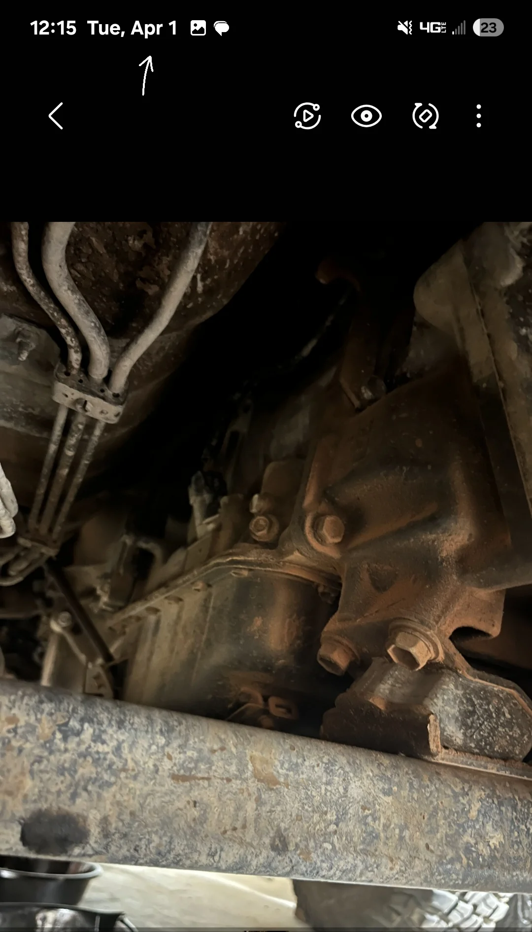

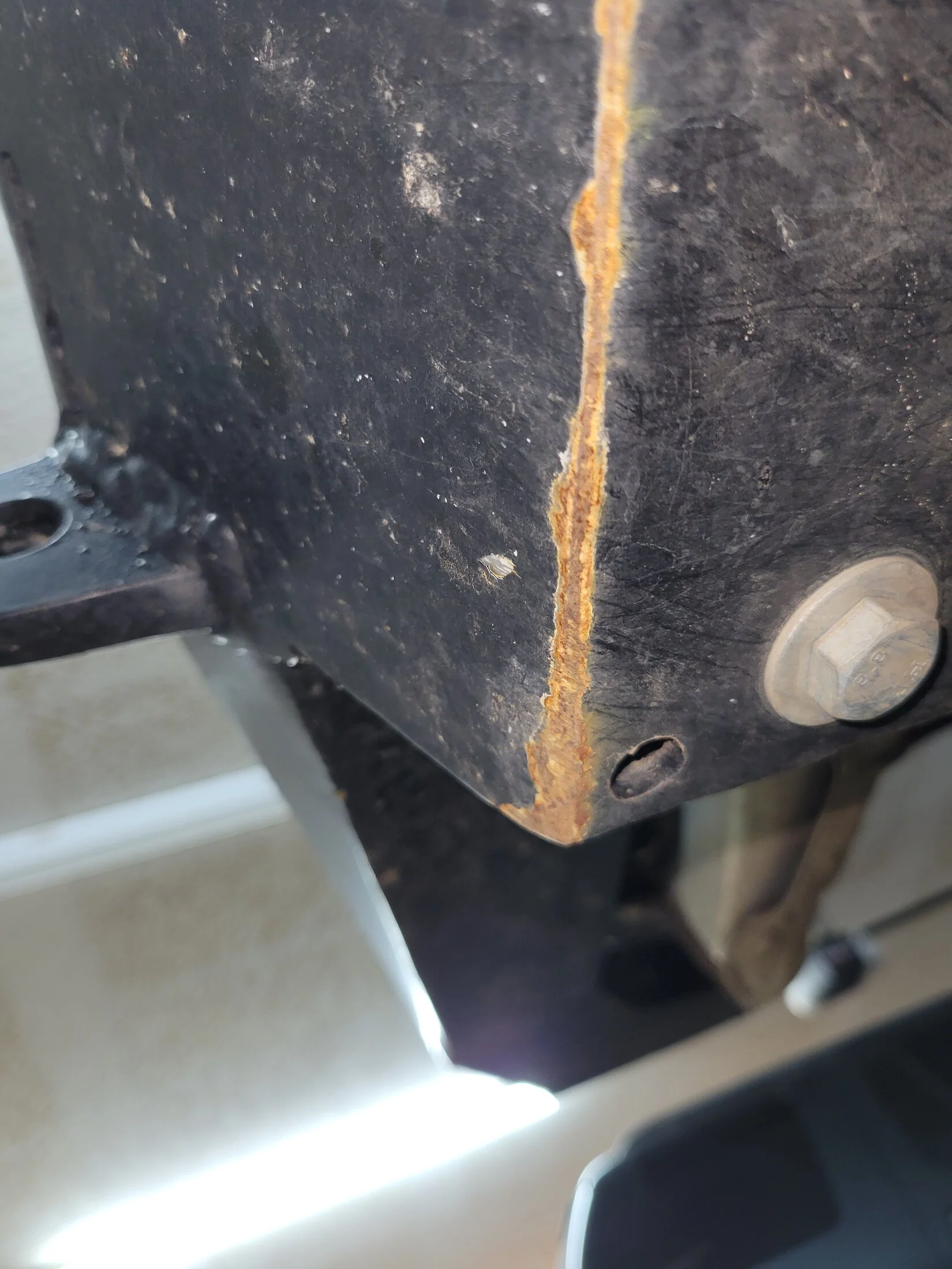

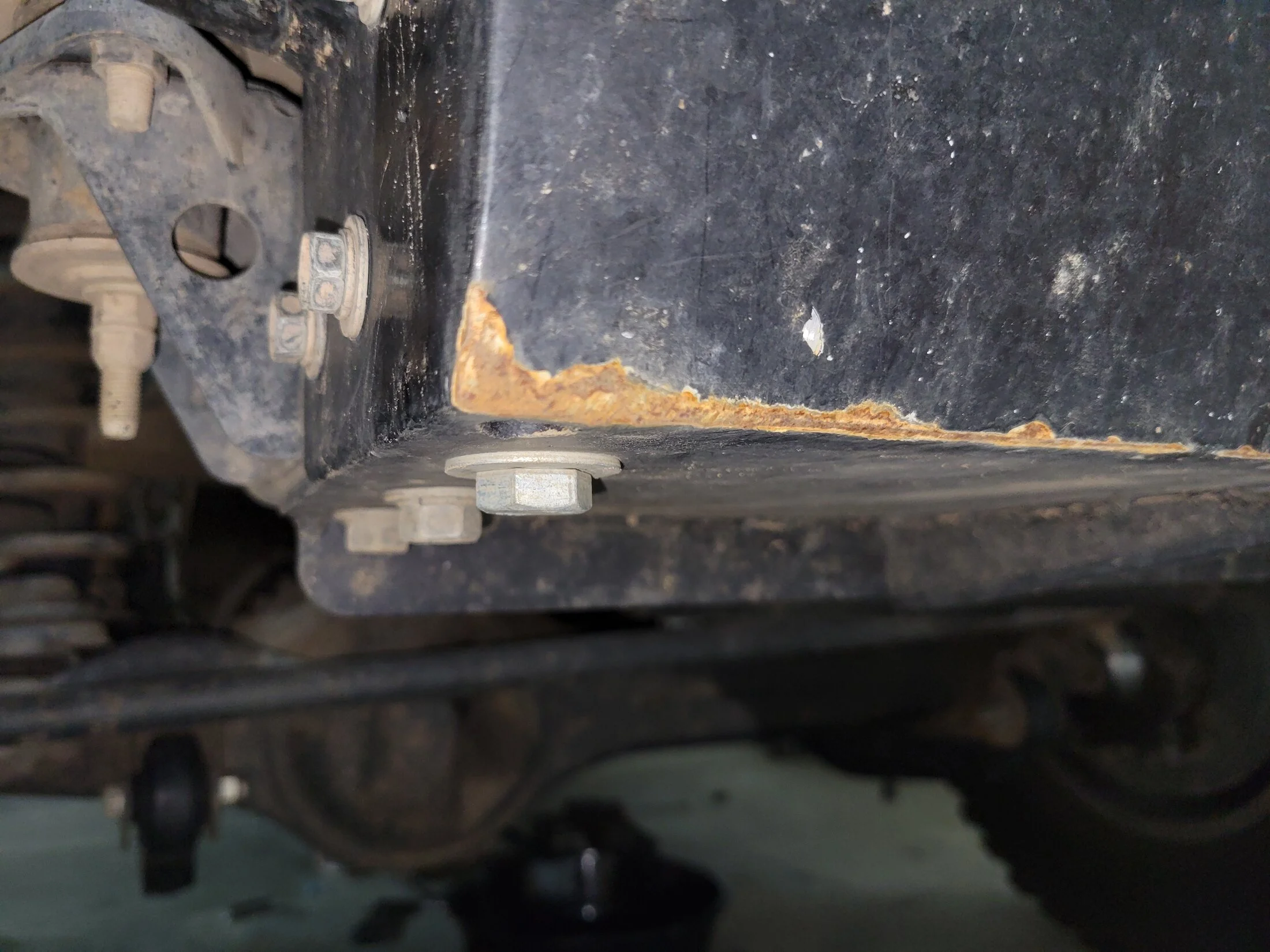

After 31 years of life, my beautiful baby (1994 FZJ80) has finally succumbed to the cancer of rust. During a routine check, I found the orange/red plague of death in multiple places, and it is spreading. How long does she have to live? Months, or days? Should I try Fluid Film, or is it too late for that?
Nothing to worry about. I am looking at the hardware beyond, and it looks fine as well.
Anything you can completely remove with a single sheet of sand paper is likely not a death sentence.
Dust from the wind. Sung by Kanzas.
@WCBlueSky :Those two photos don't show any real rust. Rear axle is out of focus but if that's rust it's just surface.

Sorry everyone, I couldn't resist posting an April Fools Day joke. You have to look really hard for any rust on my rig. Thanks Kernal for saving this thread from going to "Chat" by posting actual useful technical content :)
