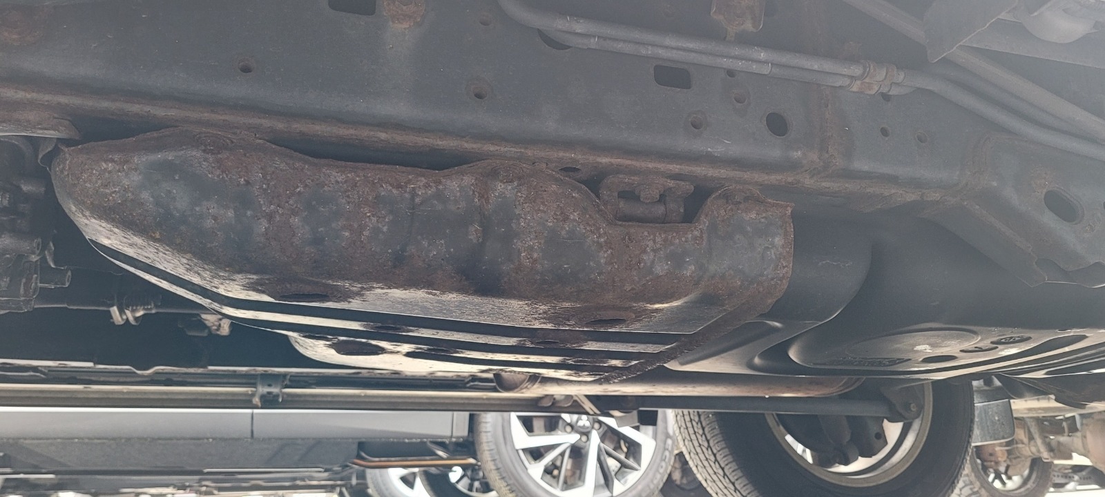

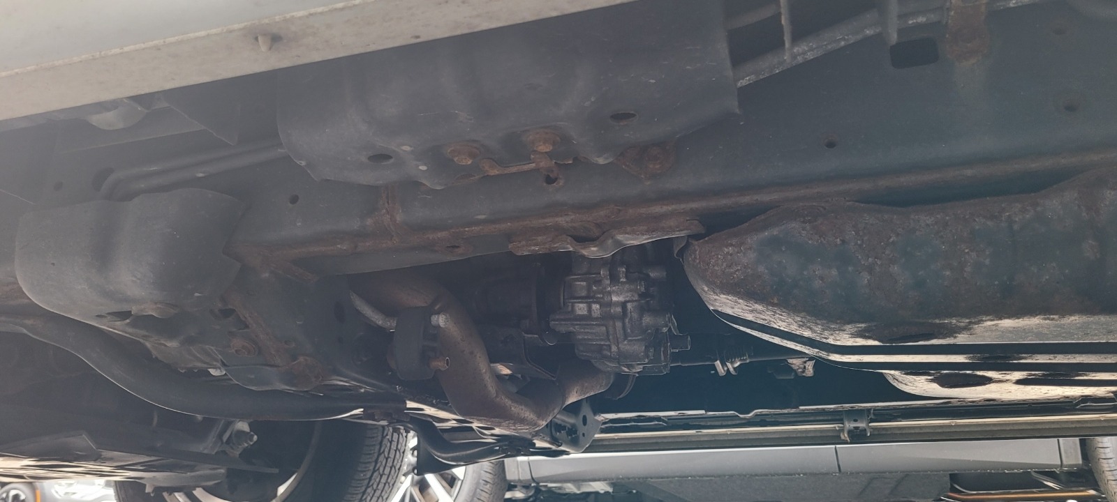

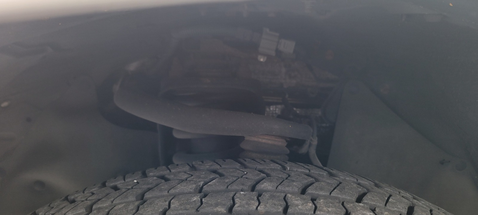

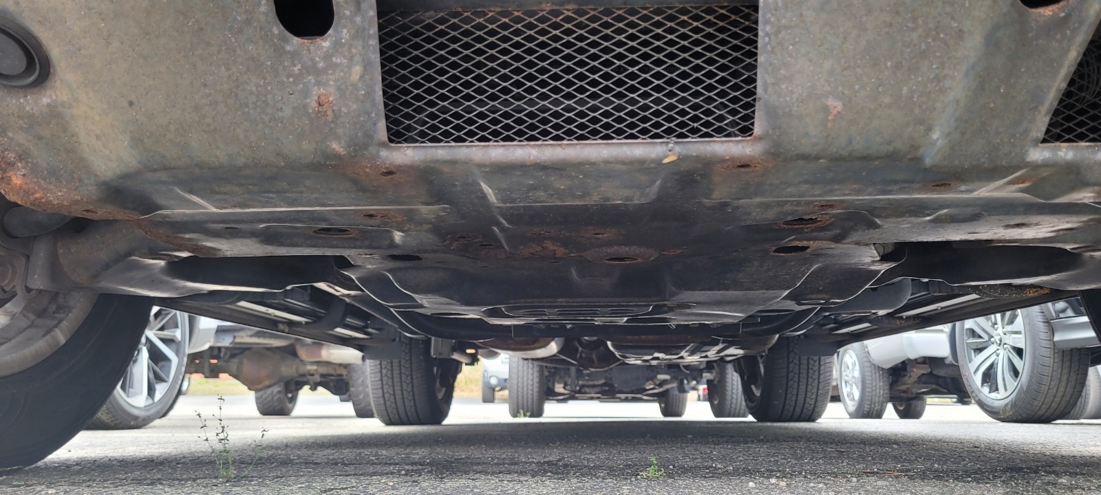

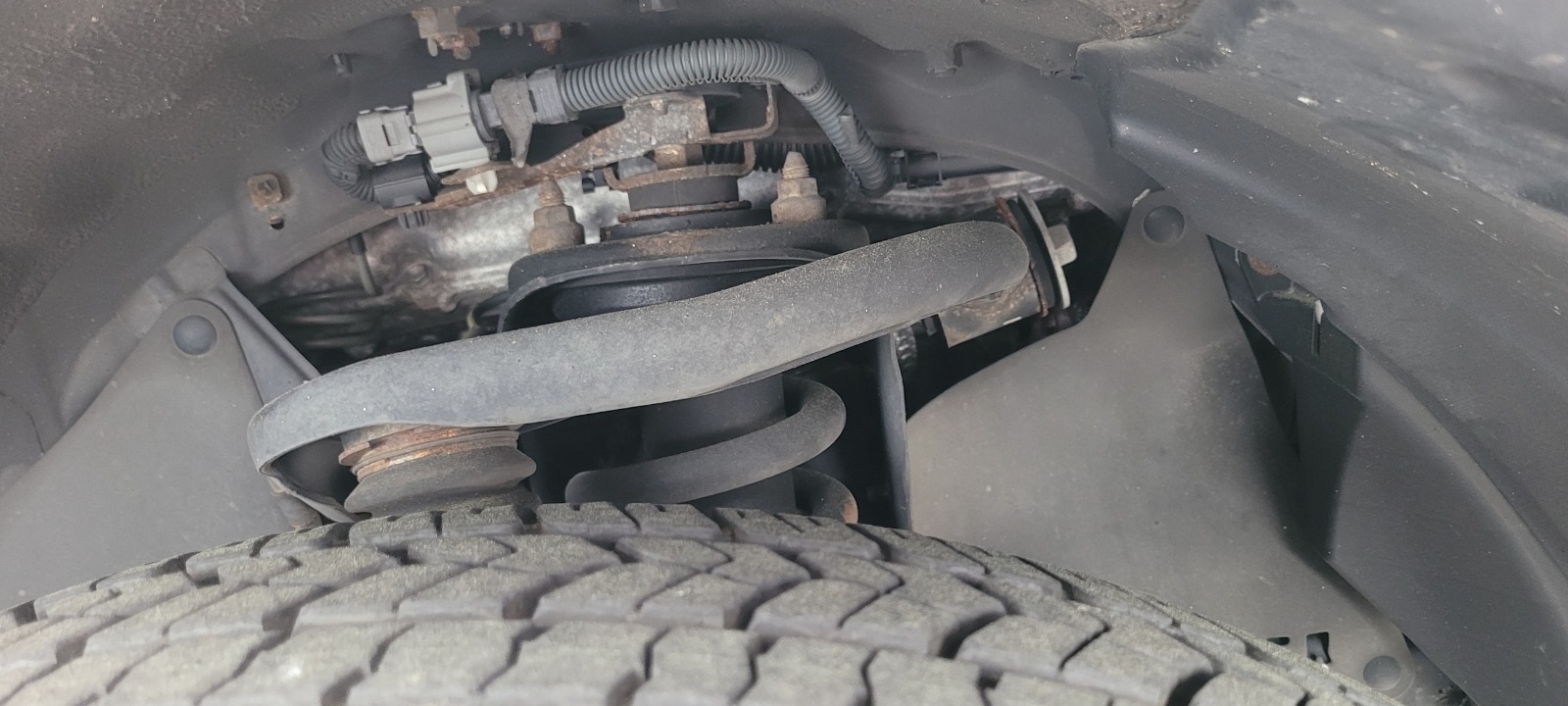

Hi, I'm thinking of buying a well priced (2-3K below KBB) low mileage 2010 GX460 that was in Maryland for its life. I'm from the south, so we don't have much rust here. Is this a reasonable amount of rust? Would it scare you off? Would it need treatment, and if yes, how so?
Thanks for your help in advance, I'm just ignorant to this sort of thing.

Rust on the frame is a bit concerning - I'd say it's worse than my 2007 470 was. I'd suggest looking inside the frame everywhere (peeking with a flash light or a inspection camera), but focusing on the passenger frame rail behind the front tire (where it dips down). The AC drip line discharges onto the frame there and it can really rot from the inside out. The rear frame crossmember behind the rear axle can also collect a lot of gunk and rust out as well.
If the inside of the frame is fine and the rest of the GX is in good shape otherwise I'd have no issues getting it. But you'll need to undercoat the frame inside and out ASAP to stop the rust, will probably break some smaller bolts (like skid plate bolts etc) when you wrench on it, and will need to keep up on undercoating for the rest of the vehicle's life. I like Fluid Film and Woolwax for undercoating as they are super-easy to DIY apply and self heal.
Being from MO where we have some rust, regular undercoating and dealing with broken bolts is NBD to me, but it can be a big deal to some.
From what your photos show, I personally would not have a problem with it.
My rule of thumb for rust is:
If you take a wire brush to it and get shinny metal easily with a few strokes, I'm good with that.
If you take a wire brush to it and start removing rust with more and more of the rusted metal getting thinner as you brush. RUN AWAY!!!
Never worry about surface rust, UNLESS it starts pitting the surface and you can't return the surface to a smooth/original finish again without removing material.
Hope you understand how I'm describing this.
...Being from MO where we have some rust, regular undercoating and dealing with broken bolts is NBD to me, but it can be a big deal to some.
Mad props to people like you. It takes patience, and/or $$$ specialty tools (induction heaters, etc) to deal with rusted bolts and such if YOU do your own work. My 80 series was from MD, and I swear, never again. If you plan on paying someone else to do all your work, then shop rates don't discriminate. I still mostly work on my own junk, so personally won't deal with rust. I'm already slow, and rust is just a "PITA force multiplier" for every job.
If you're even remotely concerned about structural integrity on a rig you're gonna beat the s#!t out of, that's an automatic hard pass.
I'd say that's a bit of an over-statement. I've dealt with broken skidplate bolts - just drilled them out and re-tapped to the next larger M8x1.25 size. A few other bolts have required 30 minutes of welding here and there (from a $200 HF welder), and I had to rebuild a Y pipe exhaust flange, but again no big deal either. At this point I've replaced pretty much the entire suspension and exhaust in my GX (not because of rust), so I've been through of all of it. There is a big difference between a total rust bucket (which will require the induction heater - watch the Speed Academy YouTube channel for some examples) and something where it requires a bit more work than a rust-free vehicle.
Regarding structural integrity - just being honest - I do not agree at all. Surface rust does not affect structural integrity, or ever bridge in the USA would be closed :). Holes in the frame, major rust on the inside, etc is a different story. It's hard to tell the difference between the two without looking at the GX in person.
