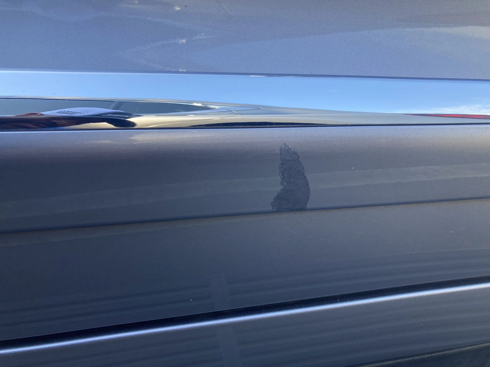

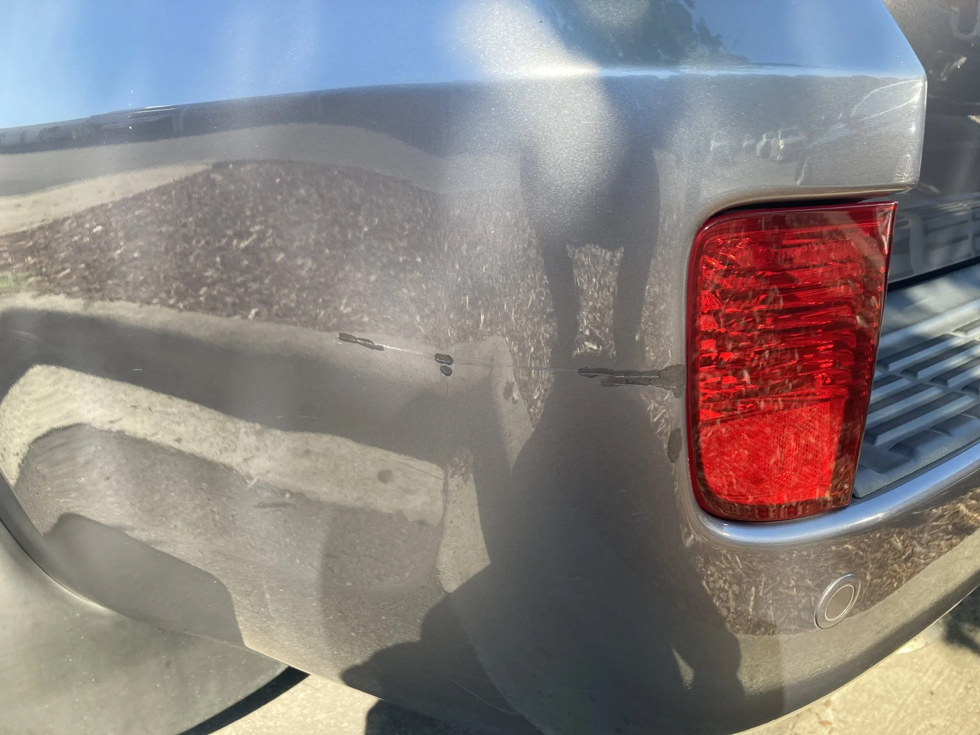

I got these pictures from shop who is painting my front bumper and touching up these two spots. This looks completely unacceptable doesn’t it? This is a professional collision repair shop. Looks like my 6 yr old could do better than this - do I have unrealistic expectations about touch up placement and color matching?

I bet it looks fine from 10 feet away. Yes, I think you had unrealistic expectations. You can’t blend spot touch ups. Maybe he thought it was an off roader?
It looks like your 10 year old daughter used nail polish. I would not be happy with that, the color is wrong for starters.

That is not “professional” work in any way.
I would not be satisfied with that. They should have touched up one spot and instantly realize they have the wrong color and stop there.

Touch up color beside, the work is not good. I bet they were thinking they are doing it for free.
A professional touch up should include cleaning the defect area, filling in the scratch, not going over the edges, applying clear coat, sanding and buffing so only the color is somehow different. I can do all that so I know how it should look like.
