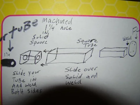

something like this good luck ... have a piece of solid square stock and have it machined to fit over your 1 1/4 piece of dl
That's a good idea. Thanks!
As these things go, plans change (late last night while having a few beers and sitting int he garage staring at all the different driveline parts I had laying around). I was looking at the slip section on the D18 and that of my stock DL. I noticed that with a little grinding and some time, I could mate the two sections together and have plenty of meat to get a good weld on. Only thing I need now is a sleeve for the Cruiser's front DL since I have to cut it down to abut half the size. It won't be pretty, but it will work and compared to the 3" slip or so on the stock DL, I will have about 5 with the Dana DL top section.
If this doesn't hold up to the abuse, I'll give the solid chuck with a hole drilled in it a try.
