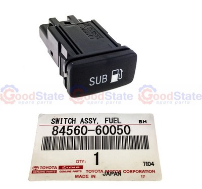

I don't know. Maybe poke around on PartsSouq - if there is one, you'll find it there. One thing is that (at least on the one I have) the shutoff timer is built into the LRA supplied switch.
I googled this, not sure if it would fit.

I’m aware of the shutoff time. I’m comfortable with form over function. I’ve been using a factory sub tank switch in my 80 series for years and can hear the difference in pump sound when the pump starts to go dry. Thanks for the idea.

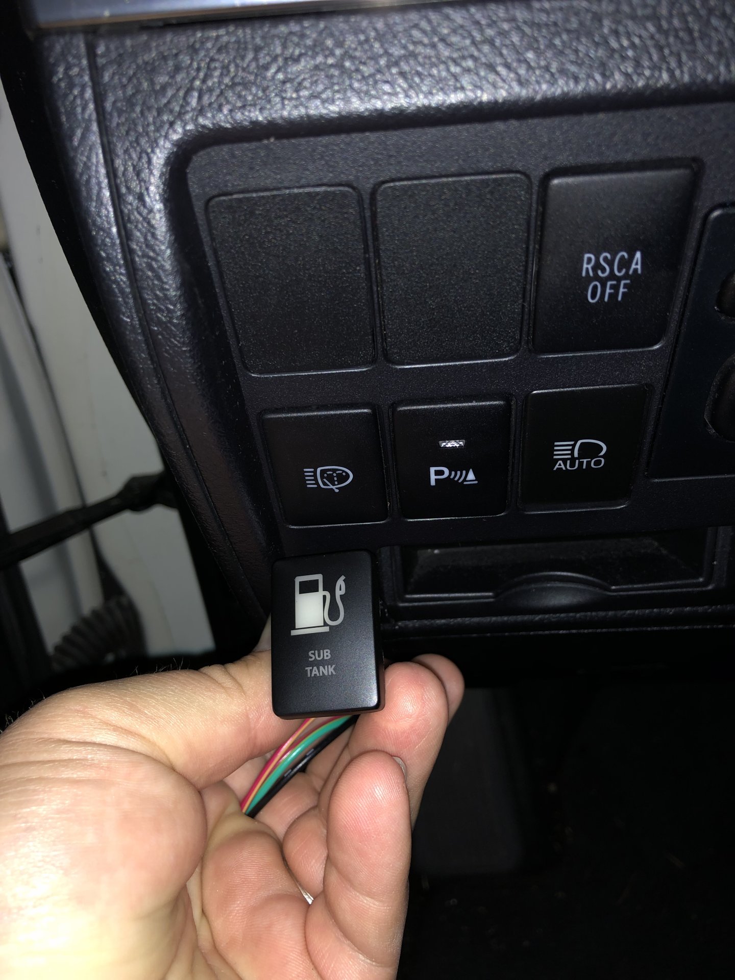

Ch4x4 was the answer. STEDI didn’t have anything good enough.
I think it’s an excellent match. Color looks different because of the angle… I think… good enough. Pretty quick turn around. About 8 days from the order to arriving in my mail box for a custom switch. $29.98 delivered as well.
Thank y’all for the help.
This one is supposed to match. I think that the angle I was holding it at to take the picture made it look more off color then it actually is. Time will tell. I’ll check out air on board though.
