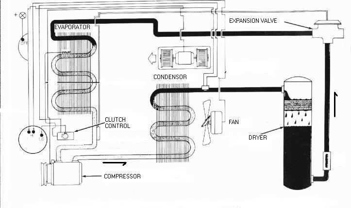

The line exiting the compressor should be hot not cold. Low pressure gas gets compressed and the compression heats it into a high pressure gas. High pressure gas condenses into high pressure liquid. Expansion valve allows the pressure to drop. The expanding liquid evaporates and cools as it does so. Rinse, wash, repeat. As a side note, you can see from the diagram why overfilling the system with freon does no good at all. Cooling capacity is based upon volumetric flow of the compressor and side of the heat exchangers.
I'm assuming you mean the line returning to the compressor from the evaporator. That still shouldn't be 'very cold'. Cool maybe. The only point in the system that should be 'very cold' is downstream of the expansion valve through the evaporator. Leaving the evap it should have picked up energy from the cabin and warmed back up into a low pressure gas.
