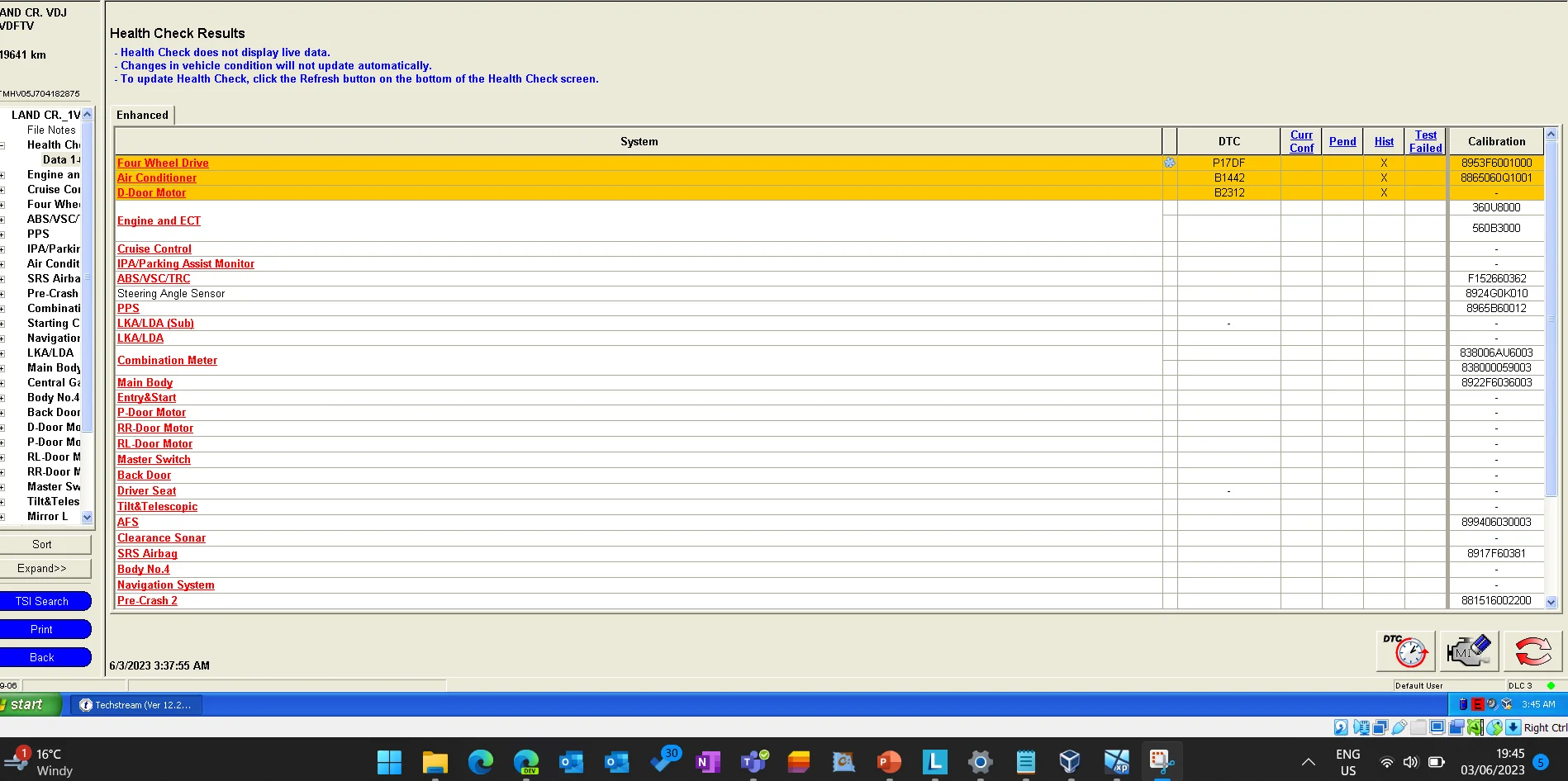

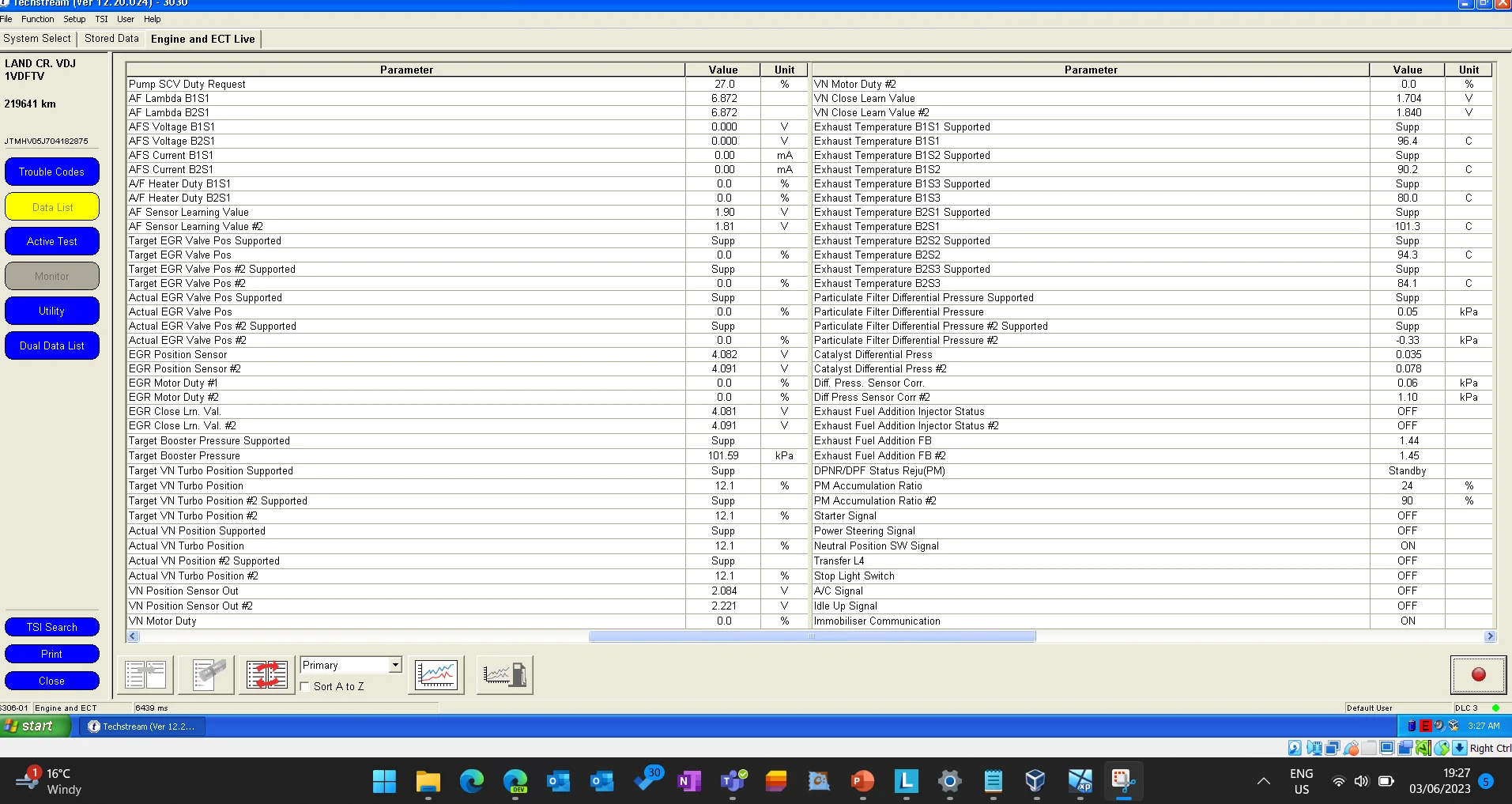

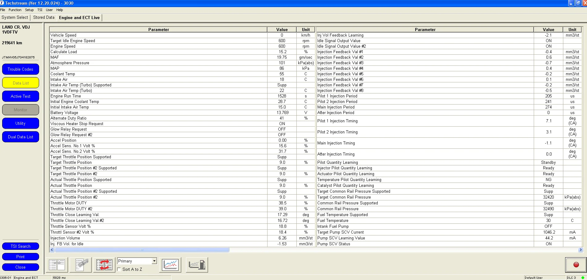

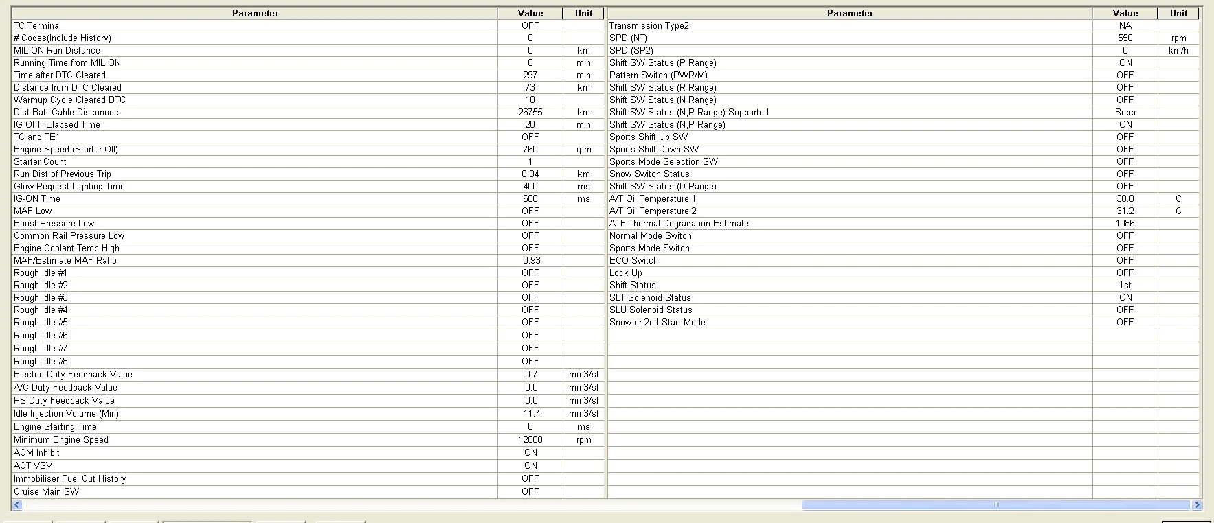

Hi everyone, I recently upgraded from a 100 series to a 2015 diesel 200 series. I warmed the engine up and plugged in techstream with the following values. I'd really apricate it if anyone can let me know if these values are ok? I understand the injector feedback should be +/- 3.
