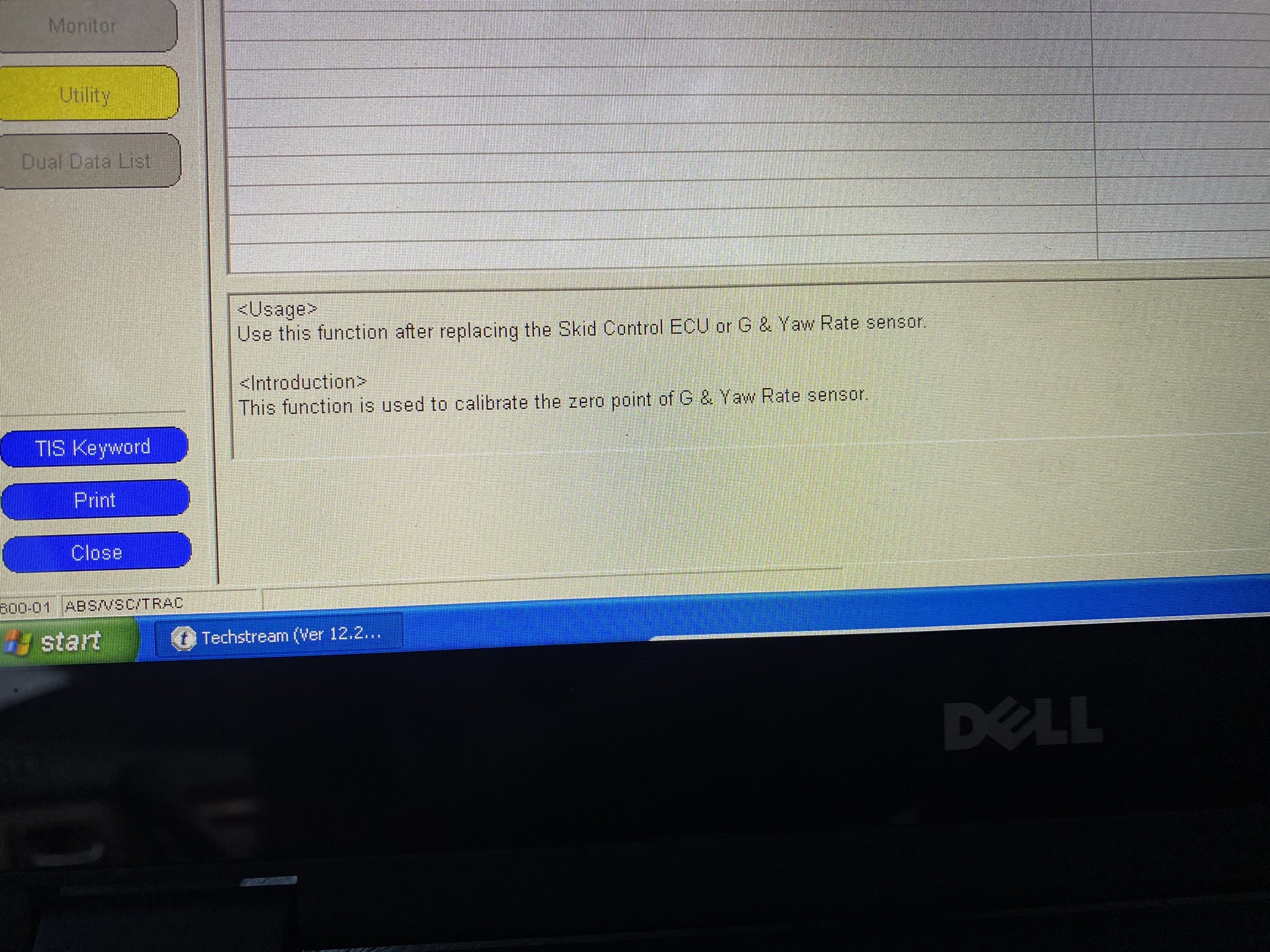

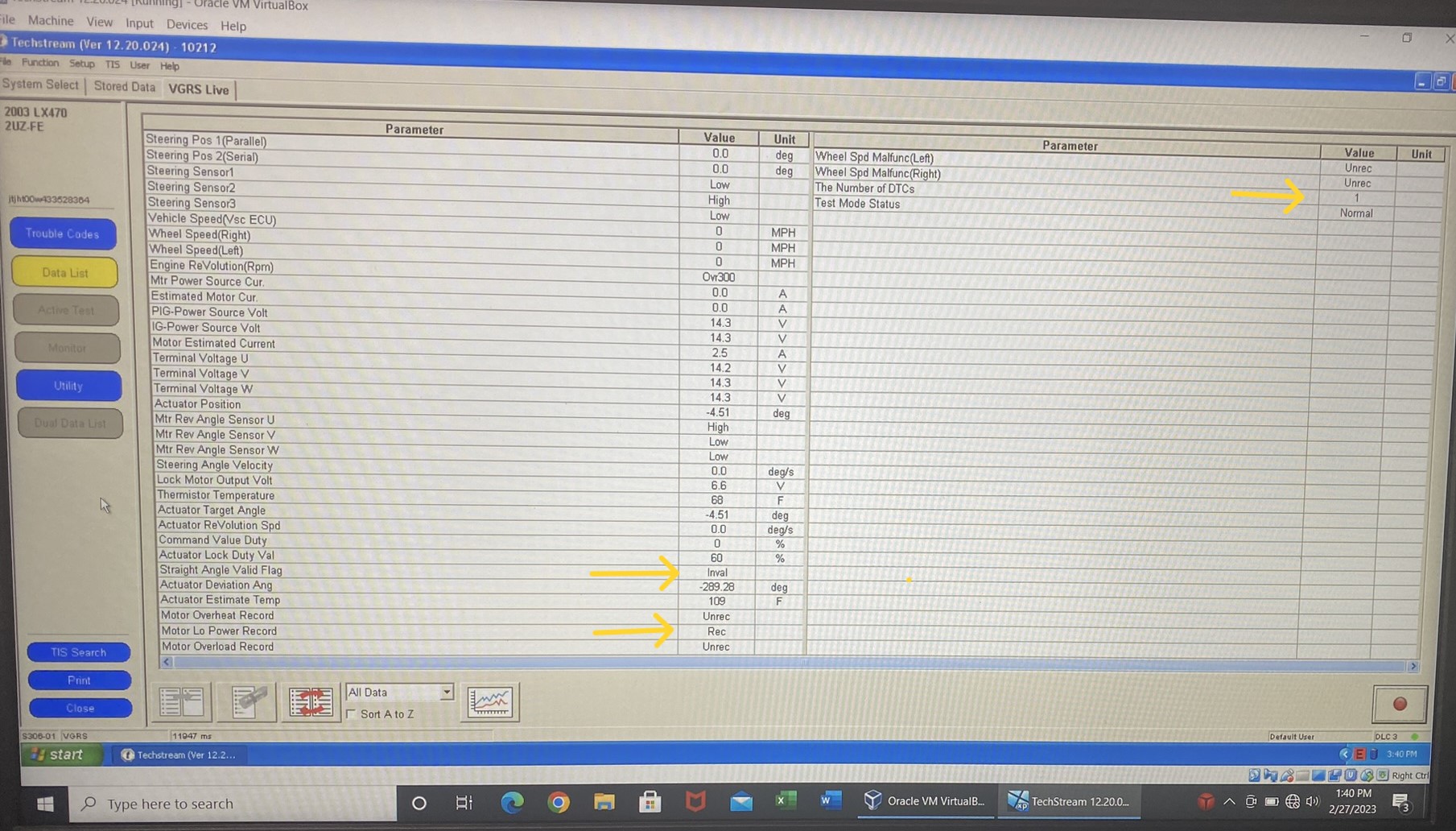

ZPC, ABS:

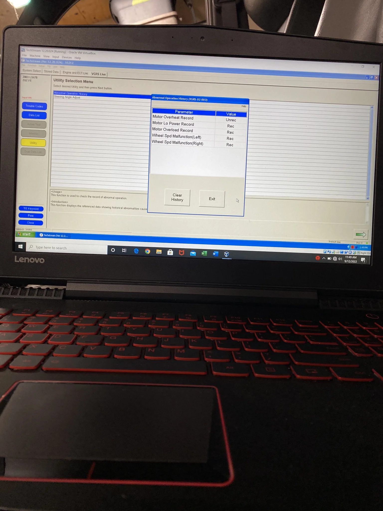

Not only must zero point calibration (ABS), not be undone (we get a DTC (AKA code) when undone), it should be calibrated. All DTC's, need to be cleared. In addition all Flags in VGRS history need to be cleared.
Then calibrator and center in tech stream, as normal.

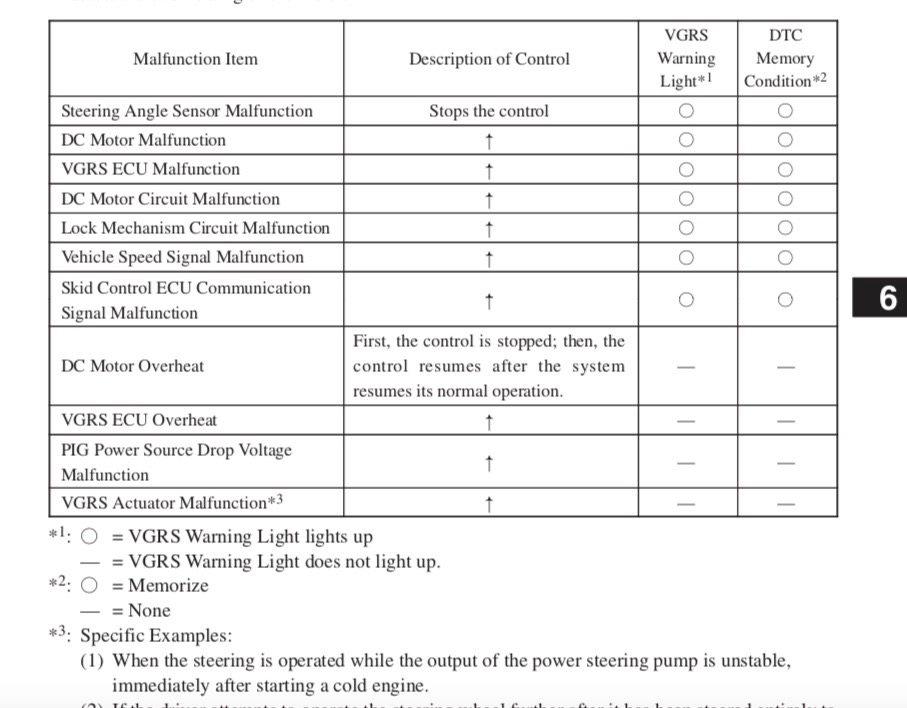

VGRS actuator may have damaged during R&P removal. Unfortunately, many shop pound in direction of steering wheel, to remove union of intermediate shaft from pinion. Lexus has TSB, in it's snap ring recall TSB, warning to not do this. If actuator damaged, it is in failsafe now. Test is while idling and stopped in park. Turn steering wheel lock to lock. If VRGS working, we get ~2 1/3 turns. Not working we get closer to 3+ turns of steering wheel. like 98-02 LX or land cruiser.
There is the normal calibration & centering of steering wheel done with tech stream during alignment. There's also, a longer calibration. This is usually only needed, if VRGS CPU replaced. But in your case I'd do it also, above clearing and centering of steering, if it fails to correct issue. You'll find it deep in the Snap ring TSB I attached. It involves starting and stopping engine and turning steering wheel 15 times on level ground.
