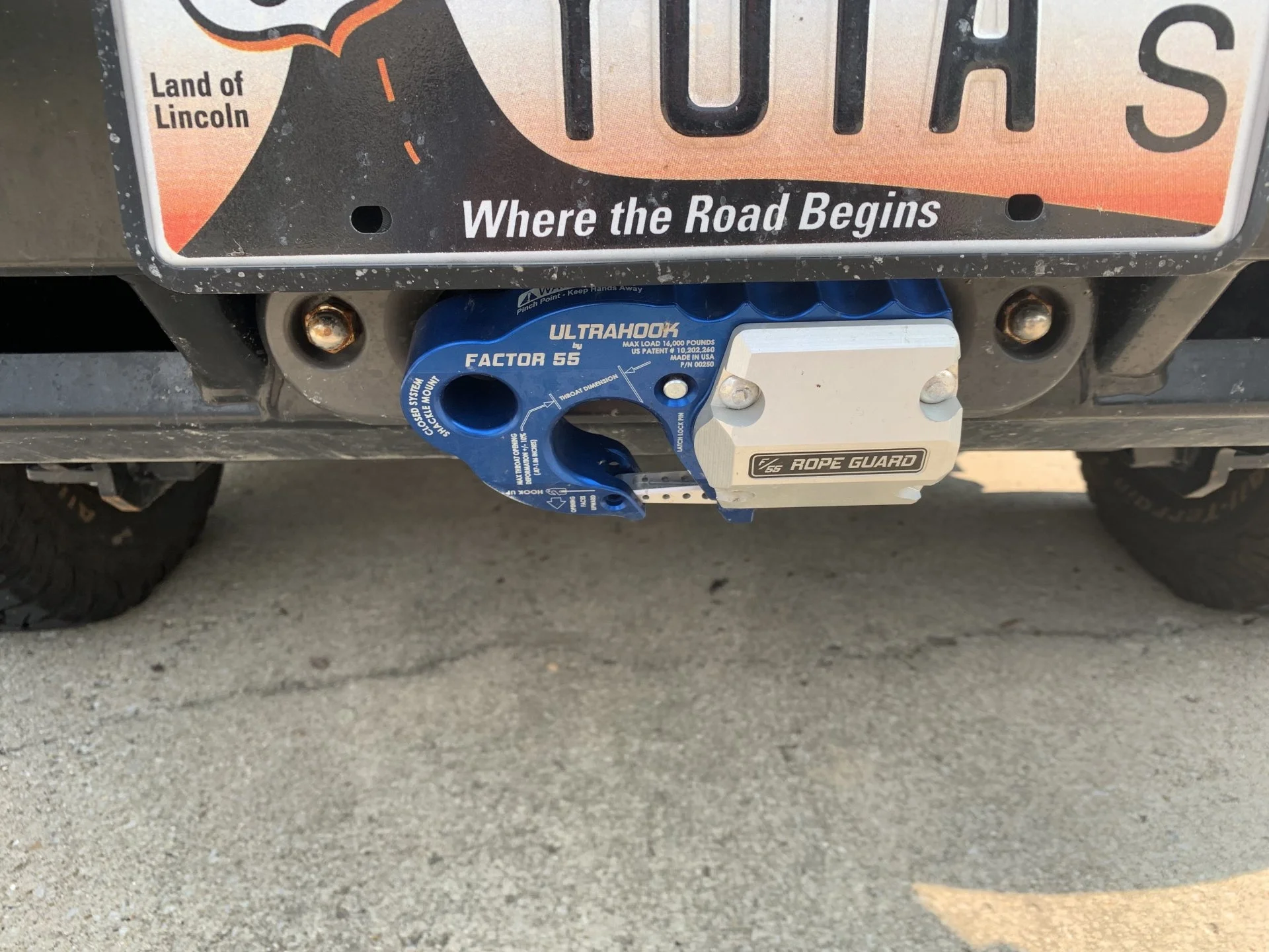

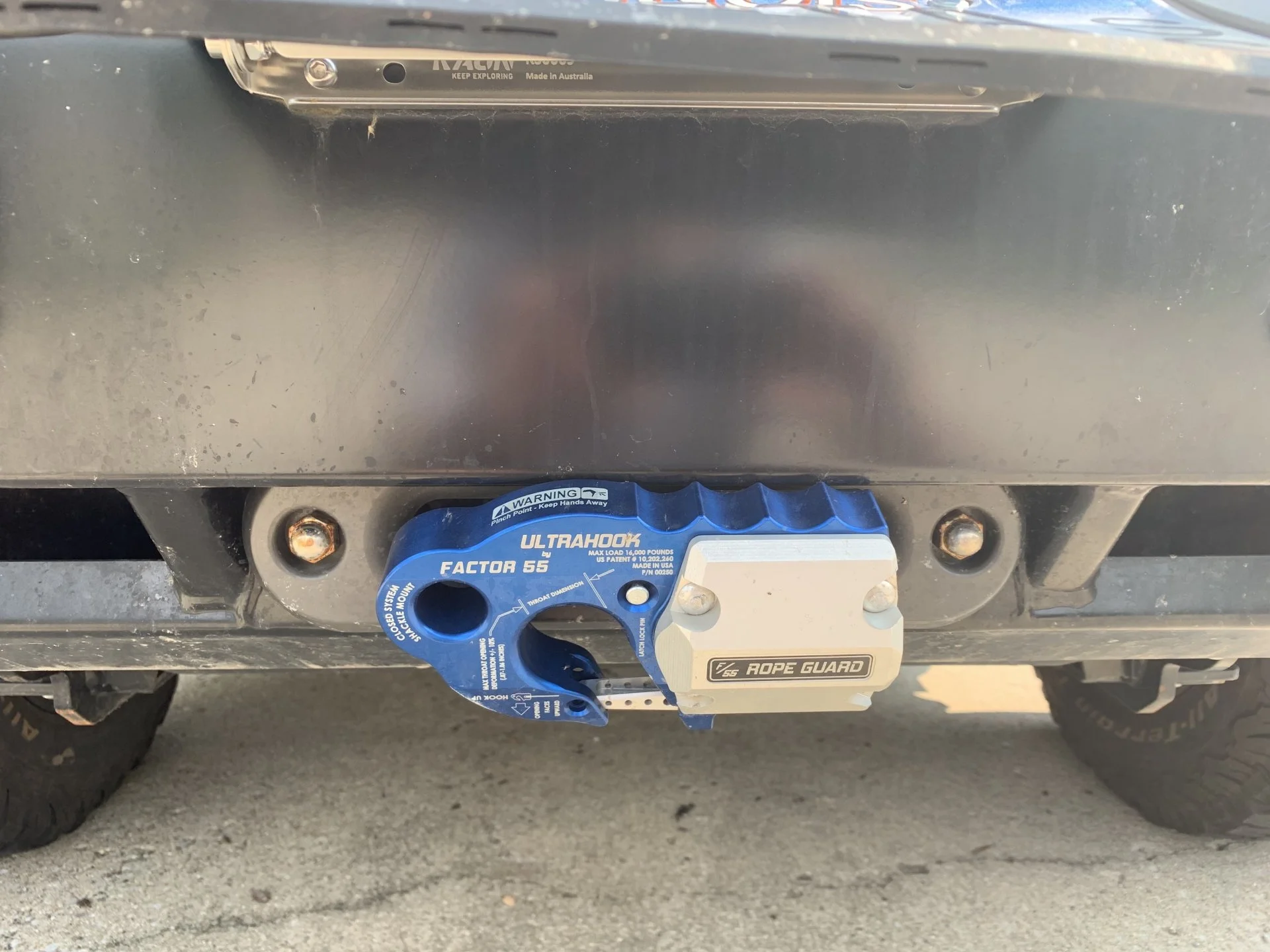

Here is what I did with mine. I have the Factor 55 fairlead and hook on mine. I had to use the thiner of the two fairleads. The rubber bumpers on the hook sit against the bumper and bottom of the fairlead. I have been happy with it so far.
View attachment 2739398View attachment 2739399

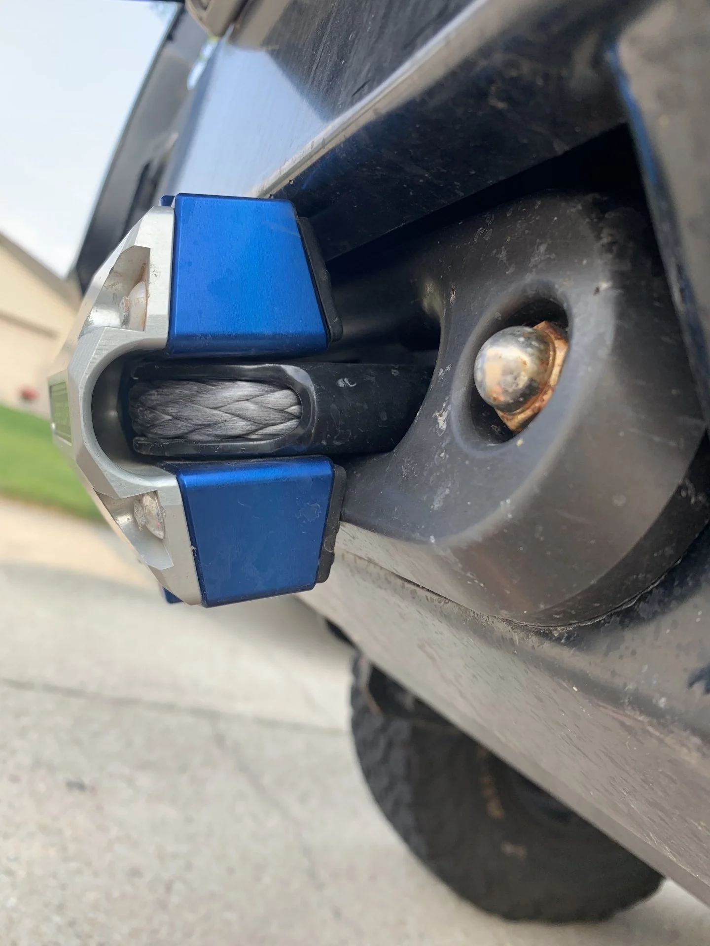

How thick/deep is that fairlead? I'm using Slee's which is 1" thick. It almost seems like yours is about 2" since it's coming out further. Below are some pics showing my issue.
The Factor 55 fairlead that I used is 1"x12.35"x3.25". The 1.5" fairlead was too thick for this bumper. Here is a picture that might show how my hook fits. I have my license plate on a fold-up bracket also.
I see. Makes sense now. Thank you for the picture. It looked flush from the other pictures.
Not perfect, but it works for me. I need to clean my bumper. Not going to happen until I get back from LCDC however. I am sure there will be a lot of new bugs added after the 2600 mi round trip.
