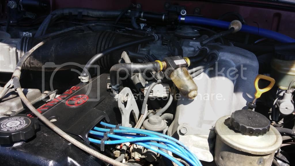

you cant disconnect the hose all together. its part of the vacuum lines. whats common though is adding an inline catch can. mine is for an air compressor to catch moisture but I took all the screen filter out of the catch can so its just an open can with a line in and a line out at the top and the oil settles into the can and I just empty it when I change the oil.

the one on the left is also a vacuum line( I wouldn't think you could delete it) if you take the air intake hose off you can see into the throttle body. if you have quite a bit of oil in there you can add a catch can to it as well but I haven't seen any on my truck so I never did it.

You should fix the torn PCV hose, if it's leaking then you're losing vacuum and some responsiveness. While you're at it, add a oil catch can and you're engine will run better from less oil in the CC, effectively raises the octane. The air compressor filter menioned above is cheap and works but fills up too fast in my exp. Get a ebay one and just make sure it is sealed, I also put a brillo pad in mine to help trap oil. They go for about 20 bucks or so and will hold enough to last between oil changes. I also use tranny line for the hoses, they seem to last longer. You definitely don't want to delete the PCV system, the engine runs better with it. BTW the line without the filter in above pic is the clean side, no need for a filter, the hose is 1/2" and the dirty side is 3/8".
